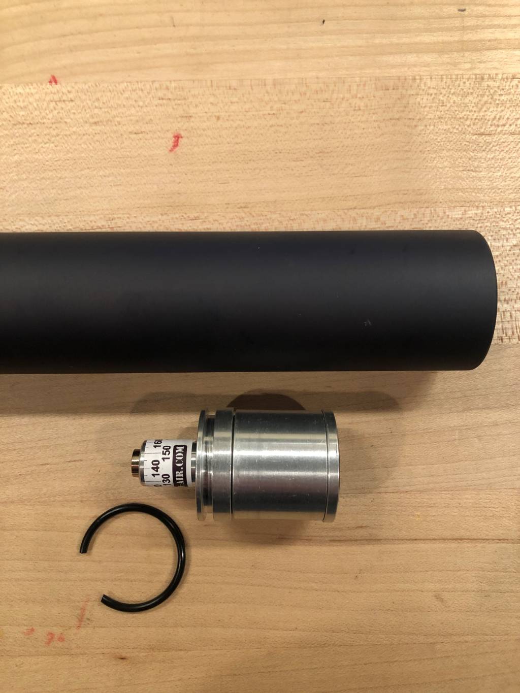

Out of the five that I've done, one of them was totally stuck, almost like it was loc tite on the tube. Make sure you remove the barrel, then put the breech in a vice (rubber or leather to protect the finish), and use another piece of sticky rubber like those kitchen jar removal type pieces to get a grip on the tube and turn it with both hands. If that doesn't work try using a hot air gun on the breech end for a few minutes to heat it up then try again... FYI, the air tube must be completely degassed or it certainly won't budge.
Mike
Mike - So I just got a Huma regulator for my "new" Renegade (.22 cal). Reading your great instructions, I believed I had installed correctly - see the photo for how the assembly looked prior to going into the pressure tube. However, as I was pressuring up the tube after install around 150 bars or so, I had a sudden release of air - not all but about 50 bars of pressure lost. So I degassed the system and found that the o-ring on the regulator body itself had ruptured and had wedged itself between the regulator and the pressure tube. Took a bit of work, but finally got the regulator out. Any thoughts as to what I did wrong? When I assembled it all I was sure not to pinch the o-rings. Just FYI - I used a bit of silicone grease as you and others had mentioned and I removed the two factory larger o-rings found on the valve body prior to assembly. Any help would be appreciated!
