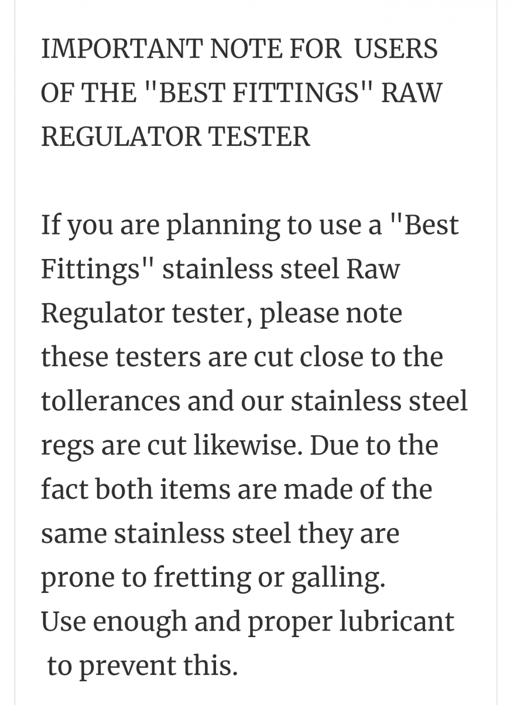

I ordered mine from a dealer here in the U.S.A., it came with no instructions and there is no instructions on the Huma website about installing them in a RAW. But if you go on the Huma website and look up the RAW regulator to order there, you have this...that I didn't know about until after the fact.
Oh ok didn't know sorry
I just wanted to put the blaim where it belonged. If I had ordered it from them on their website, I think I would have found this. If they had this info. in the package with the regulator, that may have helped. Either way I know now, the damage is done, any maybe this information will help someone else.
HUMA's response:
I’m sorry to hear about this. We actuall warn about this on the product page.
https://www.huma-air.com/Raw-HM1000-Tuning-Regulator-By-Huma-Air
Yes we have a body available for this price will be €50,- excl shipping, if you prefer us to do the exchange we are also happy to do so.
Let us know whichever way you prefer.
All the best
Team Huma-Air

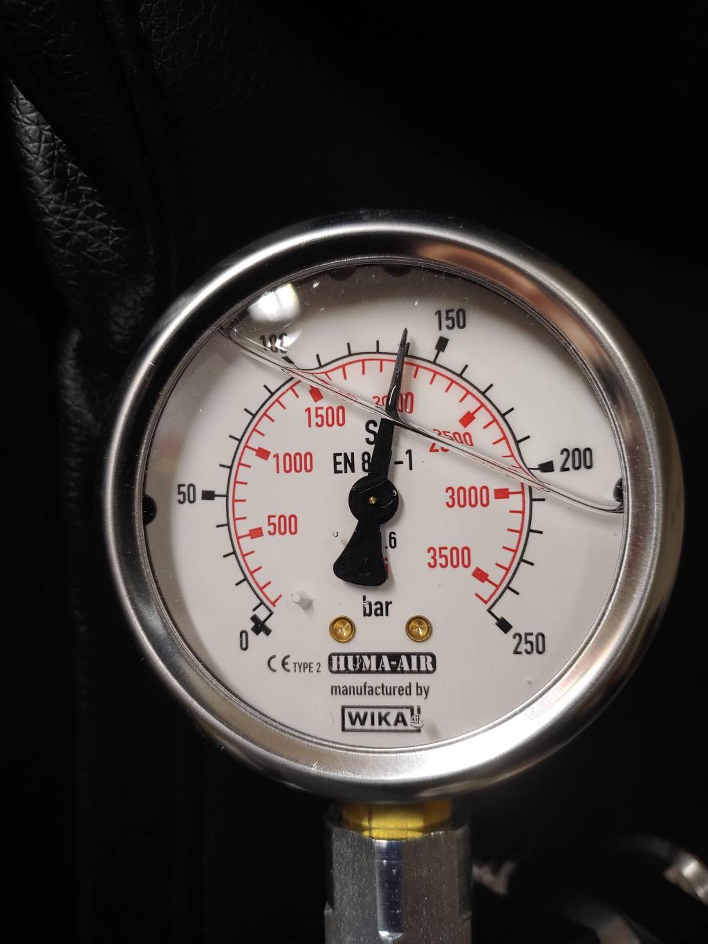

View attachment 190944This is what the RAW regular is set now just shy of 140 BAR. I was told it should be set 125-130 BAR. I'm pushing .177 13.4gr. @ 800fps. I turned the factory reg.up 1/4 turn from when I first bought it ,tuned to shoot 13.4@ 800fps. ,because it started shooting off and I couldn't turn the hammer spring in enough to achieve 800fps. So I bought a Huma and screwed it into my Bob's Tester by hand to see what it was set to and adjust it and it screws in easy all the way. When I tried unscrewing it...it started getting hard to turn, finally got it out. Tried to install it in my RAW and Huma threads are F***ed up.SO...putting in my factory RAW regulator. I have been told to take out the hammer and spring clean and lube them , maybe that was the issue I was having, not sure.
Were did you get a tester that can adjust the huma raw regulator?
View attachment 190944Questo è il valore impostato ora dal RAW normale, poco meno di 140 BAR. Mi è stato detto che dovrebbe essere impostato a 125-130 BAR. Sto spingendo .177 13,4gr. @800fps. Ho aumentato la registrazione di fabbrica di 1/4 di giro rispetto a quando l'ho acquistata per la prima volta, regolata per scattare a 13,4 a 800 fps. ,perché ha iniziato a sparare e non sono riuscito a girare la molla del martello abbastanza per raggiungere 800 fps. Così ho comprato un Huma e l'ho avvitato a mano nel tester del mio Bob per vedere su cosa era impostato e regolarlo e si avvita facilmente fino in fondo. Quando ho provato a svitarlo... ha iniziato a diventare difficile da girare, finalmente l'ho tirato fuori. Ho provato a installarlo nel mio RAW e i thread Huma sono incasinati, quindi... ho inserito il mio regolatore RAW di fabbrica. Mi è stato detto di togliere il martello, pulire le molle e lubrificarle, forse era quello il problema che stavo riscontrando, non ne sono sicuro.
There are two huma regs for raw .One for hm e one for hmx .Have different threads.
