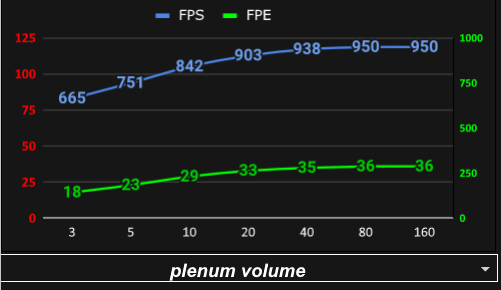

Various plenum volumes ranging from 3cc to 160cc, no gains once you hit around 80 cc, and a large diminishing return after 40cc.
This is with a stock .22 cal marauder shooting 18.1gr @ a 2100 psi regulated set point.
Certainly can see where sub 20cc would hinder performance, and sub 10cc much more so.
What's a plenum? Seriously. I've always heard this word, but never fully understood what it is or what it does. Thanks.
it is the volume of the air pocket that has went through the regulator and is waiting for the valve to open to push the pellet out the barrel , and when the pressure drops in that given space from firing a shot the regulator opens and replenishes that pocket of air with "hopefully the same pressure " each time you take a shot ! too much plenum and your reg may not cycle consistently per shot , not enough plenum and a lack of power ,
Ahhh good graph. Thank you
Okay thank you. That clarifies it well
