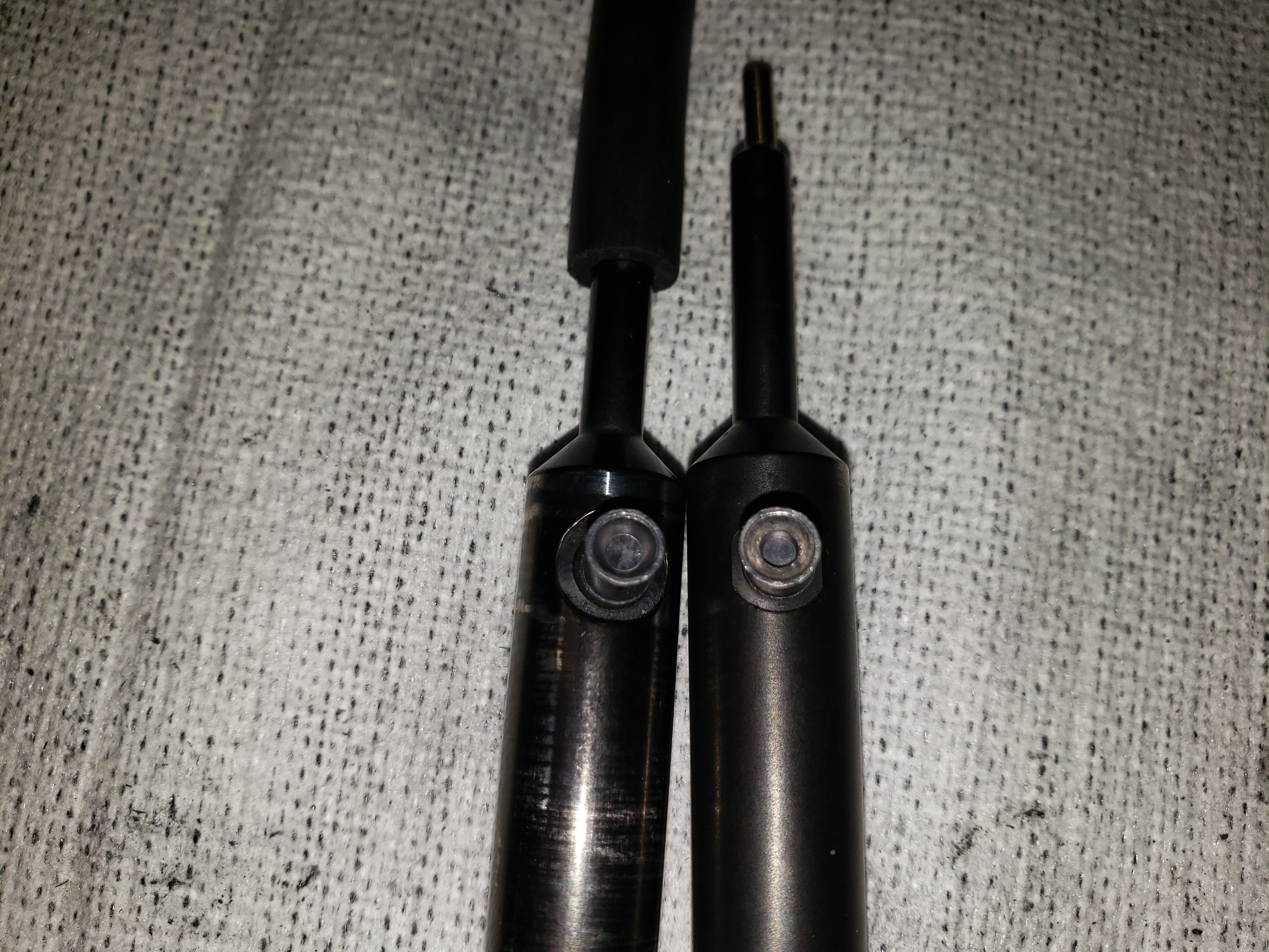

Well, gun back together! Regulator rebuilt and still operating at a Standard Deviation of 2. My inquiry of this topic was started by some inaccuracy issues that were unusual for my gun. Well, I found why the issue. Remembered I opened a new sleeve of .177 JSB Monsters(original). AND, they changed the skirt well design!🤬 that explains it. Loading bolt probe tip larger than the deep/narrow skirt well of the pellet. So now, the loading probe tip isn't pushing squarely into a flat surface on the bottom of the pellet. Thanks JSB. The old style pellet on the left.
