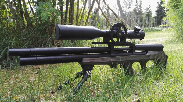

Ps. here she is <3

Hi Marcuz, first let me say thank you for believing my claims about the Huma regulators and for having the confidence to do it yourself. Your Wildcat looks so beautiful with her gray laminate stock! Your success story makes me feel very happy because I am the one telling everyone to install a Huma regulator in their air rifles and so I feel responsible and hope it works out well with no problems. Your results are fantastic!
All the best, Chuck
