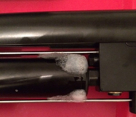

Damn! I've got another leak.
5 bar per hour... :(
I didn't change the O-ring, do you guys think it's mandatory?
