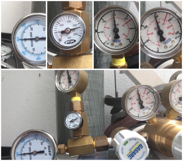

First off let me say that I enjoy reading your posts. Very informative. I really have learned a lot in a short time by reading post such as yours and others who have truely mastered their craft. I have a quick question. Have you had a chance to check accuracy of the Huma and Willa gauges now that you have the reg tester? I’m going crazy with the horribly inaccurate FX gauges on my Impact. The two gauges I mention are what I’m looking at as possible replacements. Not really interested in the expensive digital gauges from Edgun

Some Pressure Gauge test on Wika, FX, and Acutek (Chinese Brand) using GASARC Regulator.
WIKA are consistent. Acutek off some BAR. FX off more than 10BAR at 200BAR.
