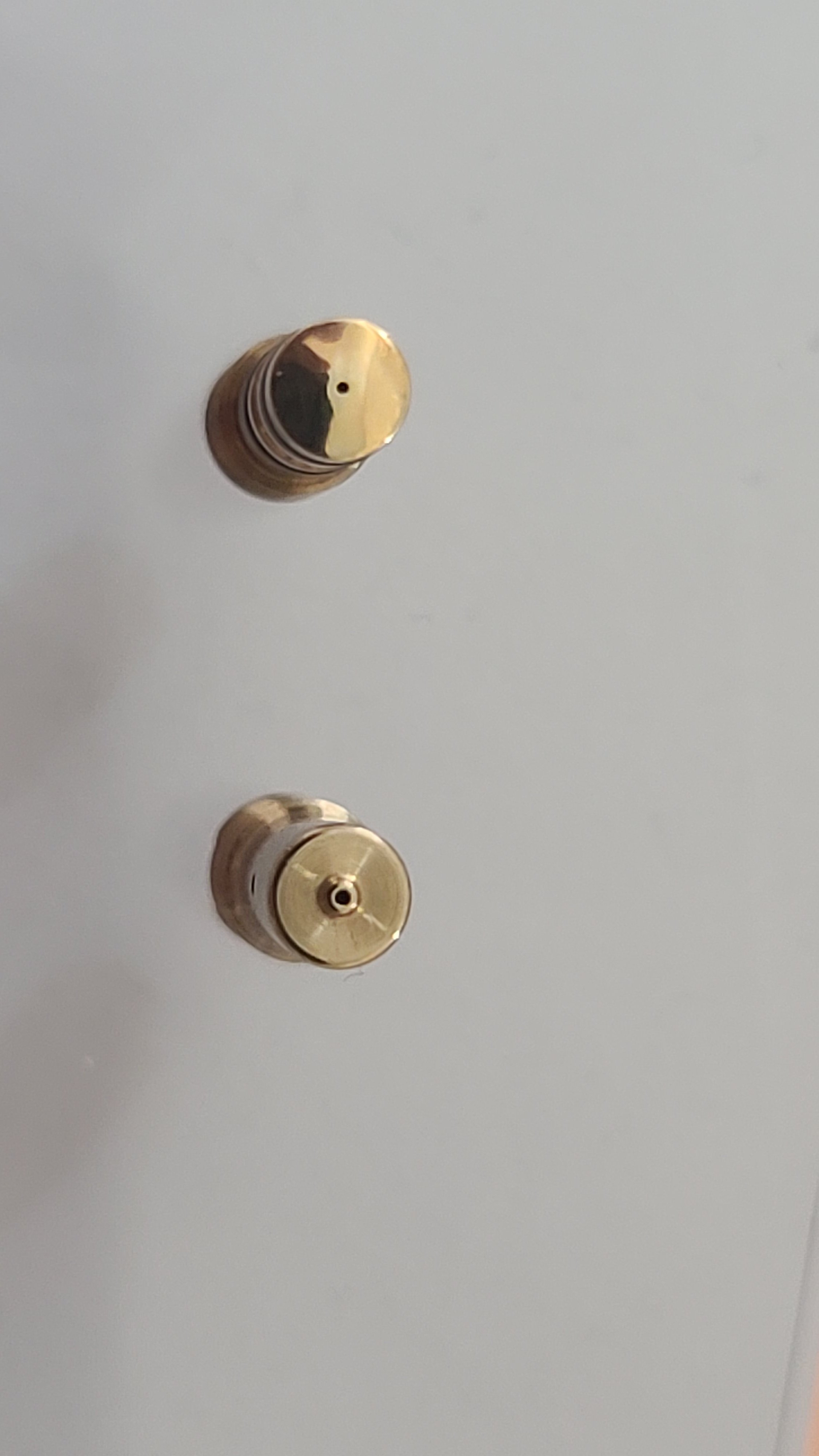

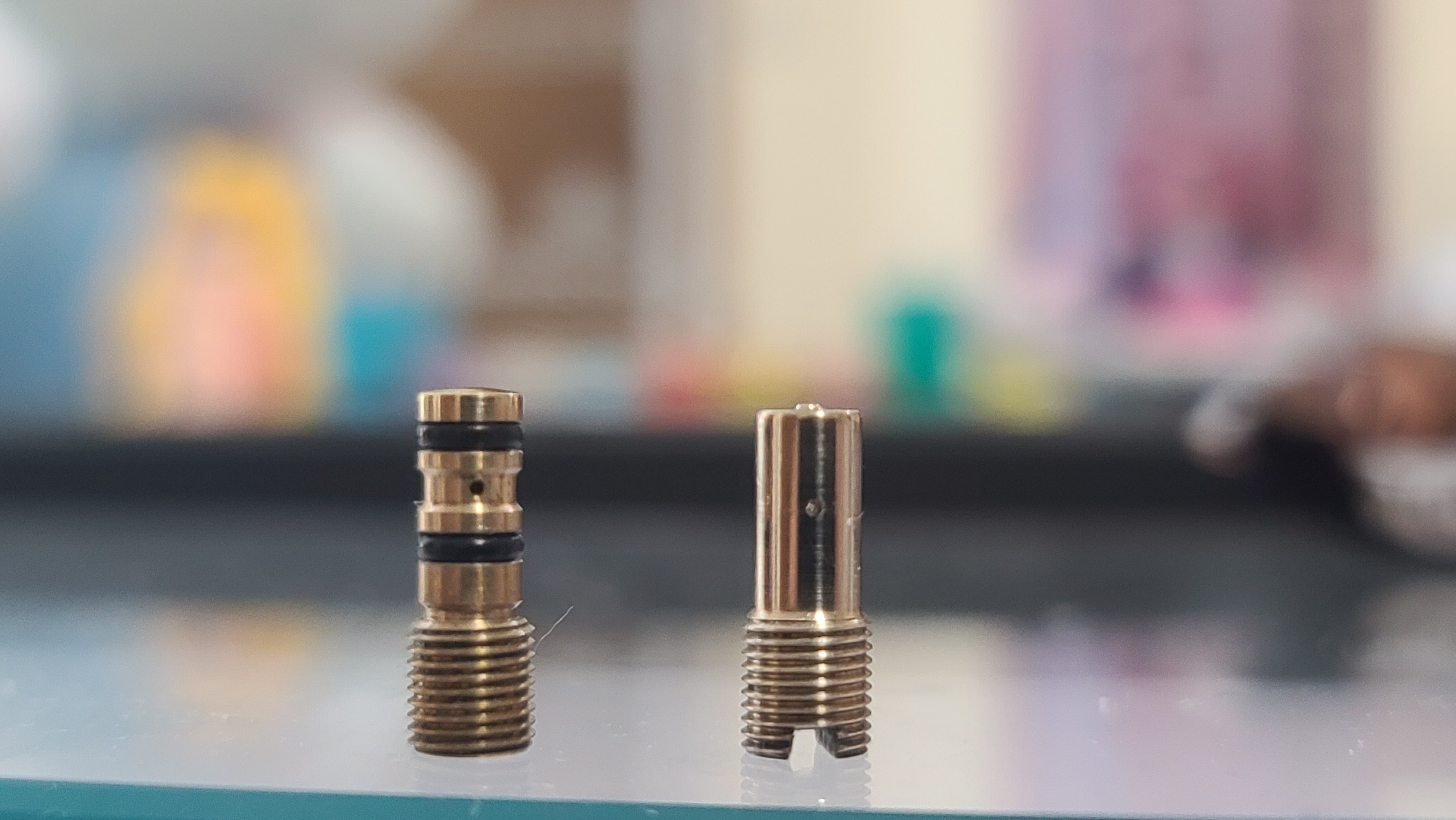

First pic, top is fx amp bottom is huma. 2nd pic left is fx amp right is huma. I notice fx amp adjustment screw is smooth dome shape, while huma is flat with a nipple shape in the middle. Also air flow hole on huma is a bit larger. Maybe explain the quicker refill.
Yes the bigger feed hole = faster fill. Some guys here have argued that smaller is better, to which I hard disagree.
