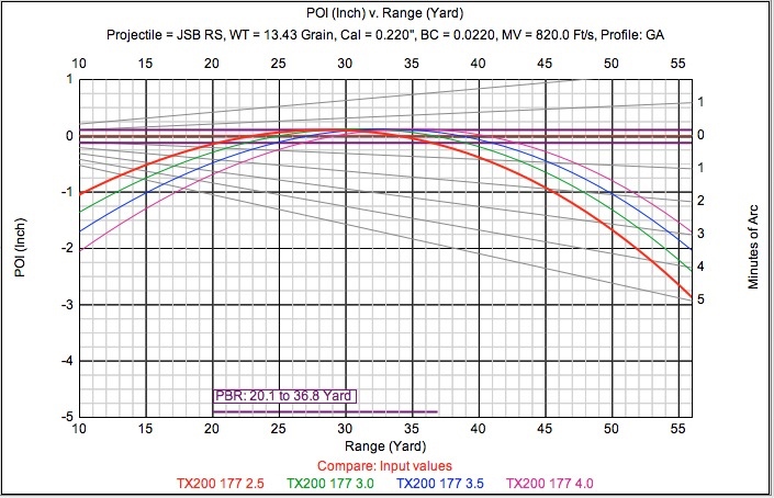

Also, a trick that the WFTF shooters use it to raise the scope height. Flattens out the far dope (where ranging is tougher) and increases the dope on the near shots (where ranging is easier). If you watch videos of European FT shooters, they typically have a tall scope riser because their shoots tend to have more long shots and their kill zones for the short targets aren't as small as ours.
Question: does raising the optic also adjust the zero distance, in order to zero at the top of the arc? I've always mounted my optics with the shortest rings that will work with my optic/gun combo.
Not unless you take it to extremes. The shot curve is still the same shape so the top is still zero. Basically you are moving the curve closer for the close targets and moving the curve out for the far targets. That's just for visualization purposes, changes to the scope don't have any effect on the shot curve, just our perception of it. Otherwise you could just remove the scope and the pellet would fly to infinity. Raising the scope by as much as an inch shouldn't change the zero distance.
Sorry for the confusion. Yes it's all about our perception of the curve. I was curious if that effects our perceived location of the top of the curve. I guess I could play with the concept with a ballistics calculator to see the effect of higher height over bore settings.

Scope height becomes more valuable with slower pellets amplified by poor ranging glass.
UTG at 45-55 yds will be very similar, 50/55 indiscernible. You can knock out a half inch of POI ranging error with higher scopes.
You will pay for it with 9 moa (red) at 10yds vs. 19 moa (pink) at 10yds with higher scope.
Pick your poison. (title TX200 .177 in error)
