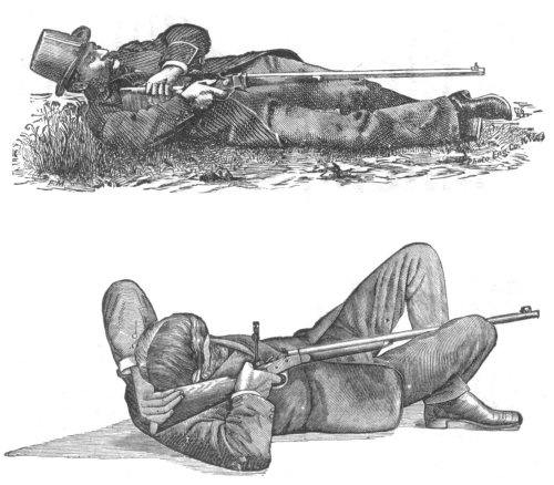

Interesting positions... Neither of which fit the rules of HFT, since the stock is resting on his shoulder which is directly touching the ground.
I think we need a definition of what "B........ Any part of the body directly supporting the gun may not rest on the ground......." really means. If "they" really enforced this, some positions currently allowed would be questionable as @Franklink mentions above.
I just decided to learn bucket and sticks vice speaking truth to power... Its not as solid as prone, but pretty close.

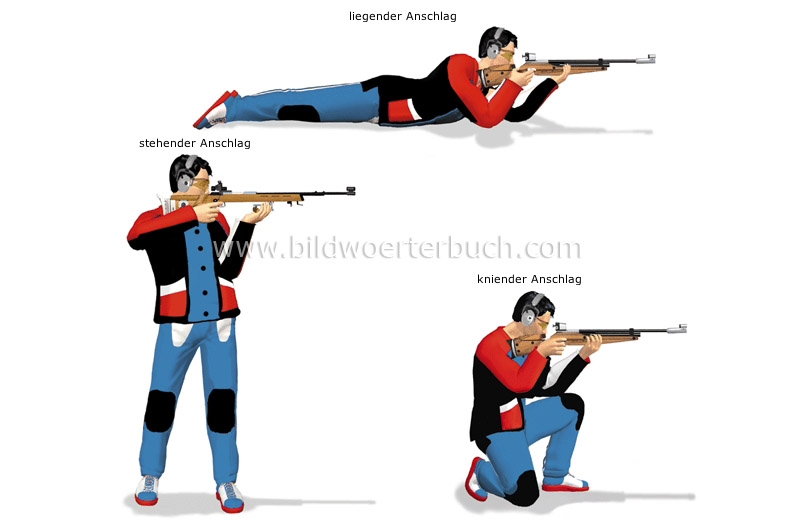

Those pics were for a chuckle. I was thinking of an olympian style prone, where the elbow is touchint the ground, the hand is supporting the rifle, the chest is lifted off the ground and the rules allow a two point sling. Any reason it would not be allowed?
Looks like the Olympian Style Prone would be allowed. No part of the body that touches the gun is touching the ground. So you'd be good to go IMHO.
