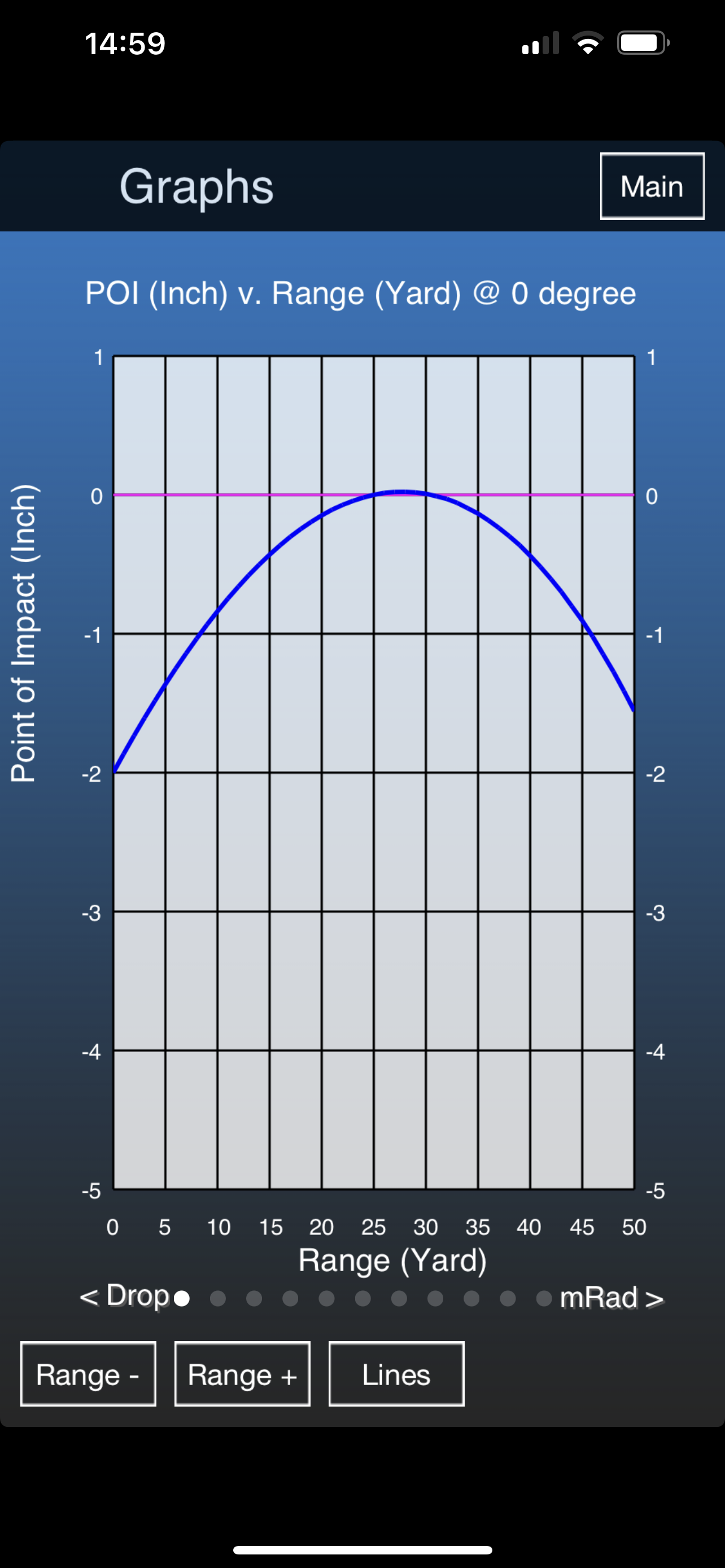

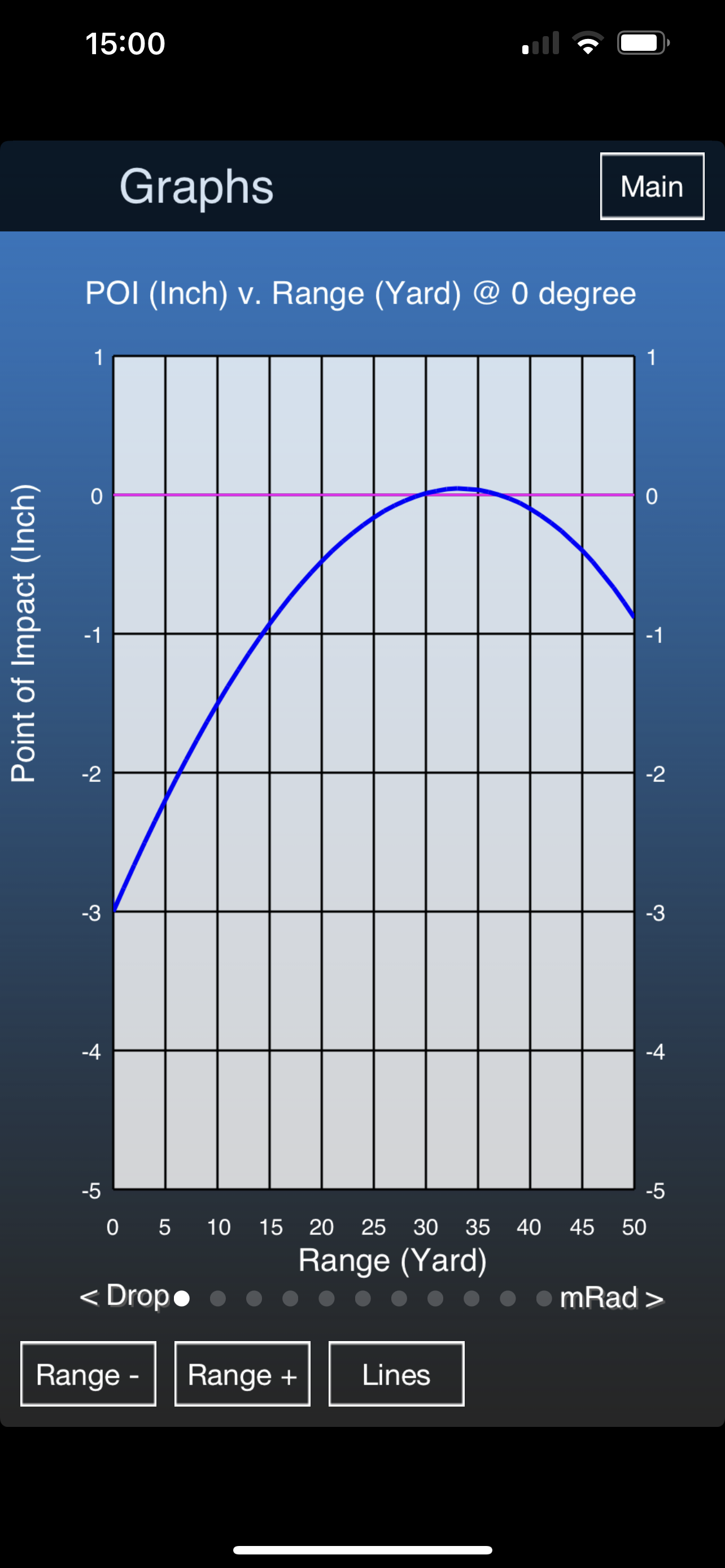

I didn’t see if you mentioned what your scope mount hight is or your zero distance but if you are struggling with the longer shots you could try higher mounts giving you a further zero and less change from say 35-55. Trade off is the ramp from 10-20 getting steep. Ranging 10,11,12,13 will be critical.
These images represent 20 ftlb with scope mounts of 2,3 and 4 inches.
If you look at the videos of European matches they run big risers to flatten the 12ftlb curve.
I do have high eagle vision mounts on my Brocock Sniper and my zero holdover runs to about 40. My gun is comfortable and accurate. I often do pretty well in our weekly old guy matches where I have home field advantage in range estimating. It is other venues where I struggle. Maybe it is just other things that shooting on an unfamiliar course brings out, such as being nervous, tired from travel, getting out of my shooting rhythm, not taking my time, etc.
