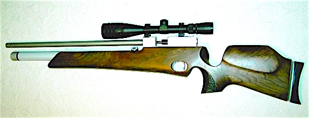

Knowing the cave man that owns that TM above I think he would have us all shooting sitting from the ground, without sticks, in a big red ant colony. I pretty sure I have nailed 2 of his preferences and the 3rd well, wouldn't surprise me."And with all that I’ve read and studied I cannot for the life of me understand what the hell the ultimate end game is."
These recurring FT debates that devolve into lobbying for this or that particular rule or change are usually driven by those feeling disadvantaged in some way or another; be it equipment, shooting position, or otherwise related. The loudest voices have often tried and failed to remedy their perceived disadvantage, so resort to lobbying for remedy. This often occurs after experiencing a recent (or repeated) butt-kicking(s). So the end game is most always to gain or regain advantage(s); and hard-sold as victimhood.
Consequently I'm occasionally compelled to put this BS into proper perspective by repeating something I've said many times before. "Everyone lobbies for rules that will advantage them, and lobbies against rules that don't/won't."
If it's any consolation, humans are not the only self-serving species. ALL species are. SELF-FIRSTedness has always been a natural fact of life; but usually related to survival and/or prospering... rather than prevailing in a little game.
FWIW, the reigning Hunter Class Texas State FT Champion used a box-stock front-focusing scope, does not employ bracketing (and never will), yet posted the high score of the weekend in not only Hunter Class, but all classes, in the most-contested Republic Of Texas FT Championship in history. Dang guy also shuns shooting aids, accessories, and gadgets like he's ALLERGIC.
Personally, I think he just got lucky. VERY!![]()
