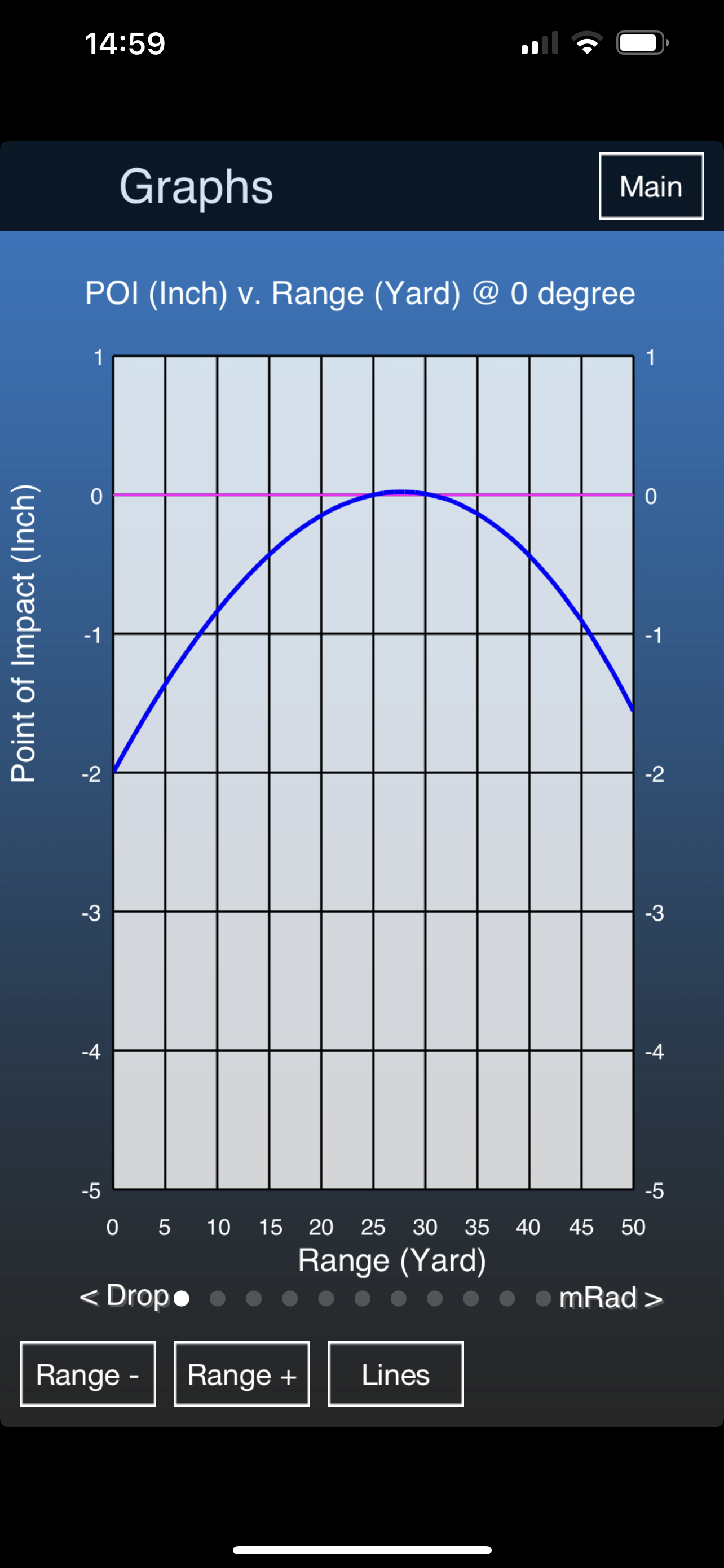

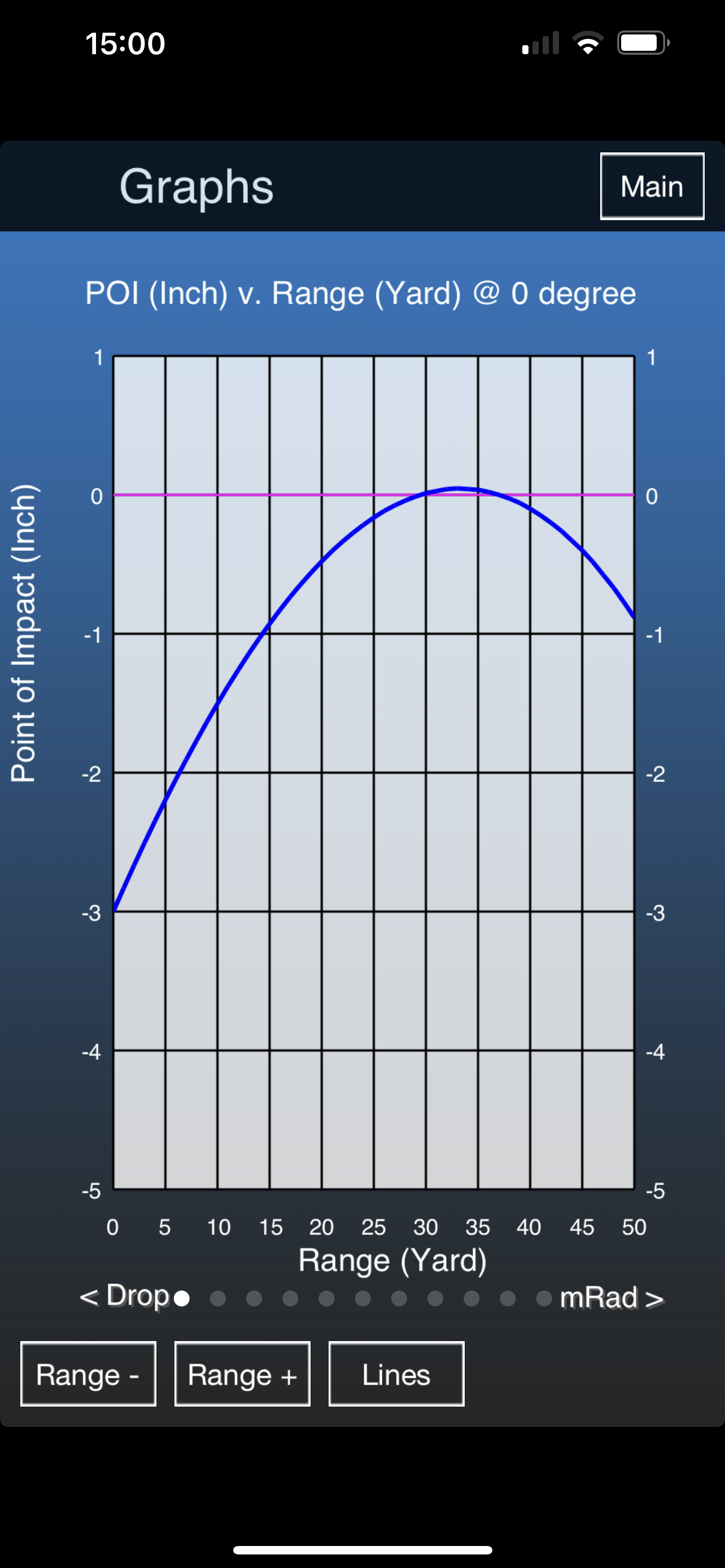

I didn’t see if you mentioned what your scope mount hight is or your zero distance but if you are struggling with the longer shots you could try higher mounts giving you a further zero and less change from say 35-55. Trade off is the ramp from 10-20 getting steep. Ranging 10,11,12,13 will be critical.
These images represent 20 ftlb with scope mounts of 2,3 and 4 inches.
If you look at the videos of European matches they run big risers to flatten the 12ftlb curve.
BINGO!!!! Few Hunter shooters take advantage of this. It's been a mystery to me for years.
