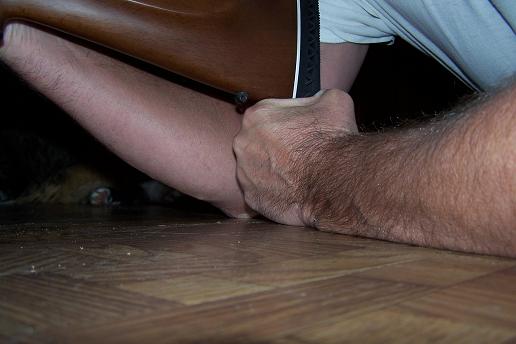

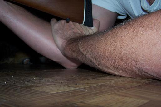

Photos from a few years ago:
I had shot this way for a couple of matches but the first major match that I attended, a match director said that was not allowed. That was before the rule existed. The next year, the rule was put in the handbook.
This is what I ended up doing in most cases. Gun resting on hand, hand not resting on ground. In reality, it's an honor system since an observer would need to be in your space in order to even see an infraction.
