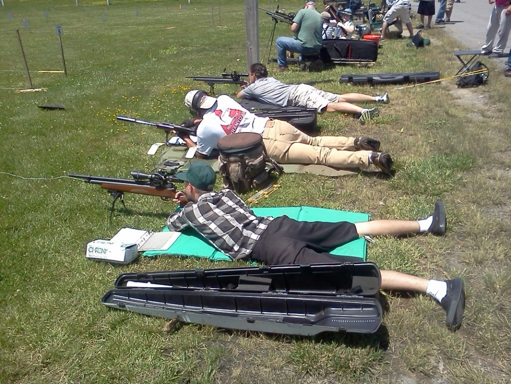

Here are a couple pictures I found from the 2014 NRFTC:
https://www.ctcustomairguns.com/hectors-airgun-blog/the-2014-nerftcs
https://www.crosman.com/connect/photo-galleries/competition/
Yes, shooting off a bipod from the ground in prone position provides a more steady position. Especially with an attached bipod, I know this from winning high level centerfire tactical and field course matches doing so. There's no way in the world I would have done that with sticks and a bucket, lol. An unattached bipod can be made almost as steady. All you need to do is rig something on your gun and/or bipod that holds the gun securely but drops when the rifle is lifted.
Next most steady is using a tripod while sitting on a bucket. I know this from experience.
Next is using sticks like used in hunter, though I think some open shooters are equally as steady in their interesting indian style position.
The problem is being able to engage all the targets when you are down that low in prone, the getting up and down off the ground every time, the kinked necks, the bugs and thorns, clipping grass and leaves, etc.
My course has a tree target that is definitely not shootable from prone and most shooters with sticks will end up sitting on the ground sans bucket. Having shot FT from prone with a bipod, bucket with a bipod, WFTF, and open with a harness IMO all the positions can be trained to be competitively stable. This evidenced by the top scores in all classes at major GPs and nationals are all closely aligned and usually in the upper 50's out of a possible 60. That includes PCP and Piston as well. Will a beginner shoot better from prone with a bipod vs other positions? Yes, but stability can be learned in the other positions. "ain't practice fun?".
