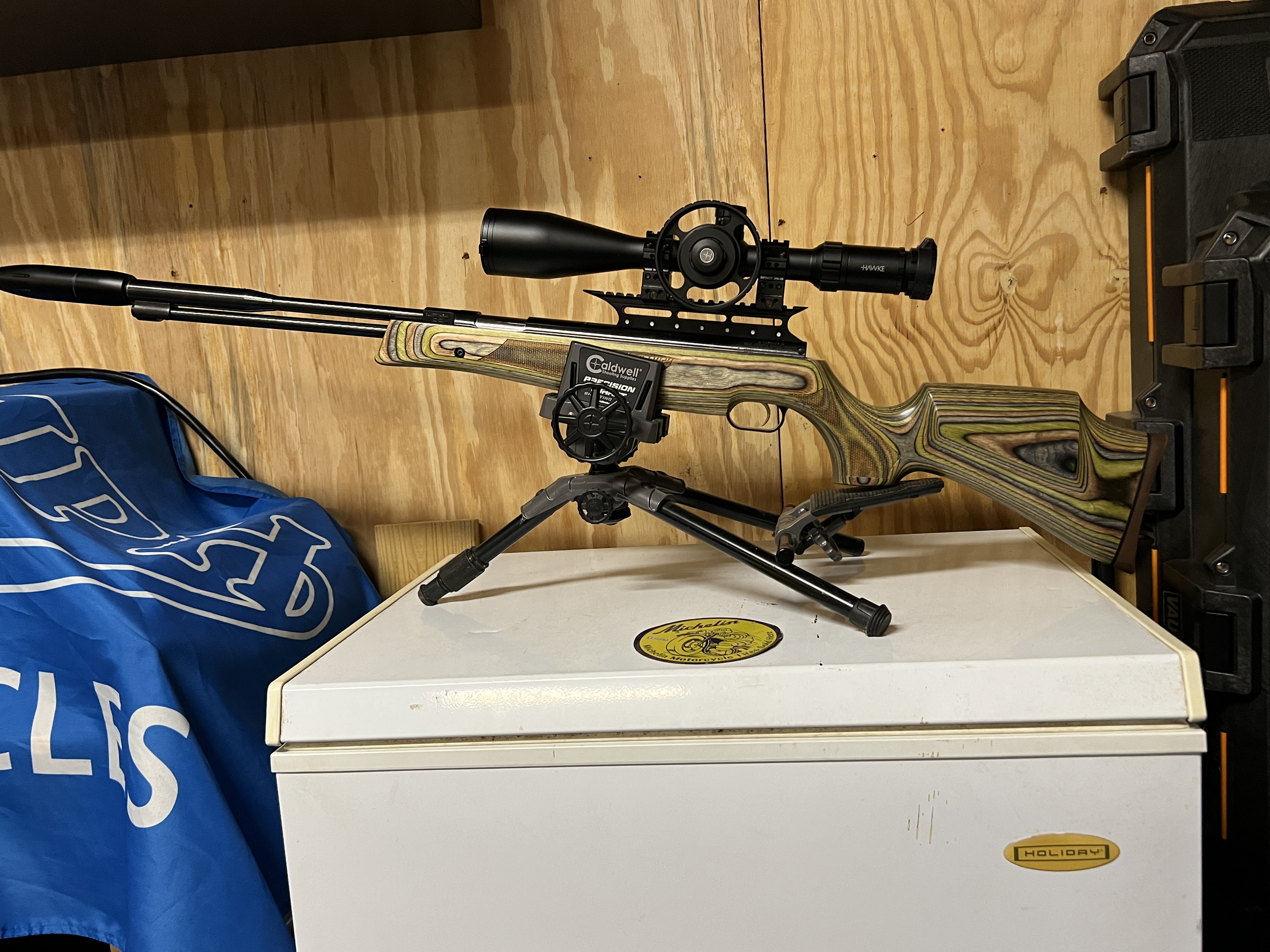

There’s always a compromise with piston guns; more powerful rifles shoot flatter, but are more challenging to shoot with consistent accuracy. Assuming .177 cal, I’ve found somewhere between 12 and 14 foot pounds strikes a nice balance for field target. This generally holds true for heavier target guns such as a TX200 or HW97. Weight is your friend with springers….
That would be a (if not The) candidate.
The shot cycle on these is insanely calm.
I always make my “guests” who express interest in HFT spend a session or two shooting this. Because once they try a pcp, they are ruined and never can appreciate the magic of springers.
