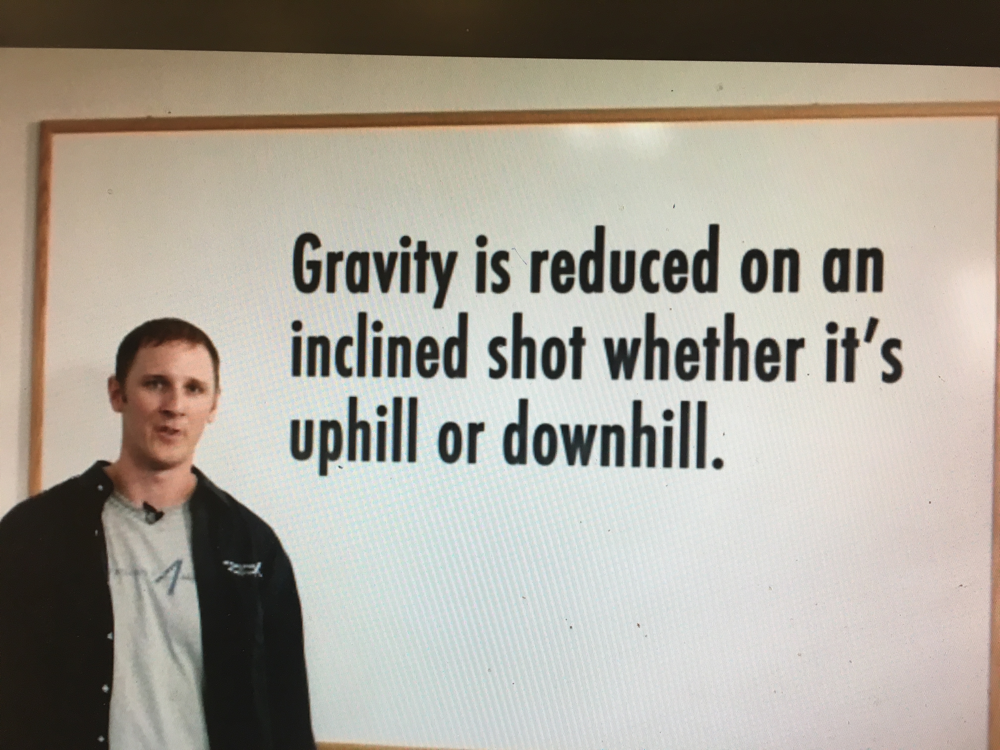

Here is a screen shot from an Applied Ballistics video I had by the ballistics guru
Bryan Litz.

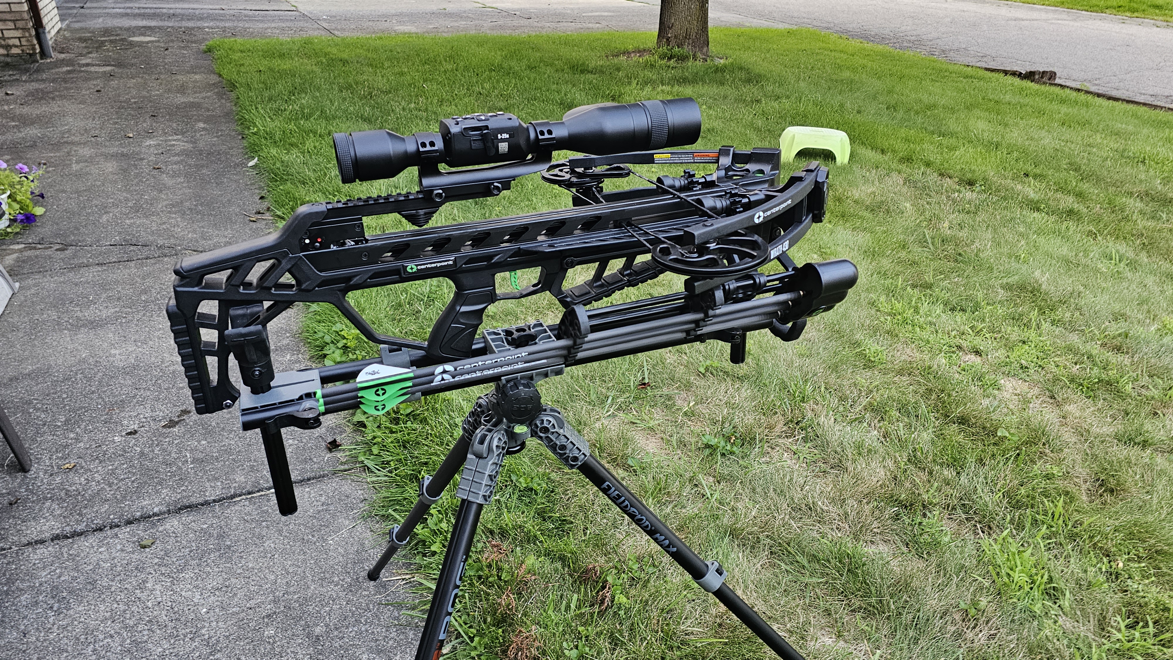

So last year I decided to gear up for deer bow season from a tree stand.
I spent a lot of time researching different stands and harnesses, and this is what I ended up buying. Unfortunately, I just didn't get the time to put it to use, and went out a few times on public land with my pop-up blind, and I was not successful. Maybe this year will afford me the time to try again.

@rcs9250 Looks like what @N2 Shooter said in post #3. Can you share a link to the video?
It was about 5 to 7 years ago but to the best of my knowledge the video came with APLIED BALLISTICS FOR LONG RANGE SHOOTING (second edition).
Would not surprise me if the video is somewhere on youtube. Maybe google search Bryan Litz shooting uphill and downhill. The book of course was focussed on powder burners and a lot of ballistic physics AND a ton of ballistics for many many bullets shooters use.

Yeah, my setup was for crossbow.
