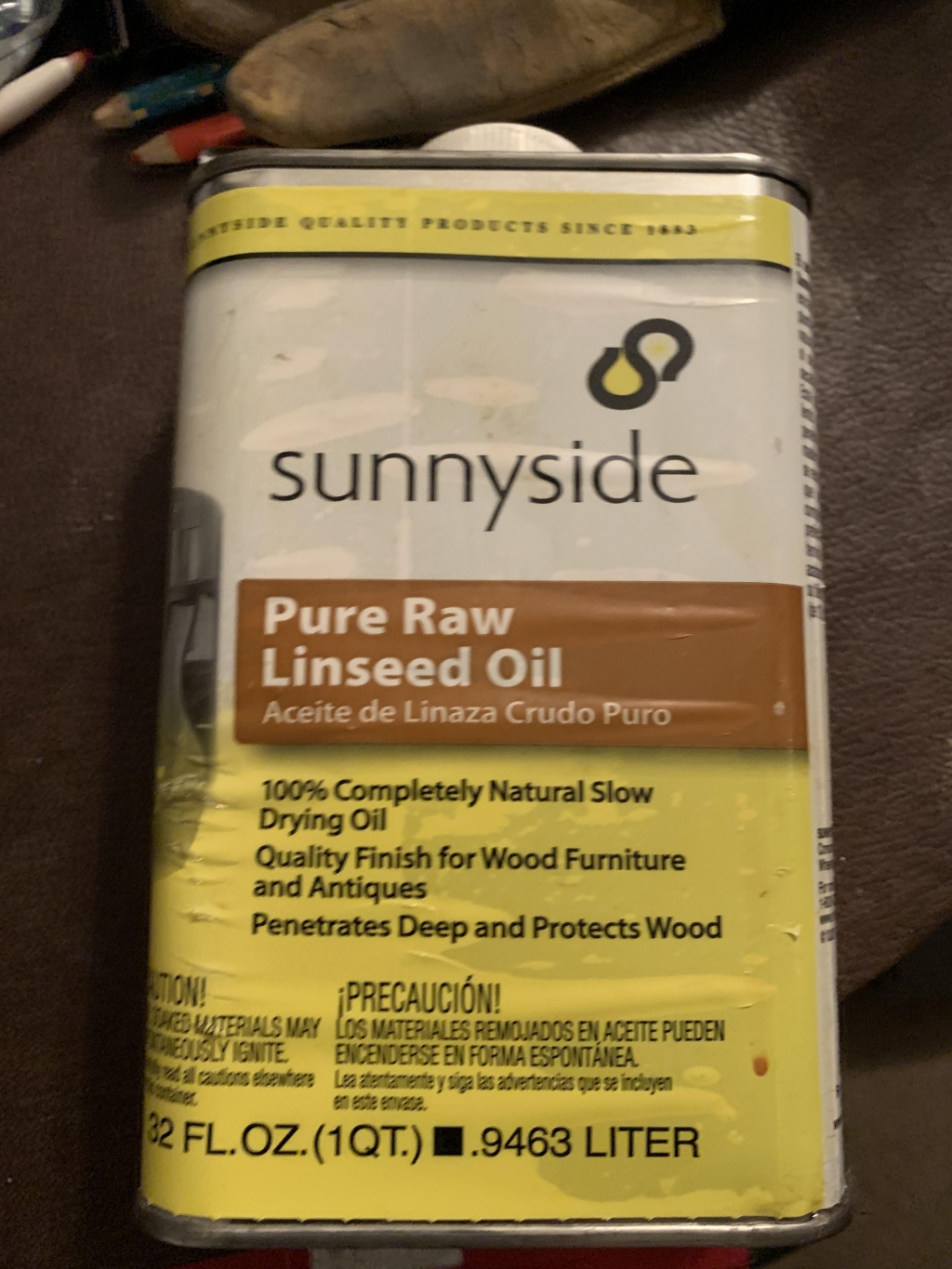

As far as that goes, I could probably take a bit of steel wool to it right now and have a solid base for my pure linseed oil. The problem though is time - I'm running out of it quickly! I have a window this weekend for target shooting, that will probably be the last chance I have to tune this Lelya, and get this little 1-8 ATACR fully dialed in for my hunting trip.
The LO that I used takes a LOT of time to cure .. especially this time if year here in the PNW. If it doesn't cure right, then it's bad 😭 (but it's excellent when it cures properly). This is the stuff that I've been using btw..
