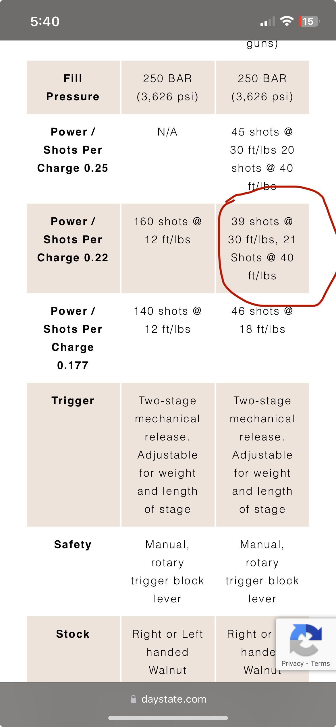

My issue is, no matter how I tune the hammer strike, it has too much extreme spread over only 20 or so shots. Also has a 250 bar fill, but it's practically impossible to tune it for more shots at lower power without a huge spread 100 fps over 30 shots!
I almost gave up on it after wasting a couple hundred pellets. I posted it on ebay last not because I'm discouraged. I wanted to make a 20 shot 50 fpe rifle, which isn't what this gun will do. It'll do 44 fpe for around 15 shots and it jumps too much and accuracy goes to hell.

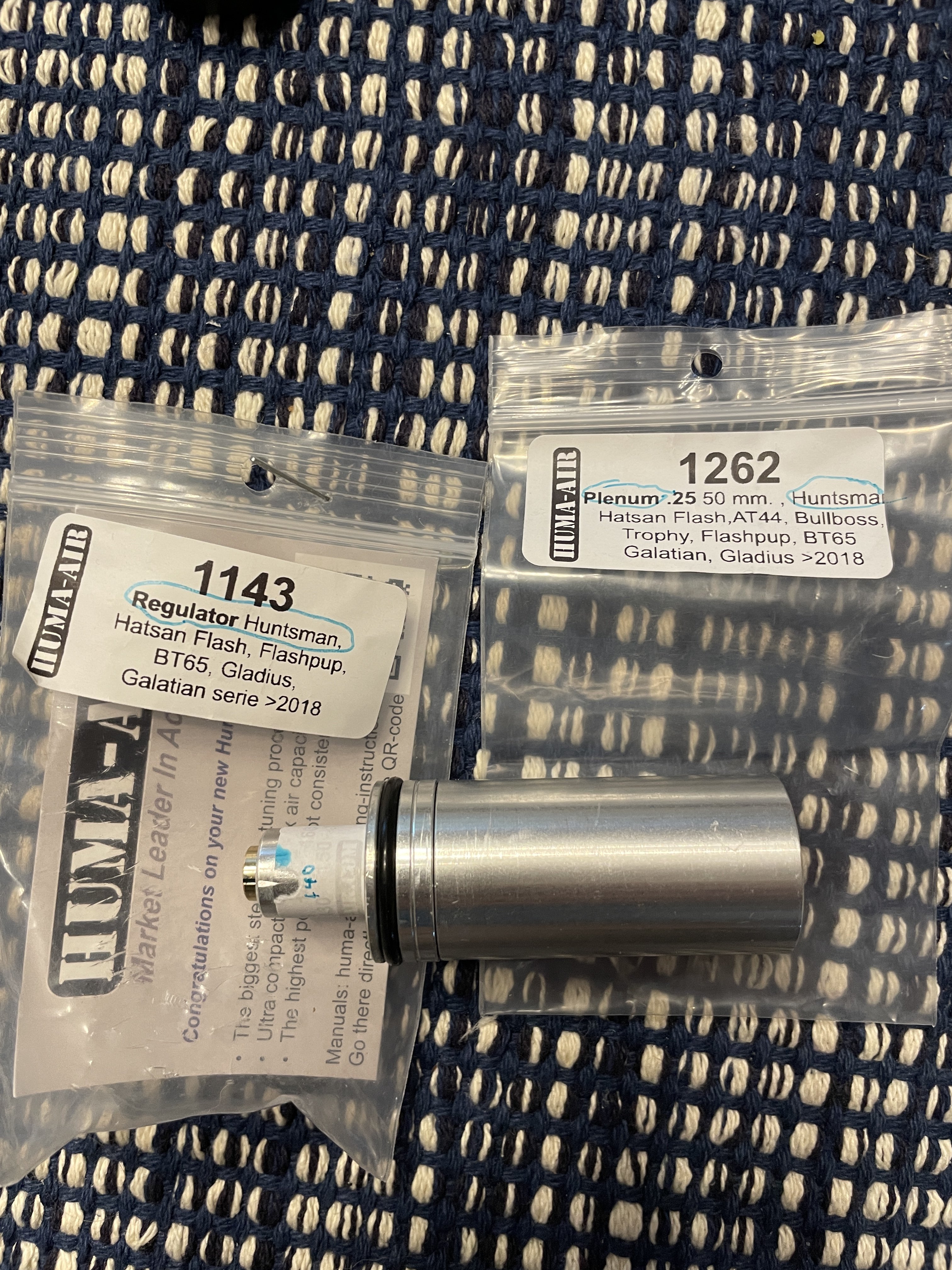

So I got to thinking. Why not just put a Huma reg in it? Not much money and I can get it set up for a nice mild shooting gun that'll still hunt out to 75 yards or so.
I will be ordering one shortly, but I was wanting ask some of you regulator tuners, what pressure should I set thus at? 17" barrel and would like 30+ shots on a fill of 250 bar/162cc. I'd like to see around 800 fps with 25.4s since that's about where it seems most accurate.
I'm thinking around 160 bar setting should get me there, but im not that familiar with reg settings.
