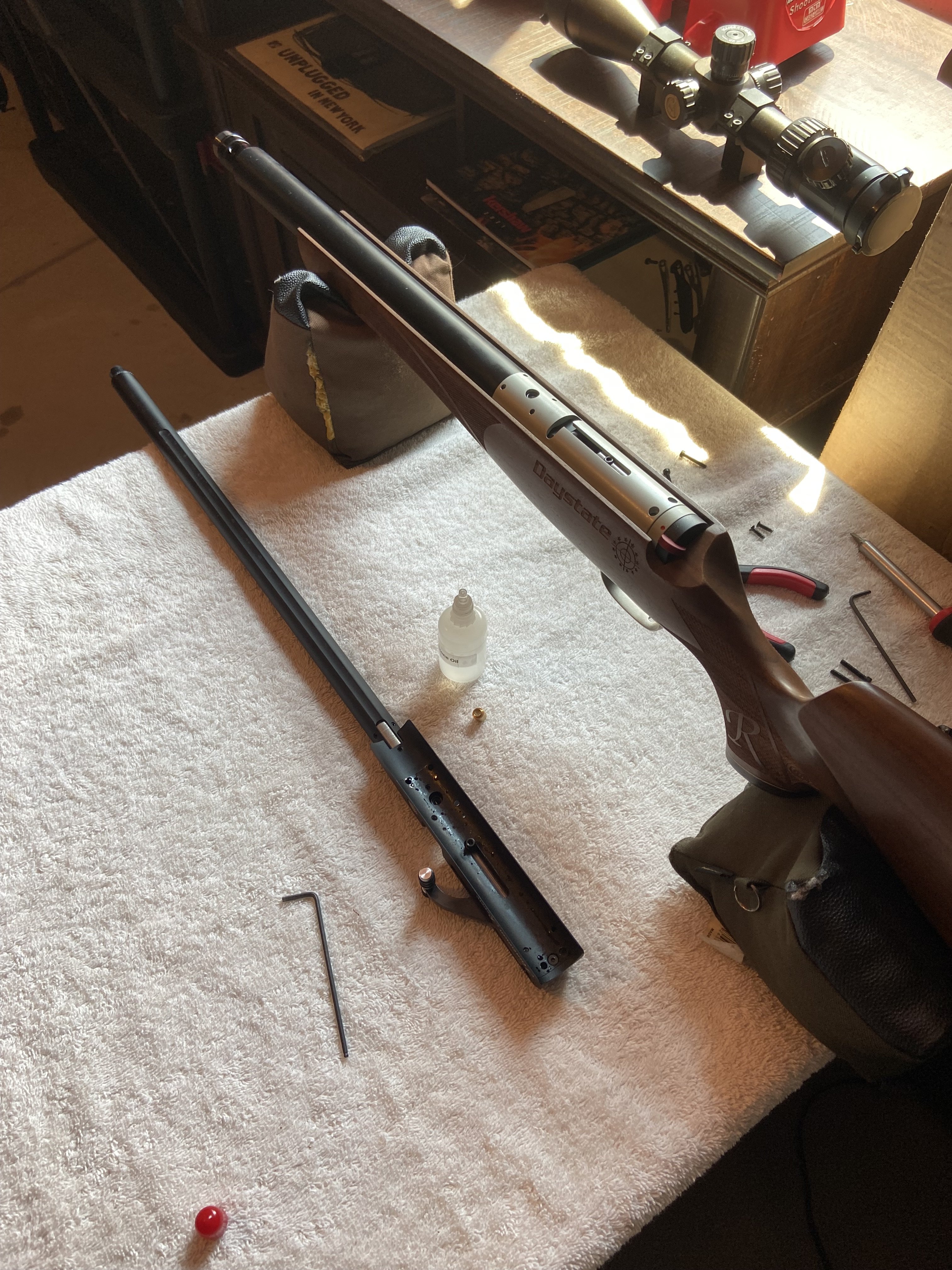

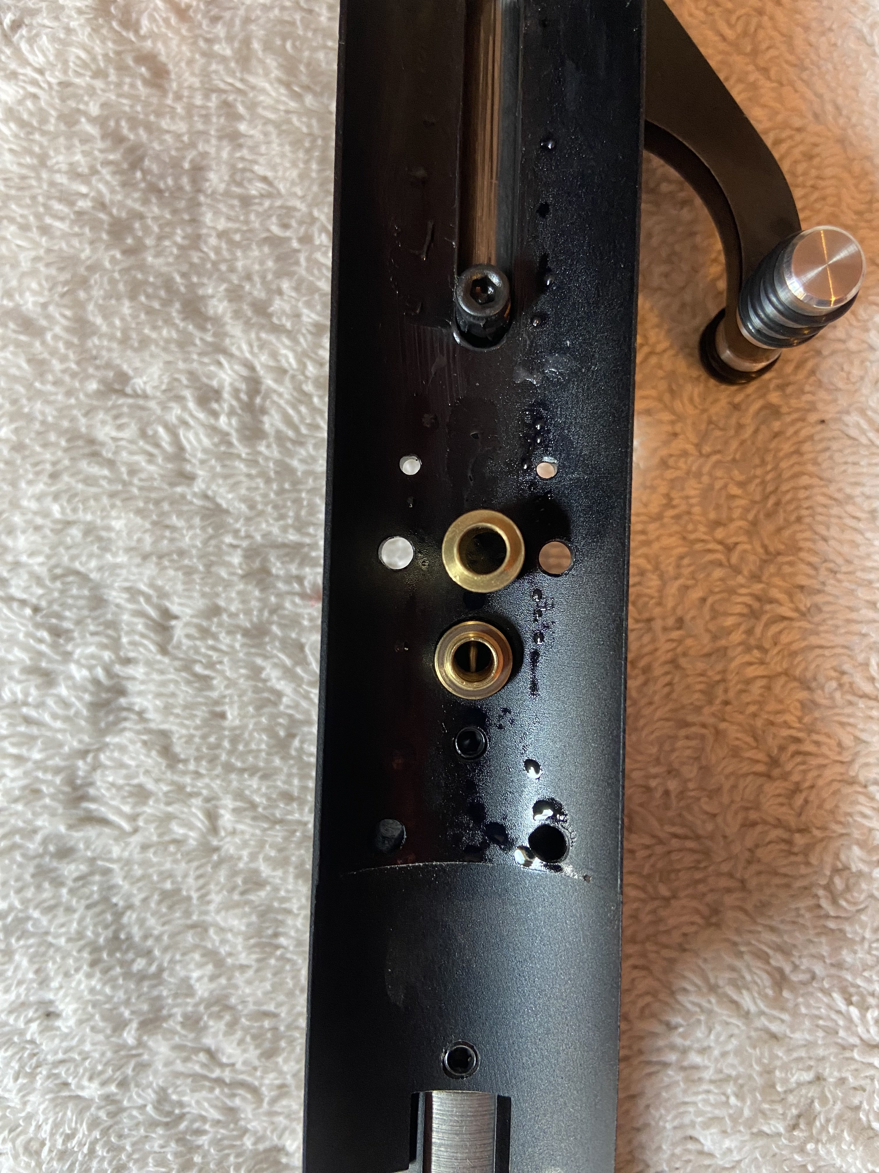

I set my .22cal revere regulator to 130 bar and replaced the factory transfer port to a larger aftermarket one. 50 shots at 24/26ftlbs.

When I was tuning my Prod I bought about 5 transfer ports from Crosman (they are inexpensive) and just drilled them out to the size I wanted to try. From the pictures it looks like you could do that with the Huntsman ports too. It was handy to have a full set of drill bits and a drill press however (to me a full set is all the fractional bits from 1/16 to 1/2 + all the letter size bits + the number bits which were the handiest because they are in the size range you need in small increments).
