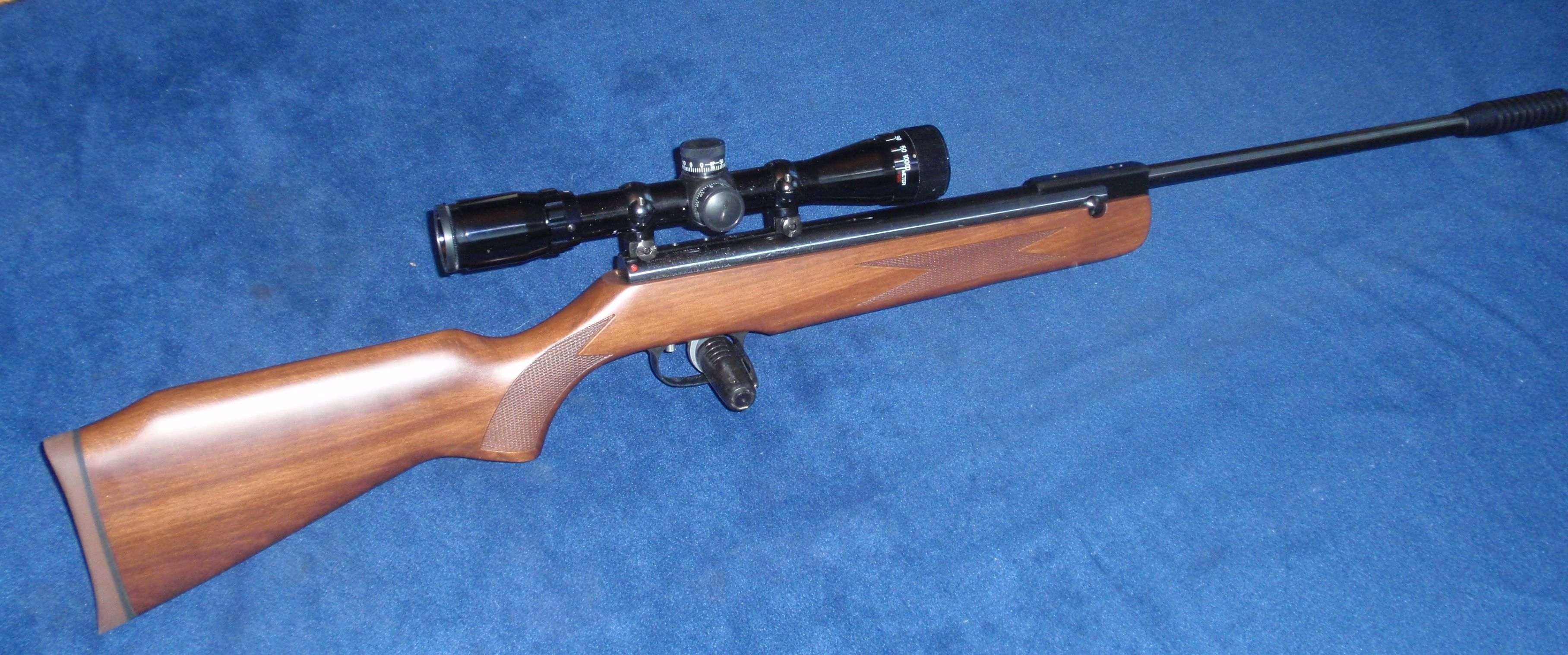

Great rifle choice! Clean the barrel and check the screws every 100 shots or so. Especially the rear trigger guard screw. Buy a lot of pellets, you are going to need them!
Check out the H&N Field Target Trophy .177 452 head size. They are 8.64 grains and do OK in the wind.
I can easily hit soup cans at 55 and 80 yards with mine off of a deck rail.
Hawke 2-7X32 was my choice of optics.
BKL droop compensated one piece mount.
Have fun!

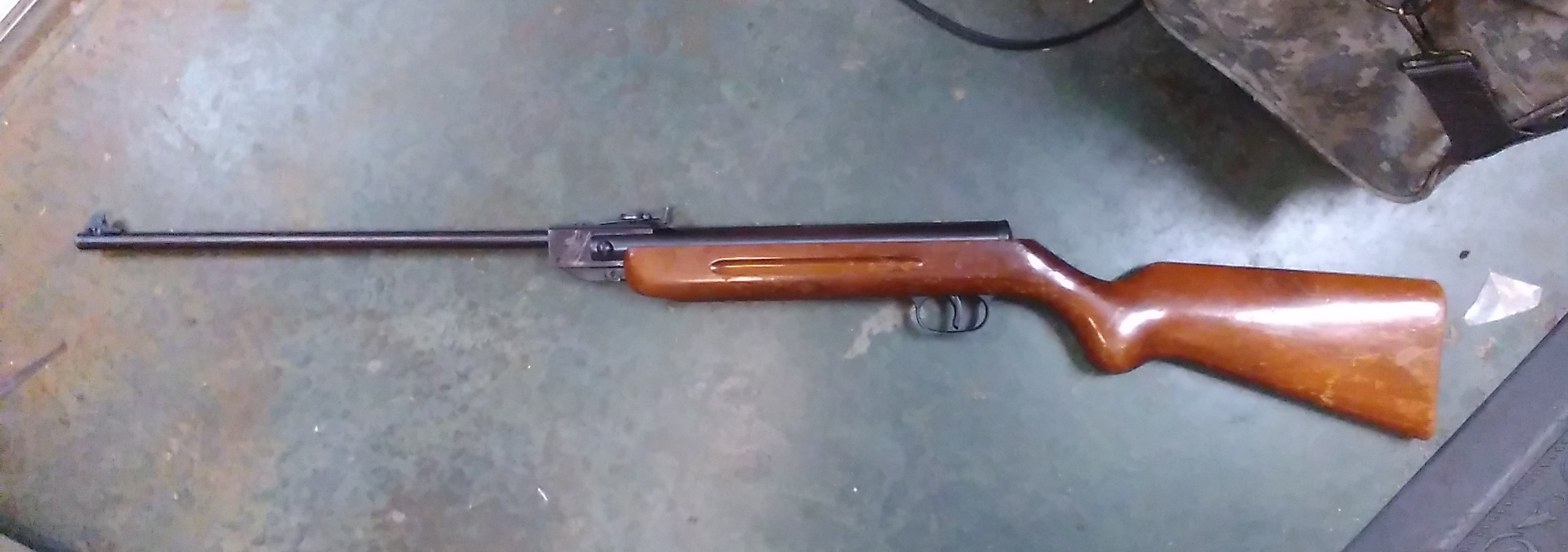

I picked up my first hw30 about 9 months ago, an older one I got from Century when they had a bunch of beat up air rifles cheap. Took some work including a new piston but now I have a nice plinker and realize why these are so popular, just a fun easy gun to shoot. I dated mine to 1983 so maybe an ARH gun?
