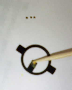

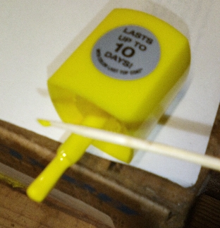

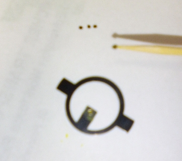

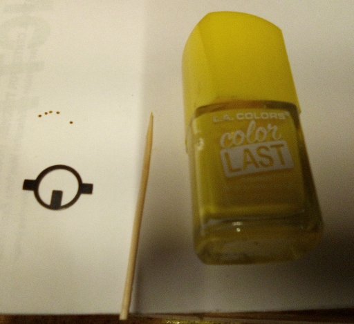

Supplies
Toothpick with a dab of nail polish
A little scraping of polish on post
Take excess off tip and use it to grab a flake

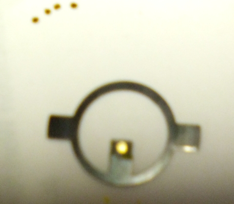

Apply flake to post
Center up flake to to where you want and mash it down with finger and its done

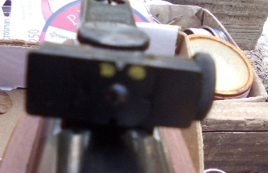

P.s...
The polish lasts way longer then 10 fays ..lol. I think the post i use its been well over a year and still there .. ( lolly)
Use the same method to put a flake on each side of the notches on the rear blade as well😉
