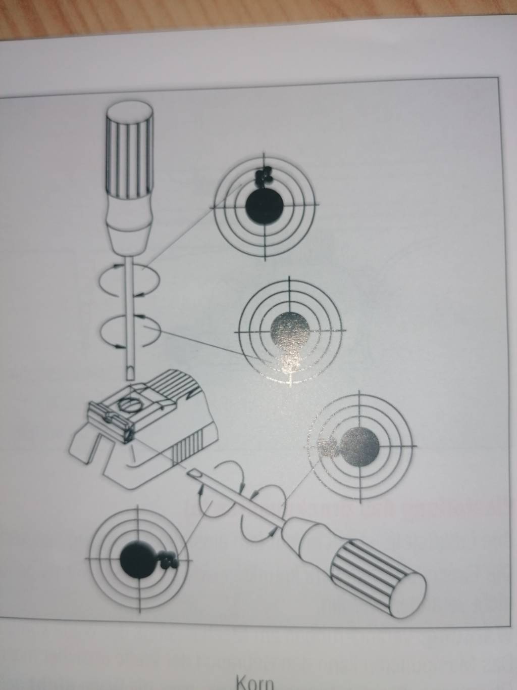

Looks like rear sight needs to be adjusted up to raise the point of impact to me? Just be careful with the red dot as if the base is to long and it is a picatinny the front sight will interfere when trying to mount it..
Biohazardman you are probably right now that i thought about it.I will try that i have adjusted it folowing the manual but i maybe miss understand it.
I thought by that picture if i turn it clockwise my hits will go up.
Or does that mean if you are hitting high turn adjustment screw clockwise?

Diagram is a bit confusing to me. But in the end it does look right clockwise to go down Counterclockwise to go up.

I have it adjusted thanks to biohazardman.

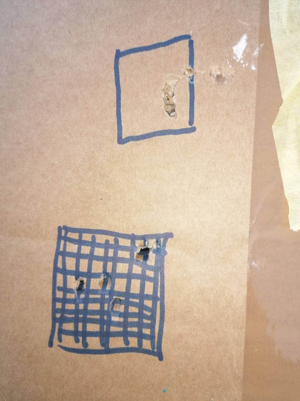

Below are two 5 shoot groups.First one was adjusted verticaly and second also horizontaly. One is just over and other just under 1" at 12 yards. I am happy with that and the fact i am using cheap pellets.

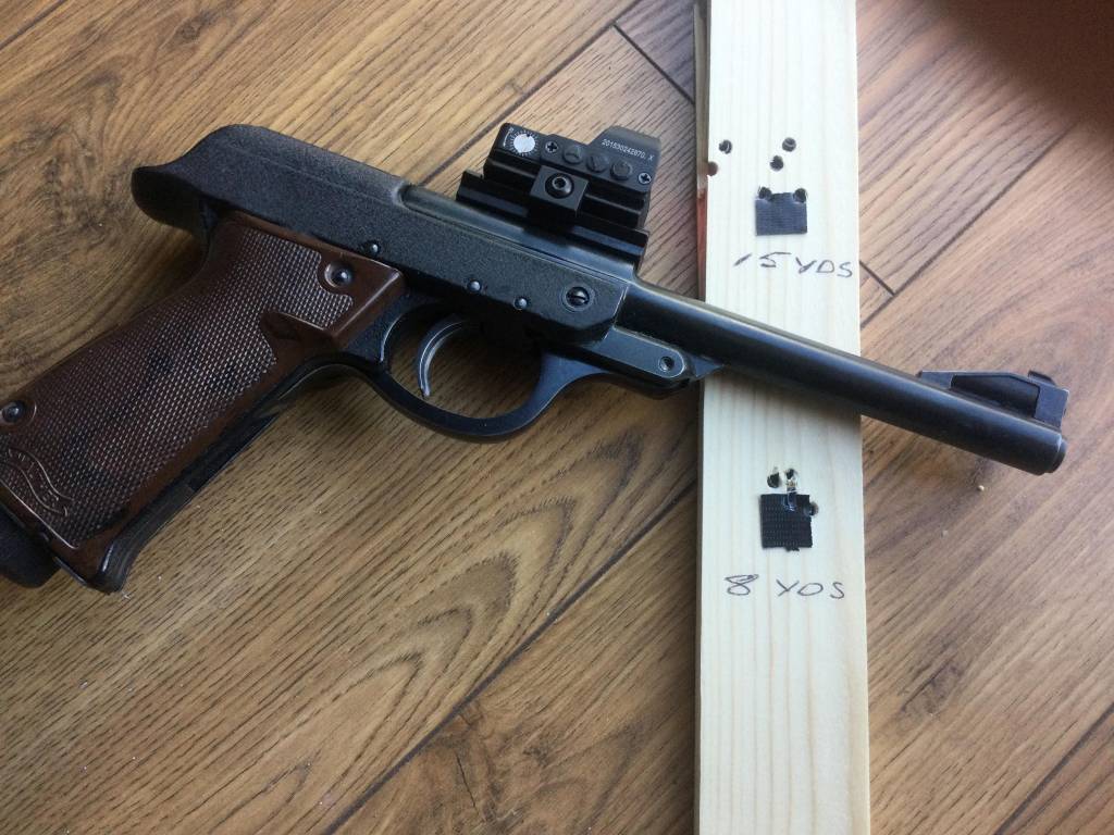

High quality mini reflex sights is the way to go with pistols.....Tested for a good 5 years now on full bore firearms, they are proven to keep zero, are robust and do not alter the balance, or the weight of the pistol, being so small and low in weight. Big tube red dots, requiring scope mounts are now passe....had their day.
I would not think twice to fit one, even on a gun that has no rail like mine didnt..

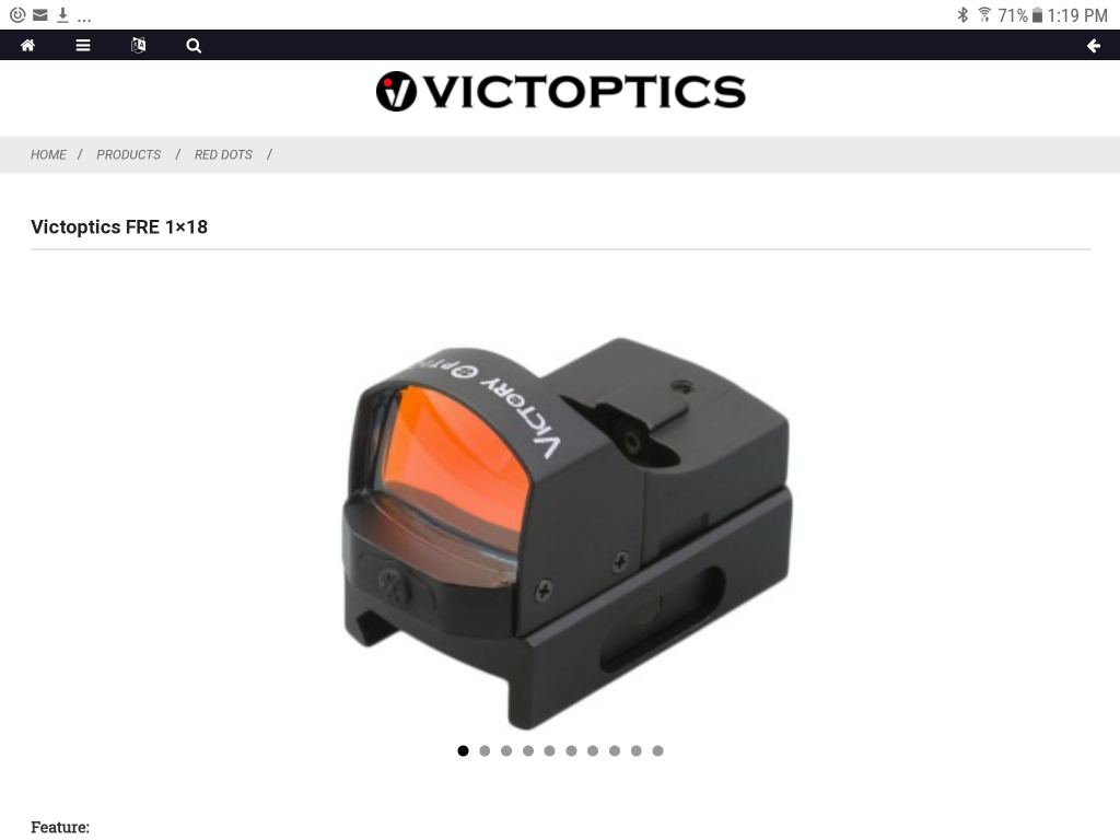

http://www.victoptics.com/rdsl01.html
I have used these for a cheap red dot. They are super small & light, they have a 3 moa dot with 4 levels of brightness. Can be had online for $30 to $35. It takes some effort to zero as the adjustments have a little play in them, but there are 2 lock down screws once it is adjusted, and they have performed great. Not overly blue looking through the lense, like some cheap red dots. Ali express store has California warehouse, last time I received my order in 7 days. (maybe just lucky)
