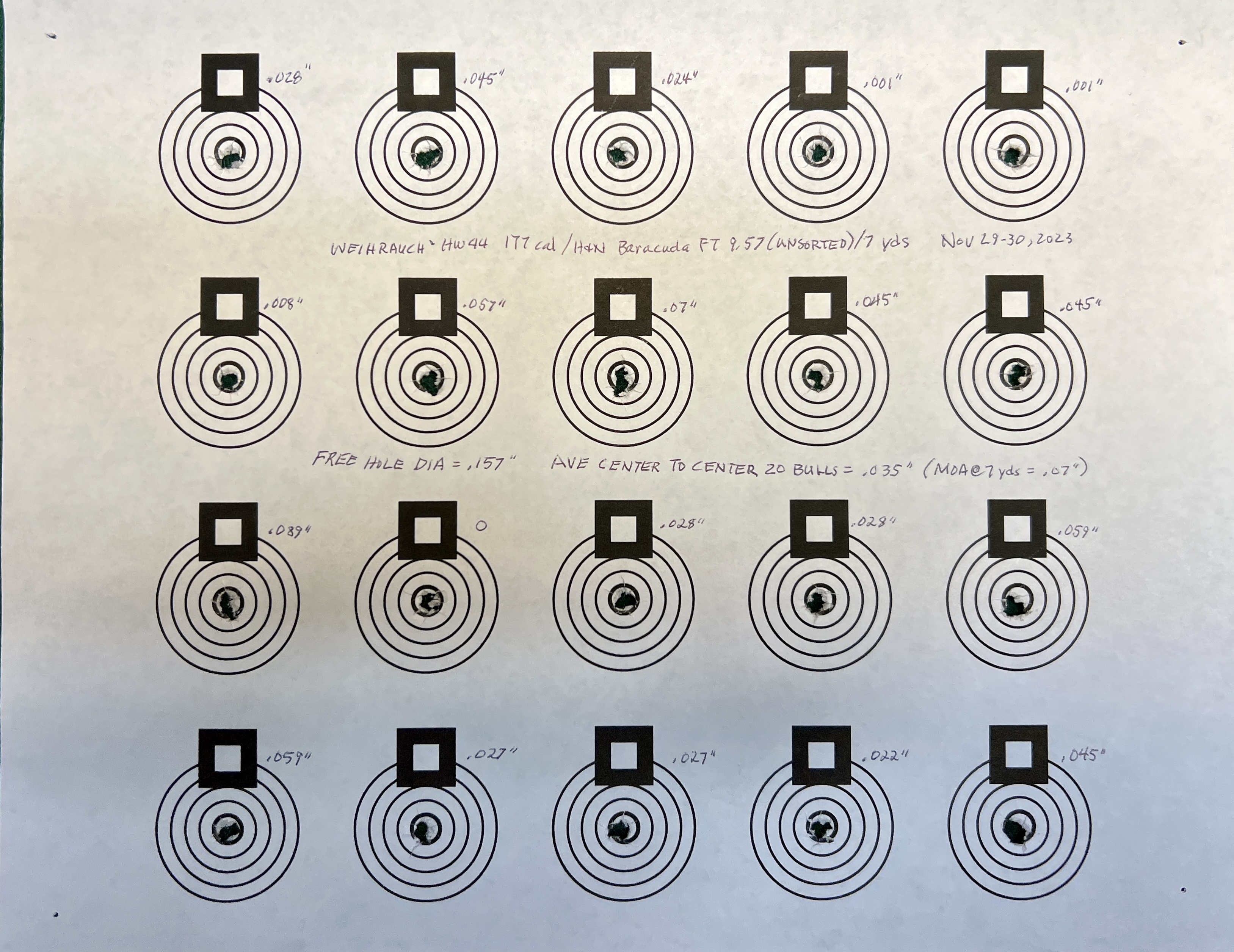

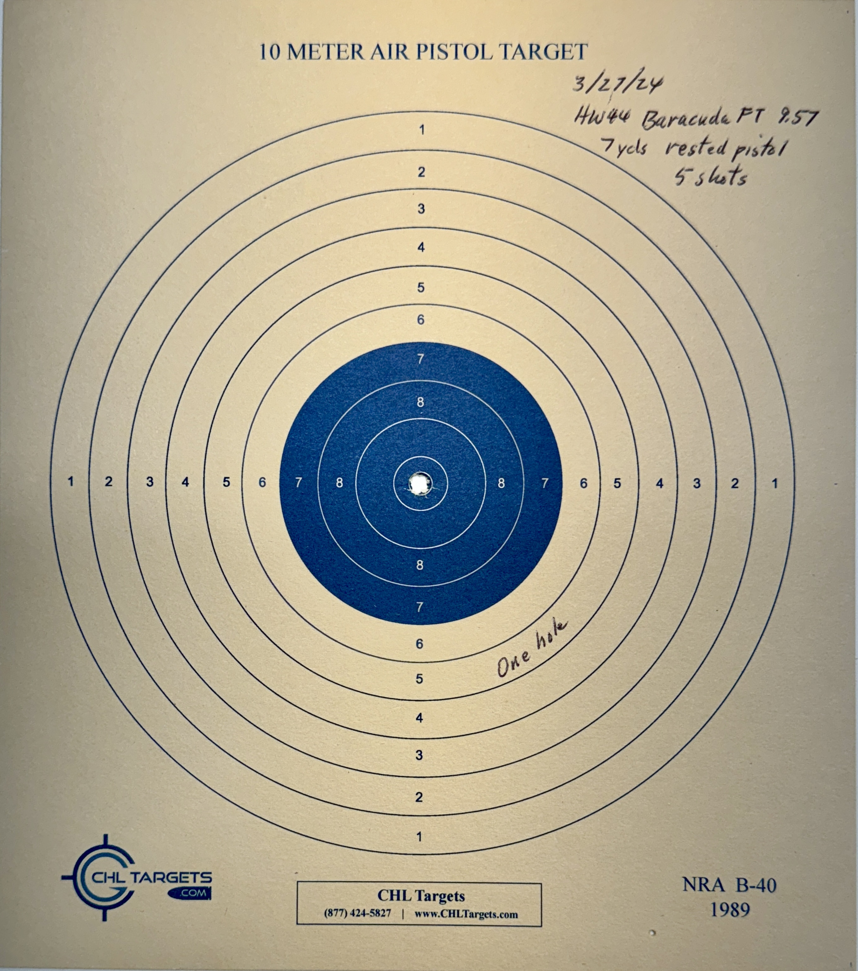

I have the HW44 in 177 and must say, I've never shot a pistol as consistently accurate as this one. It went back to AoA once back when I first had it for trigger work and I haven't touched it (except for shooting) since. Here's a couple pics
The target is from last winter, shot in my basement. I only use H&N Baracuda 9.57 grain select. I shoot from a desktop tripod for support. It will shoot like this every time. So if you are after consistently accurate shots, this would be my recommendation.

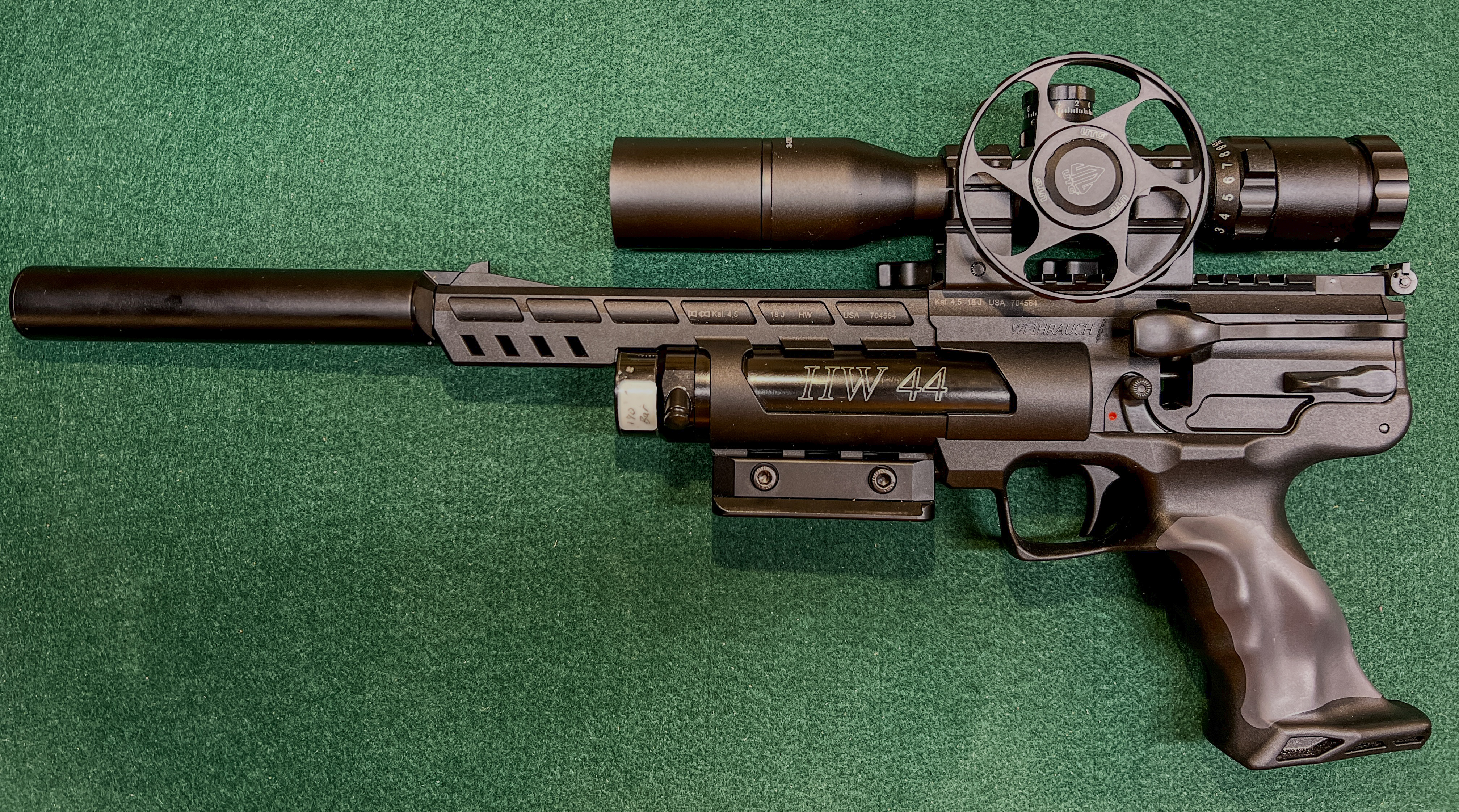

Been shooting FAC level Weihrauchs (HW100 .22, HW100 .177, HW30 .177, HW50 .22) for many years.
I have a HW44 in .22 and am very impressed with it. I prefer the .22 caliber because in addition to target and plinking duties I use the HW44 for pesting. The .22 transfers energy better than the .177 which tends to "shoot through" without anchoring the pest.
The HW44 is not cheap, but it's well designed, well made and very accurate. IMHO it's worth investing in.
