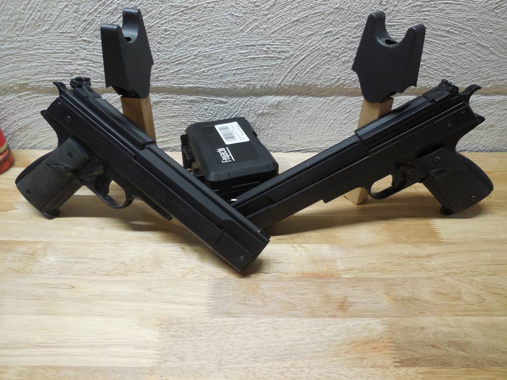

I cant tell a difference my HW45 is .177 and my newly acquired Beeman P1 is .20 cal. I think most owners will agree there is a learning when you first start shooting, but when you master the pistol they are deadly accurate.

Agreed. I have one of each, both in .177.
I see no major difference. The HW45's barrel is a "little" better located in the "slide". The hold down strap is centered a little better, the both screws are a little better placed (vertical). The HW45's slide to frame fit is a "little" tighter. Not overly tight, just a better fit. The HW45's barrel has (had) a slightly better crown on the breach side. The HW45's hammer / spring is a LOT tighter. So unlocking the slide is a bight harder than the P1.
I can't say anything about the pellet speeds, no chronograph yet. No difference in accuracy that I can tell.
None of the above adds up to much in the whole of things. Just seems a little more care in the assembly for the HW45.

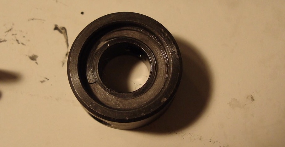

AND....my HW45 does NOT have the o-ring cutting problem that MANY if not most newer P1's have..! NOW...you experts...give me an excuse for THAT one..! Though an "X" ring mostly alleviates the o-ring cutting problem, fact is, there IS a problem with newer P1's. Has that problem been fixed in the newest models, I do not know.

Issues with the breech seal O ring are thankfully not common with this pistol, but when it happens, i believe it is coming from a tolerance build up…probably effecting P1 and HW45 regardless.
The barrels usually run around +/- .005 of each other. The position of the barrel strap groove probably similar and the clearance of fit for that barrel strap is a good .004. to allow fitting. This means that when the barrel is clamped in place by the factory, it could mean as much as 7 thou difference in tolerance build ups gun to gun. …some closing too tightly against the O ring and others less so.
A good way to over come any tolerance build ups is to reassemble your barrel. A nice way to do this is to loosen the barrel strap fixing slightly so it is barely holding the barrel in place. Then close the gun. Now take a pin punch and tap the barrel up to the O ring with 1/4” pin punch from the muzzle end, open the gun and tighten off the fixing screws. In this way, the barrel is just nudging the O ring but without crushing it. Also a touch of silicone smeared on the O ring will help keep its front face lubricated.
