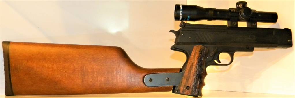

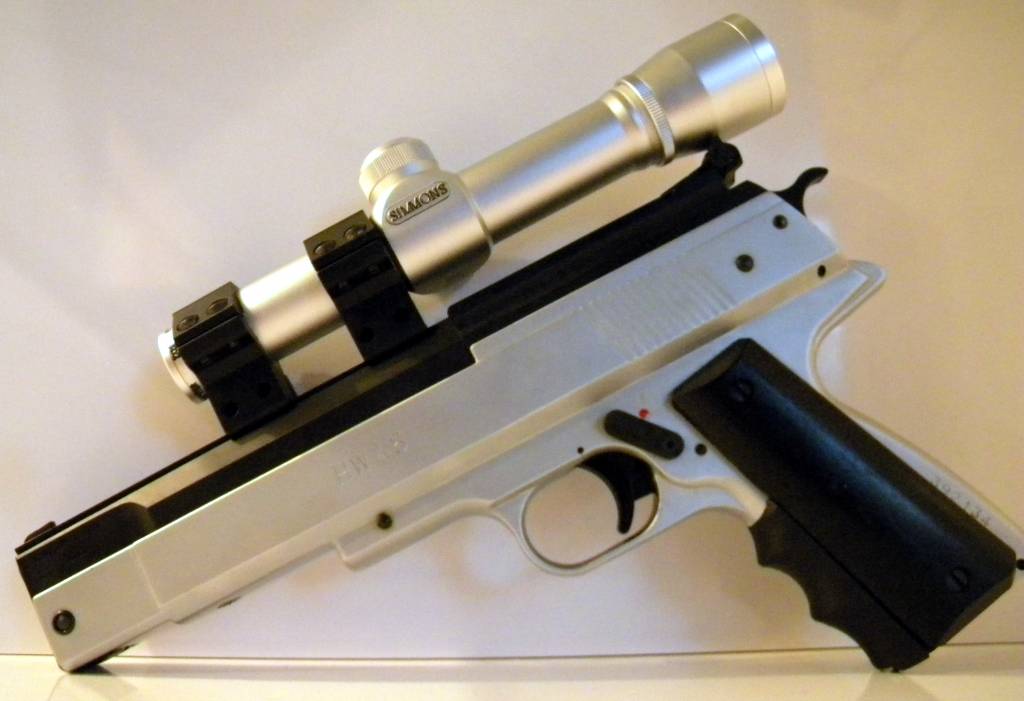

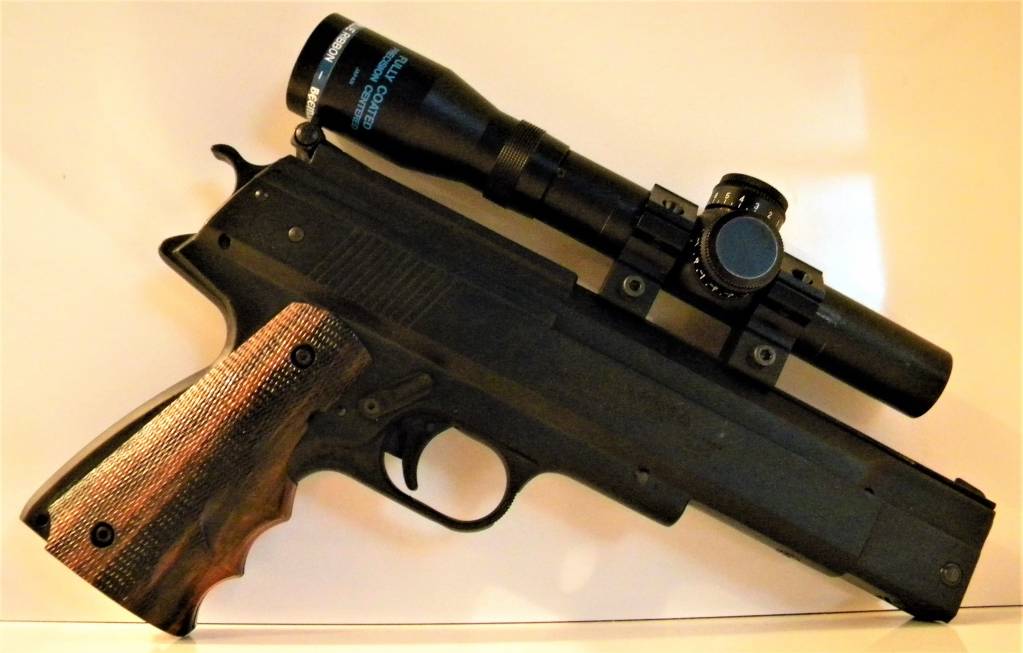

Really great air pistols and the triggers have a nice amount of adjustment and can be set up quite nicely. The Beeman equivalent is the P1 and they are identical in all but the name on the side. Scopes can attached to the top rail and a wooden add on stock was offered a long while ago, some modern ones although different can be found on eBay. Pending the age and caliber not all were dual power. My HW45 .22 is NOT capable of 2 power settings but the other calibers of the same vintage are. Any 1911 grips can be attached without modifications. Although it does have 2 way recoil the piston is actually cocked towards the front and pushes rearward when fired! Here is a pic of the stock and scope attached to my P1 (.177) and my HW45 two tone .22 As far as power I have taken starlings out to 45 feet with both of mine.
