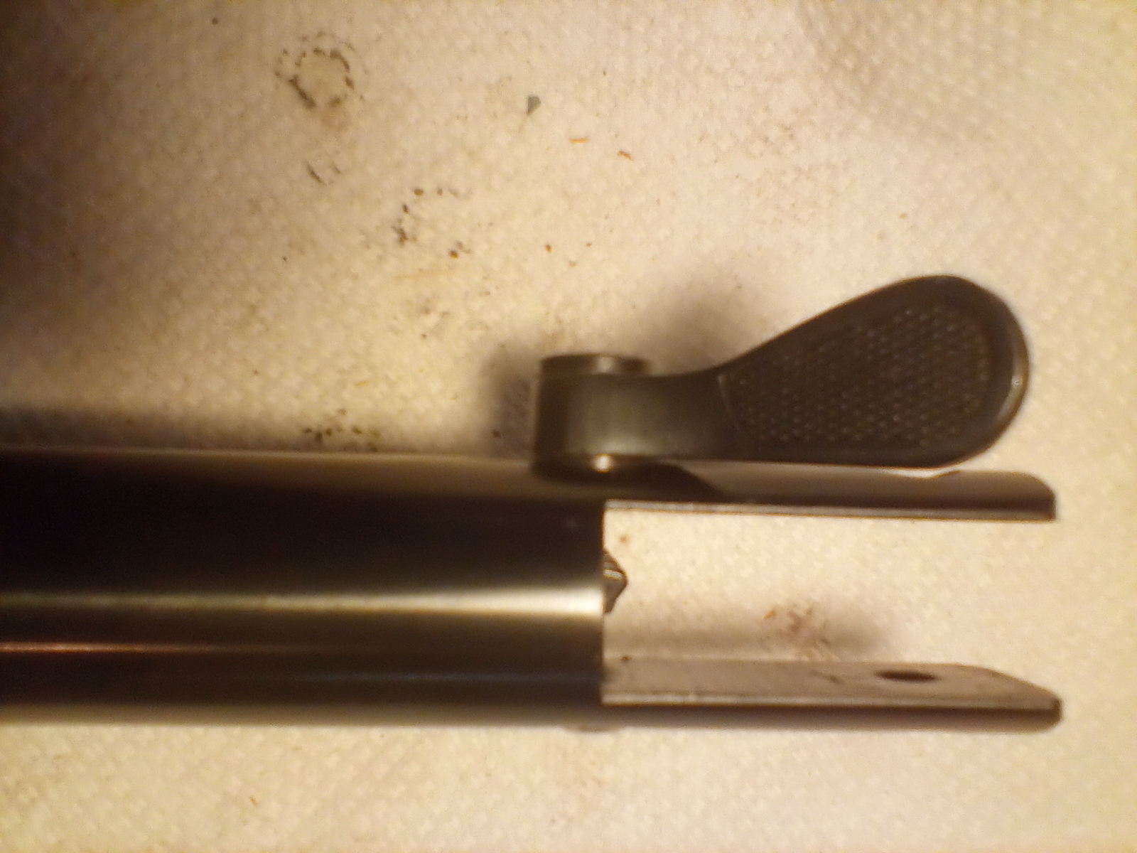

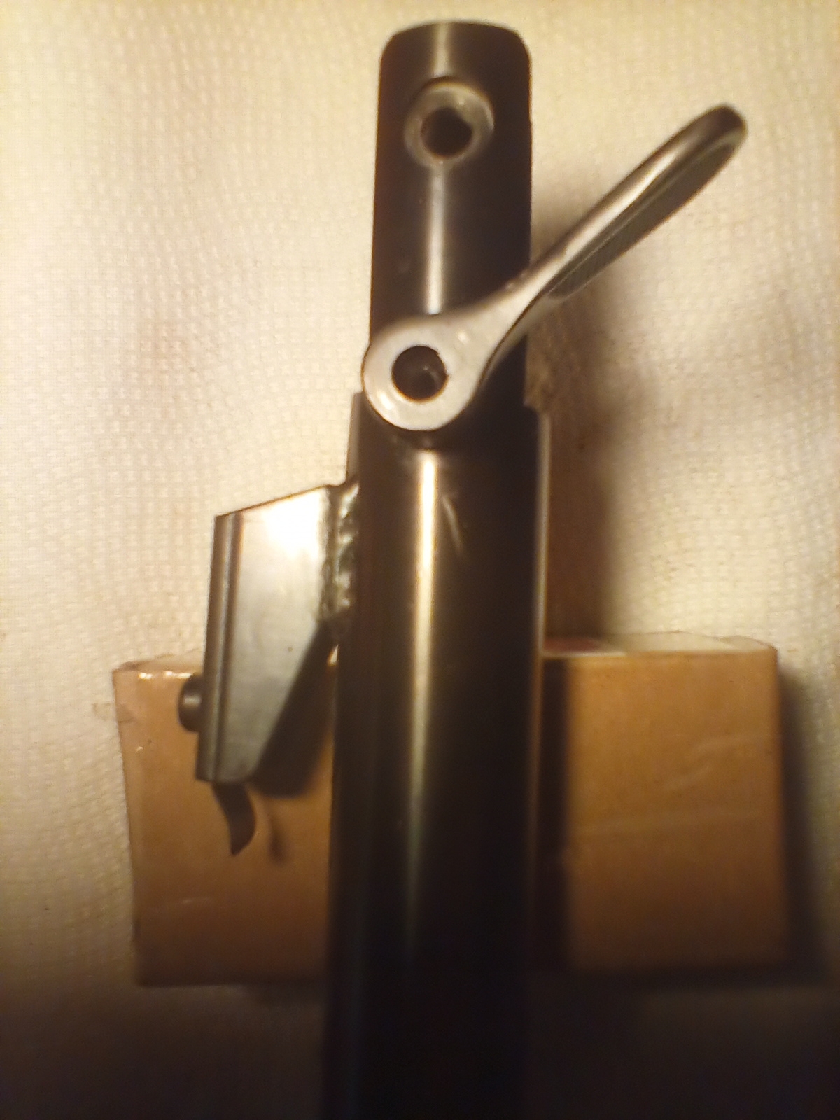

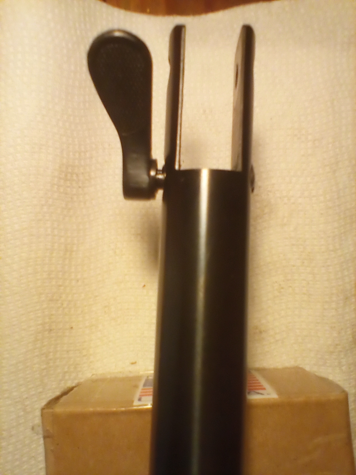

Barrel latch screw was loose. Did not notice. Barrel latch lever now stuck halfway on/halfway off shaft. Too far off for threads of retaining screw to engage threaded hole in shaft lever is mounted on. Lever will not come off or push all the way back on.
Suggestions anyone ?
Thanks !
Pictures. Will not push or tap back on. Will not pull off.
Looks like there is a flat for anti-rotation. The lever could be stuck because the flat on the lever is not lined up with the flat on the shaft. If that is the case, tap the lever to line the two flats up before trying to remove or push the lever back on. You definitely don’t want to force the lever on unless the flats or whatever anti-rotation features are present are lined up properly. Some clean up may be required once you get it off to remove any burrs that may have been kicked up.

okay i would find a hard but non marring something the put between the handle and tube and find a screw and or bolt for the shaft and tap the shaft off the handle
now i am assuming that the shaft will back out in the position that it is in
will it make the damage worse more than like not i see no flats on the small amount of shaft showing so a wrench to hold the shaft could not work but again i am assume that
Reactions: .20calguy
Protect the receiver behind the lever with several layers of blue painters tape. Find a small Allen wrench that will clear the threads of the bolt. Cut the Allen wrench to straight. They are very hard. Carefully insert the Allen into the bottom of the bolt hole. Careful to keep the Allen clear of the threads. Gently tap the bolt out. If you have piece of hardwood, drill a large enough hole in it to allow the bolt head to clear, tape off the receiver on the bolt head side and when tapping the bolt out you have a good hard surface to tap against. You also can use a vise in stead of a hammer. Lining everything up is tricky but the control and pressure from a vise is best.

With a combination of tips from all of you parts were removed with minimal damage !
It is a press fit with a key in the lever and a keyway in the shaft.
Back together as you can see.
You can be sure I will be checking the lever retaining screw regularly from now on.
