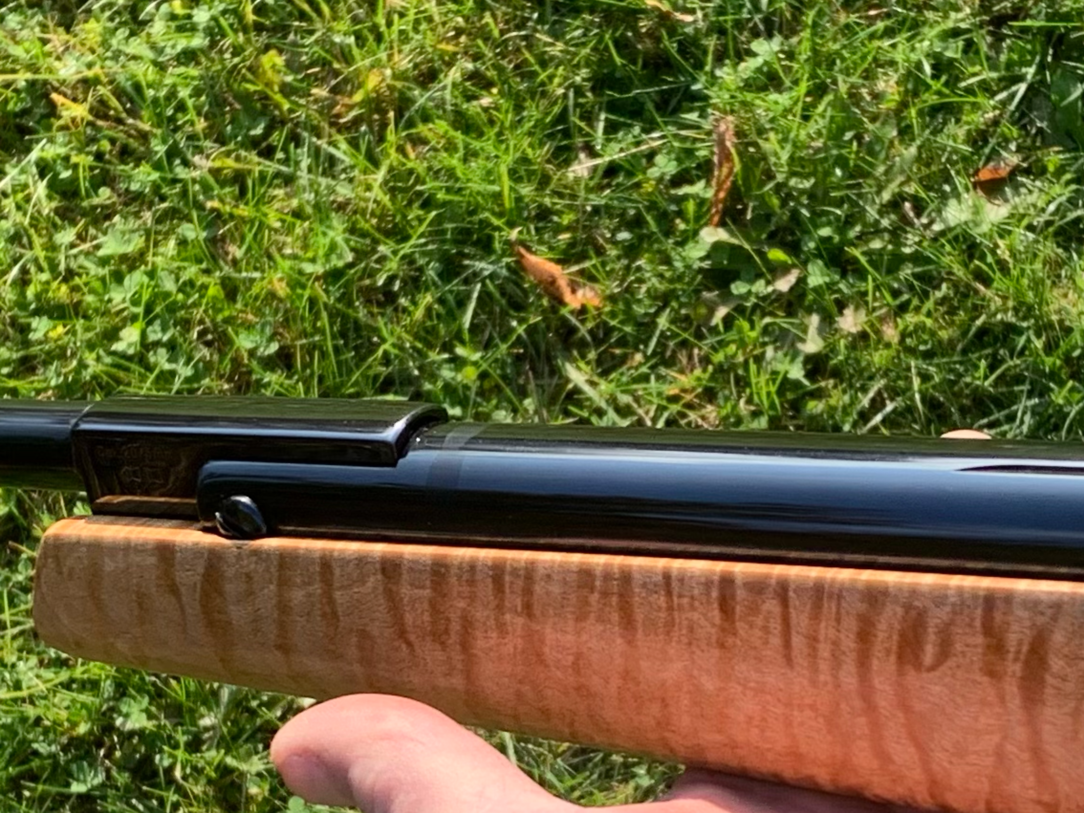

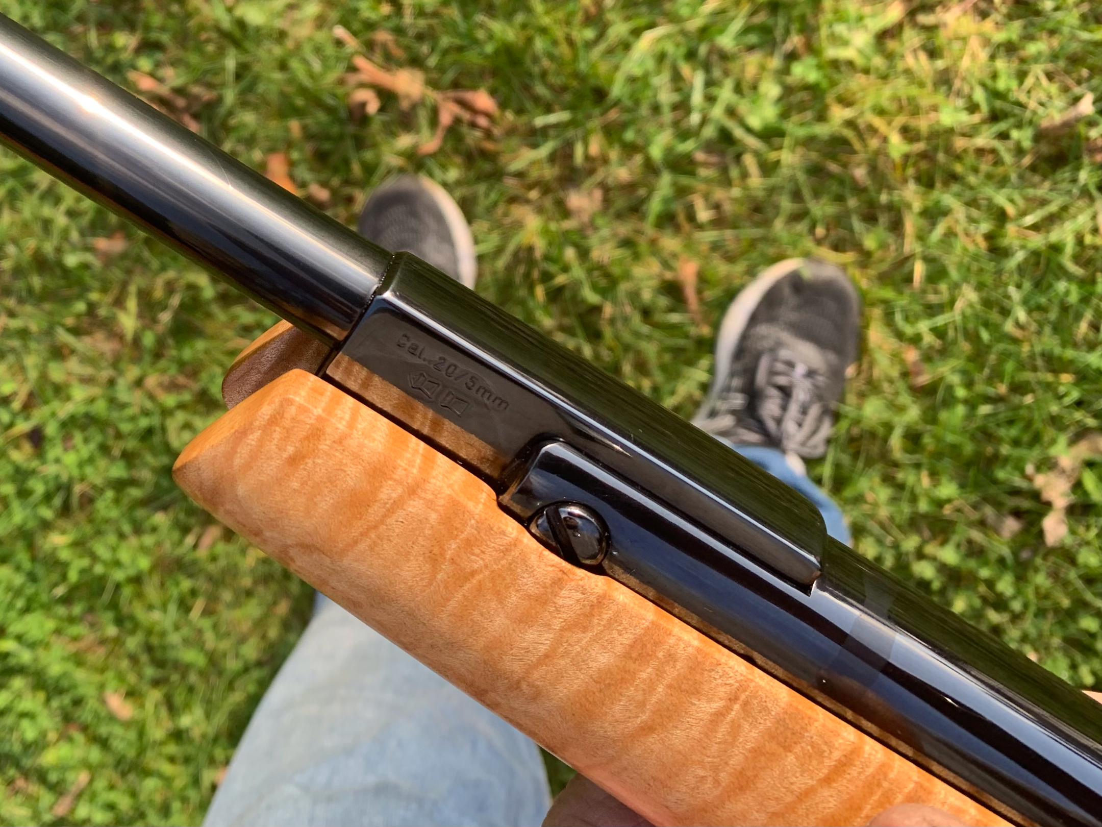

This is a older HW 80 ,.22 I made for myself. I rarely use any barrel longer than 13 inches shrouded, to 17 with some internal work . However; I wanted this gun to look like a classic Remington 700 look
It’s very accurate but took some time to get used to the ballance of 500mm barrel.
20 ft lbs and a breeze to cock with a 29 coil spring and custom guides and top hat, minor port work.
Since I never use sights I machined the breech to match the chamber like a Uk Tommy. Reblued to factory finish..
custom feather crotch walnut stock.
Shot cycle is dead ,but a louder snap than I’m used to as there is no shroud.
Time to checker the custom feather crotch Claro walnut
