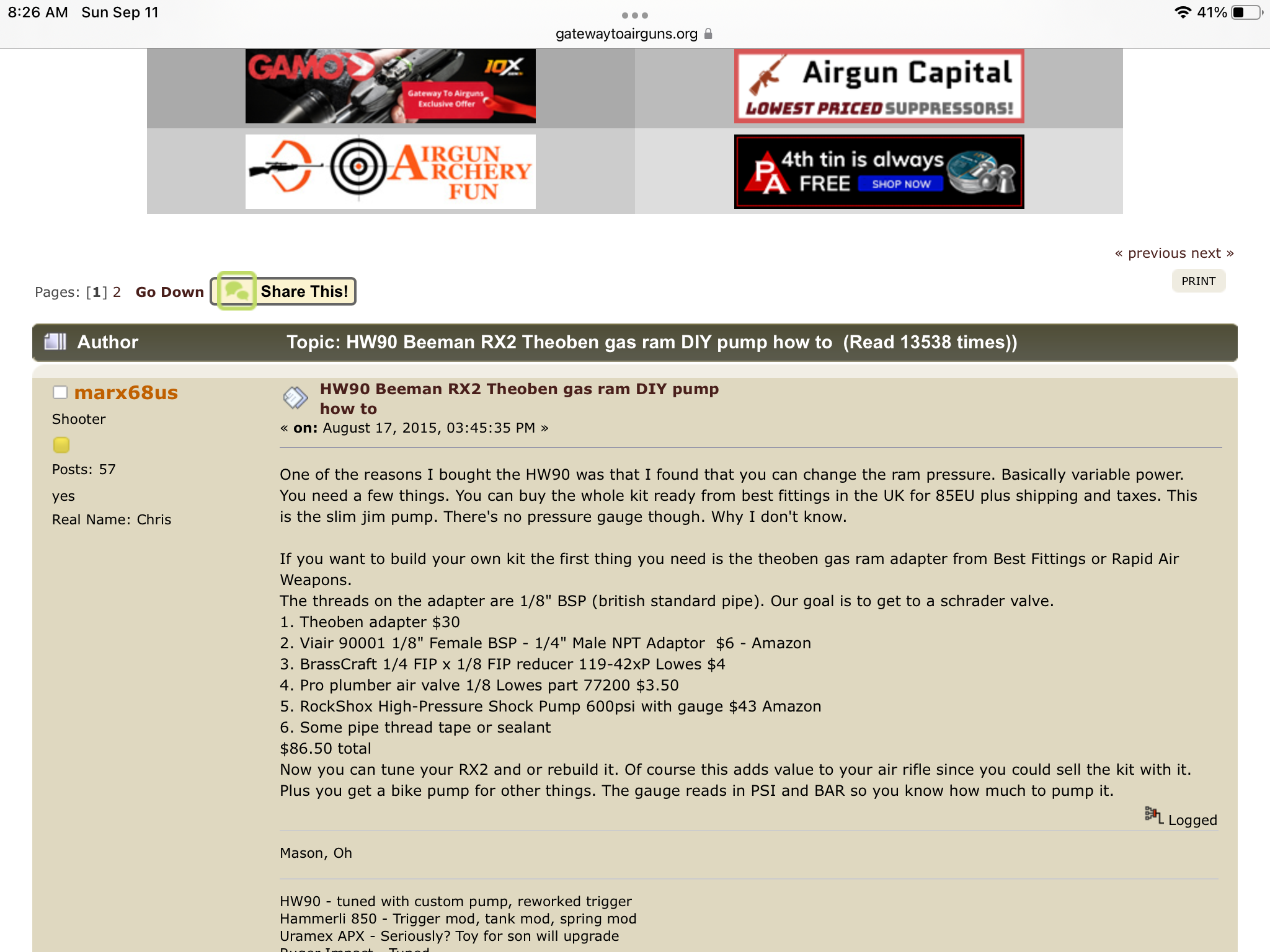

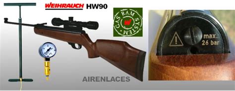

Anyway thete were 2 rams . I think a lower pressure and higher .
Im still looking for that example , but does yours have the pressure info on it ?
Like showen here

I guess if your pcp pump can squeeze under 30bar in a pump or hold your mouth right it can work . I think guys get a bit easy to use with a pump that not shooting more then you need in to get a closer to fine tune .

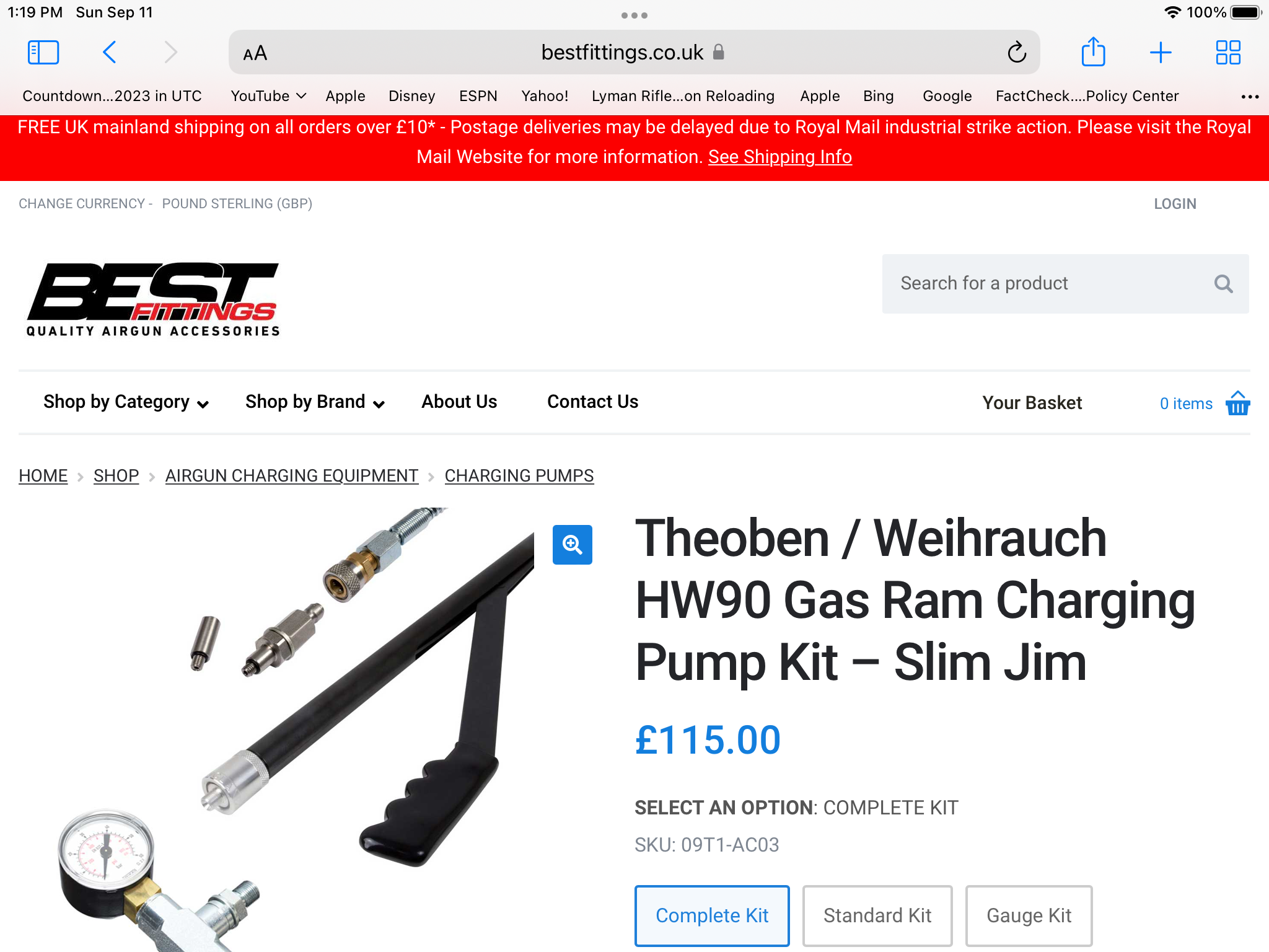

are there any options to the HW 90 pump and gauge . i really have a fascination with the tunability of the HW 90 . Would a hand pump with the correct fitting work ?
Thank you Stan in KY
There doesn't seem to be many places to buy the HW90 gauge in the USA, Airguns of Arizona is the only place I've seen so far and it's out of stock. I'm not certain on the fittings.
