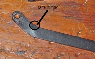

The cocking arm was hitting the underneath side of the breech, not allowing it to close all the way

Maybe one more thing to check as a fyi
When they make the bend it can develop a bulge or im calling it a camel hump in the bend that may need taken down
Pretty much start seeing the bluing rubbed as well
