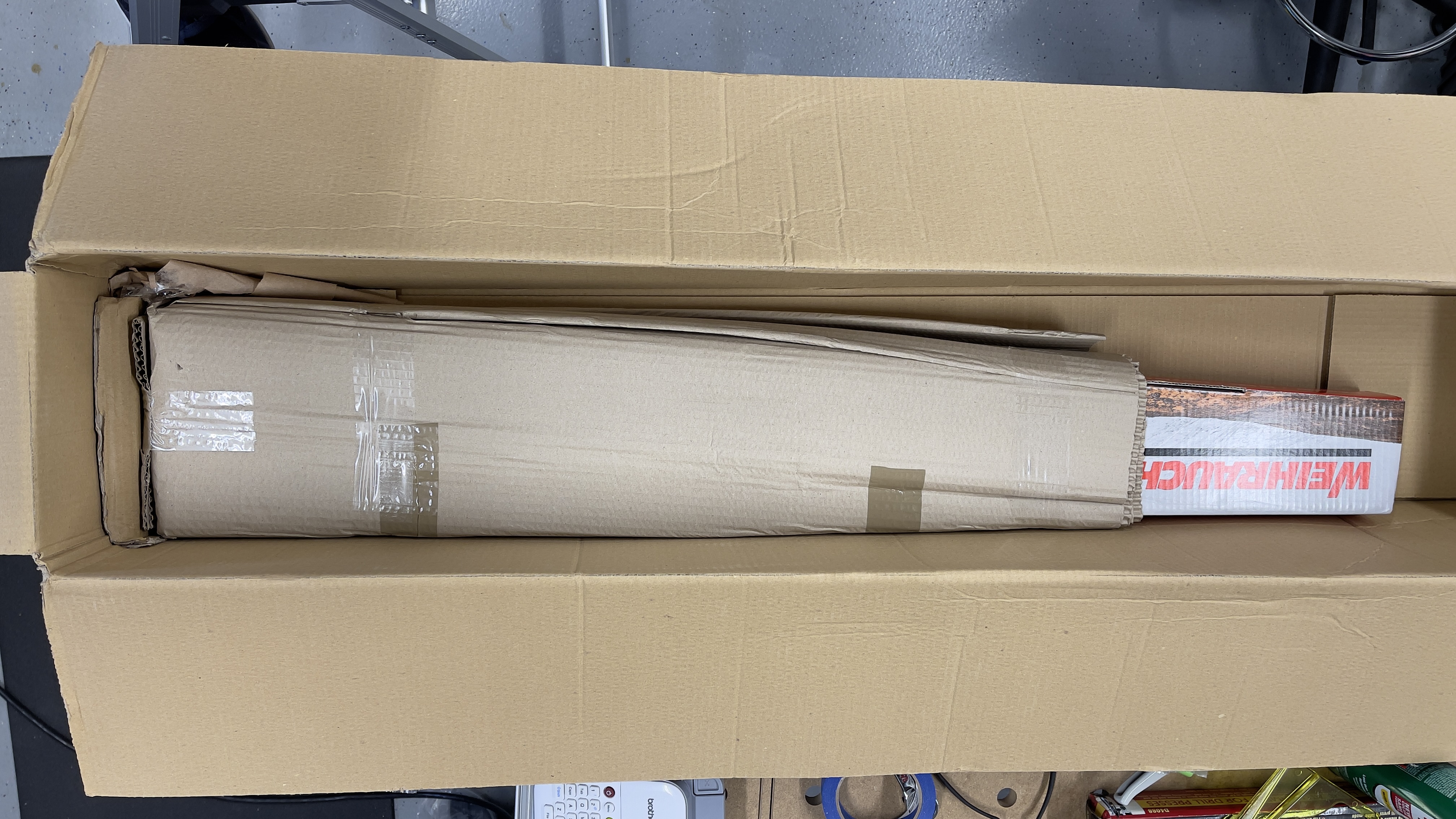

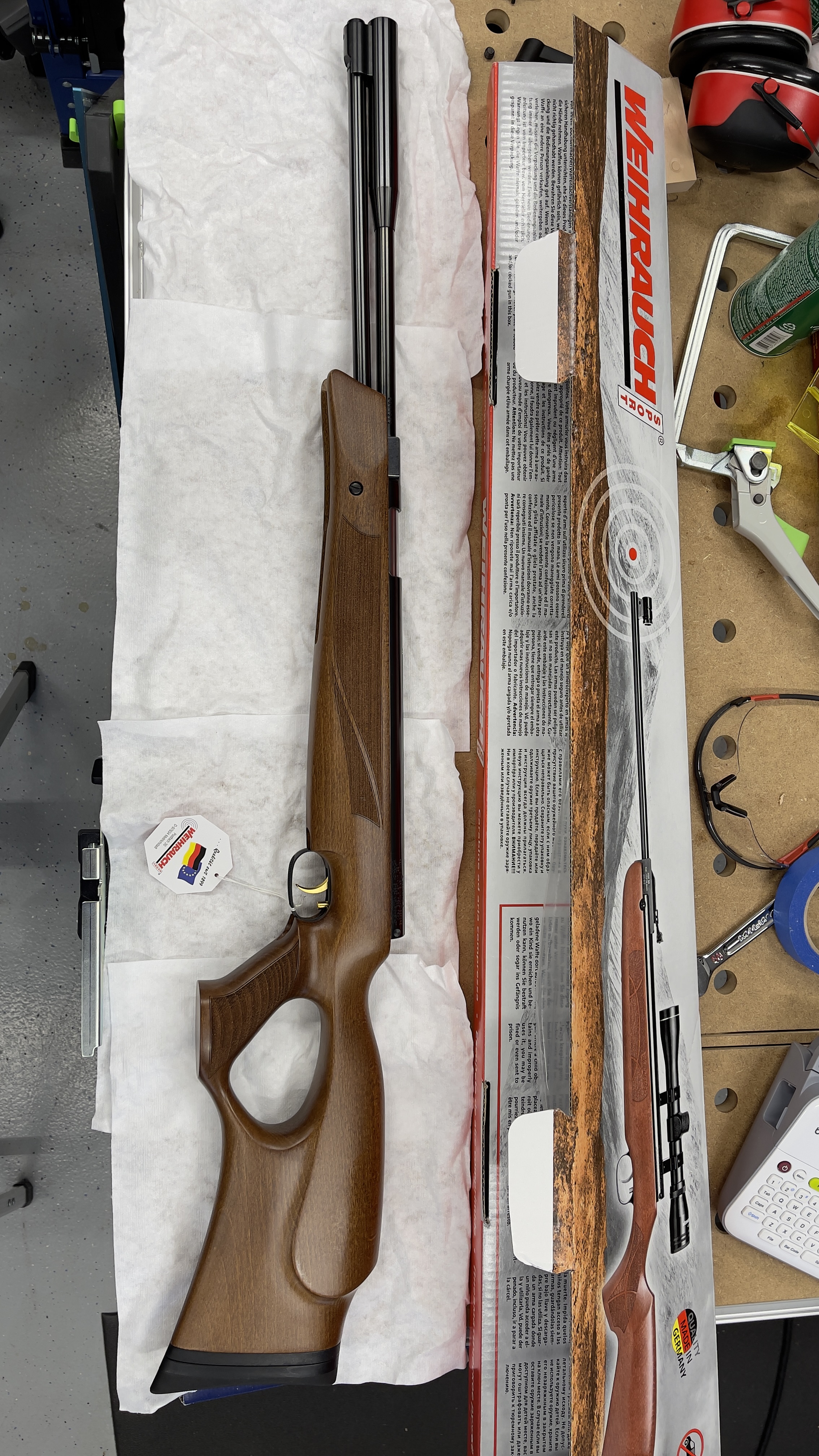

She arrived! From Mundilar. Ordered Sunday, here in California on Friday. Outstanding shipping, gun was traveling through Denmark yesterday afternoon and was here by mid-day today. Included some pics below for anyone curious how a Mundilar gun arrives. The extra air pillows/etc are removed from the pic for clarity, but trust me, it was very well done. Arrived with a Gamo gun bag (big one, with scope bump), and Hawke Sidewinder 30 6-24x56 scope. I forgot to request the SR II reticle so ended up with 20x half mil.
This gun arrived with a light oil on the barrels, unlike the FWB Sport. Quick wipe with a microfiber cloth and the bluing really shines through.
HEAVY!!! Shot one in the store but did not recall it being this weighty. Comes in at 4.22kg or 9.3 lbs. , without anything on it but a trigger tag.

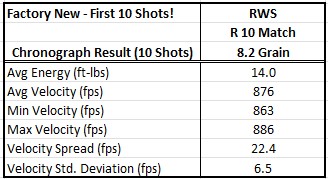

First 10 shots out of the box went through a crhrono. First 8 pellets had a spread of 5fps but I was a little cockeyed on the last two pellets and skewed the data. Still, she's right at 14.0FPE, exactly where I expected it.
Shot cycle OOB: gun is so heavy, recoil is quite muted of course. There's definitely some buzz/twang but it's clearly less than the FWB Sport OOB. Of course this easily outweighs the Sport so no doubt that helps mute some of the mechanical noise. Trigger pull is crisp and nicely adjusted from the factory, pull is 1 lb 6 oz. Will tweak it down slightly later on.

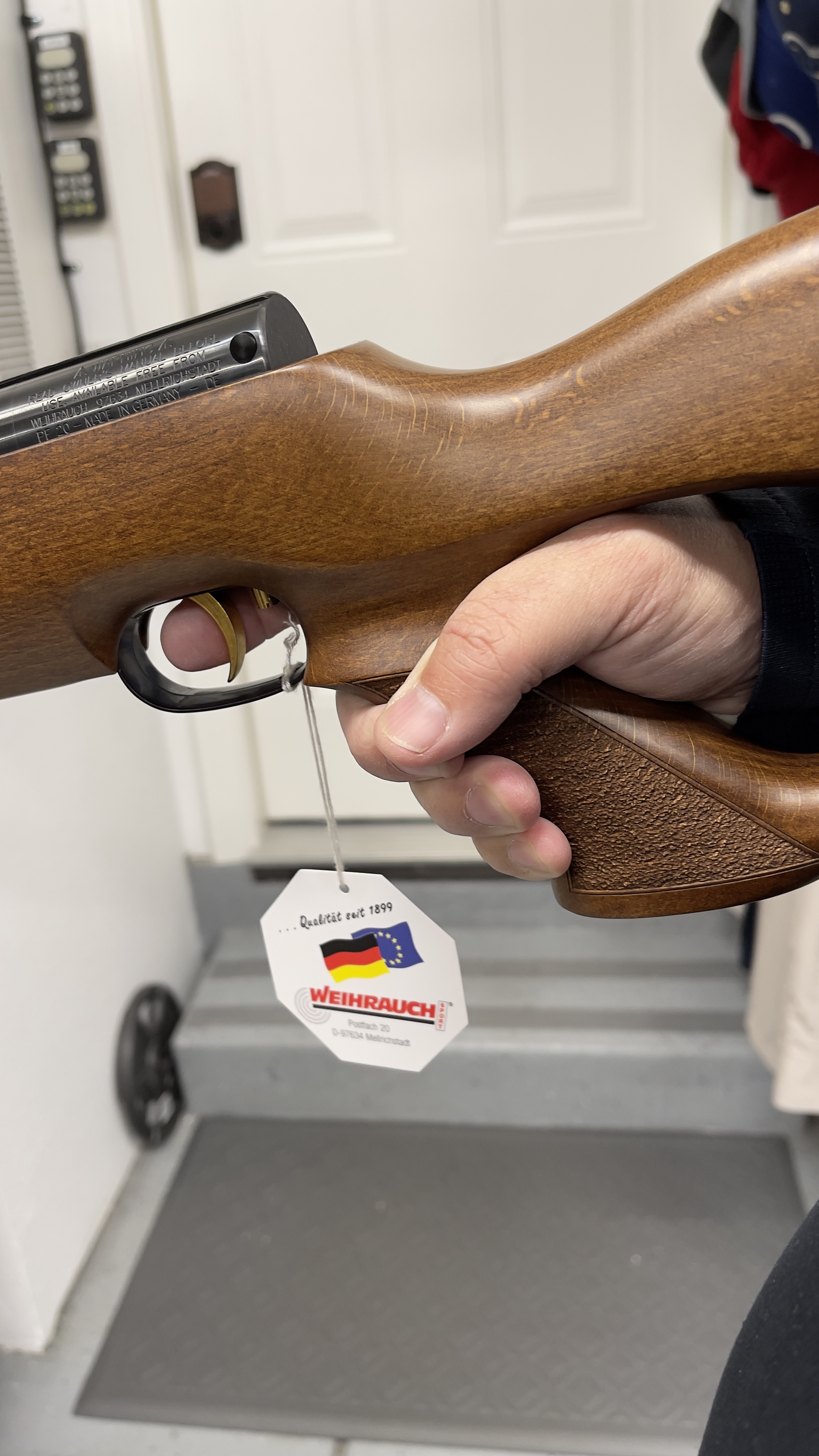

As Scott noted earlier, the thumbhole stock grip isn't too thick, and fits my hands well. I wear size L nitrile gloves. The thumbhole groove is a disaster though. See pic of my right hand. My thumb wants to ride down, I couldn't use that groove if I wanted to. And no straight-up thumb option either, at least not for my hand size. The forearm is beefy, but pretty much any HW97 forearm will be in order to shroud that massive receiver. It's comfortable, but fat. Overall, ergonomically I would give this stock 3.5 stars - fit and finish are first-rate, adjustable buttplate is nice, and checkering feels very solid. But the thumbhole design is goofy, and I do wonder how well that thin bottom bridge-piece of wood will hold up over time.
Other ergonomics: push the cocking lever button, nothing... Have to pull the lever downward. I expect this to loosen up with time, and think I read somewhere the detent can be adjusted (?). Cocking force is not bad at all. Breech - fantastic! Easy to load from either side, barrel breech extends into the well to make it very easy to locate, and tons of room around the breech for your fingers. Safety - you all know it, kind of a PITA. Yes I'll get used to it, but it's not the safety feature that's objectionable - rather, it's just friggin' awkward to reach over to the upper left side to disengage it. Can't reach it with my grip hand, so have to either use left hand or pull my grip hand away to push the button. Not a fan - although it functions smoothly. Overall mechanics ergonomic rating - 4 stars.
Overall fit and finish, and packaging rating - 5 stars. Not a mark on it, and once the shipping oil is removed the bluing is nearly perfect. Definitely better than the FWB Sport. I won't hesitate to purchase from Mundilar in the future. By the way, for USA customers they will refund the VAT. I added a note to the order with that request, and received an email the day after the order confirming the refund. Easy peasy.
