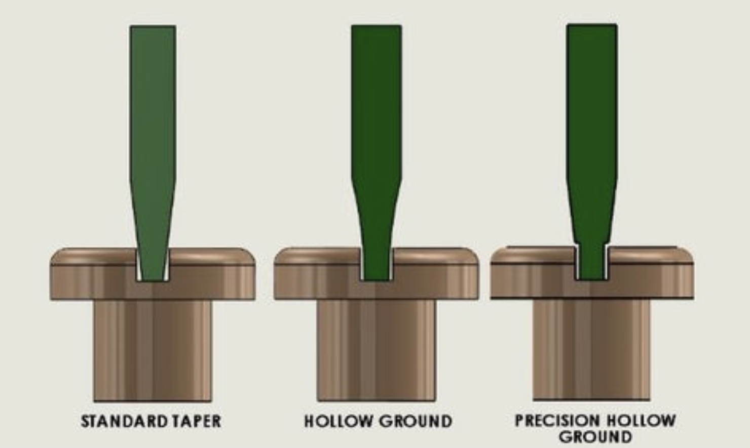

The most important thing was mentioned. Use the correct screwdriver. Hollow ground. Else damage will occur. Borrowed picture.
