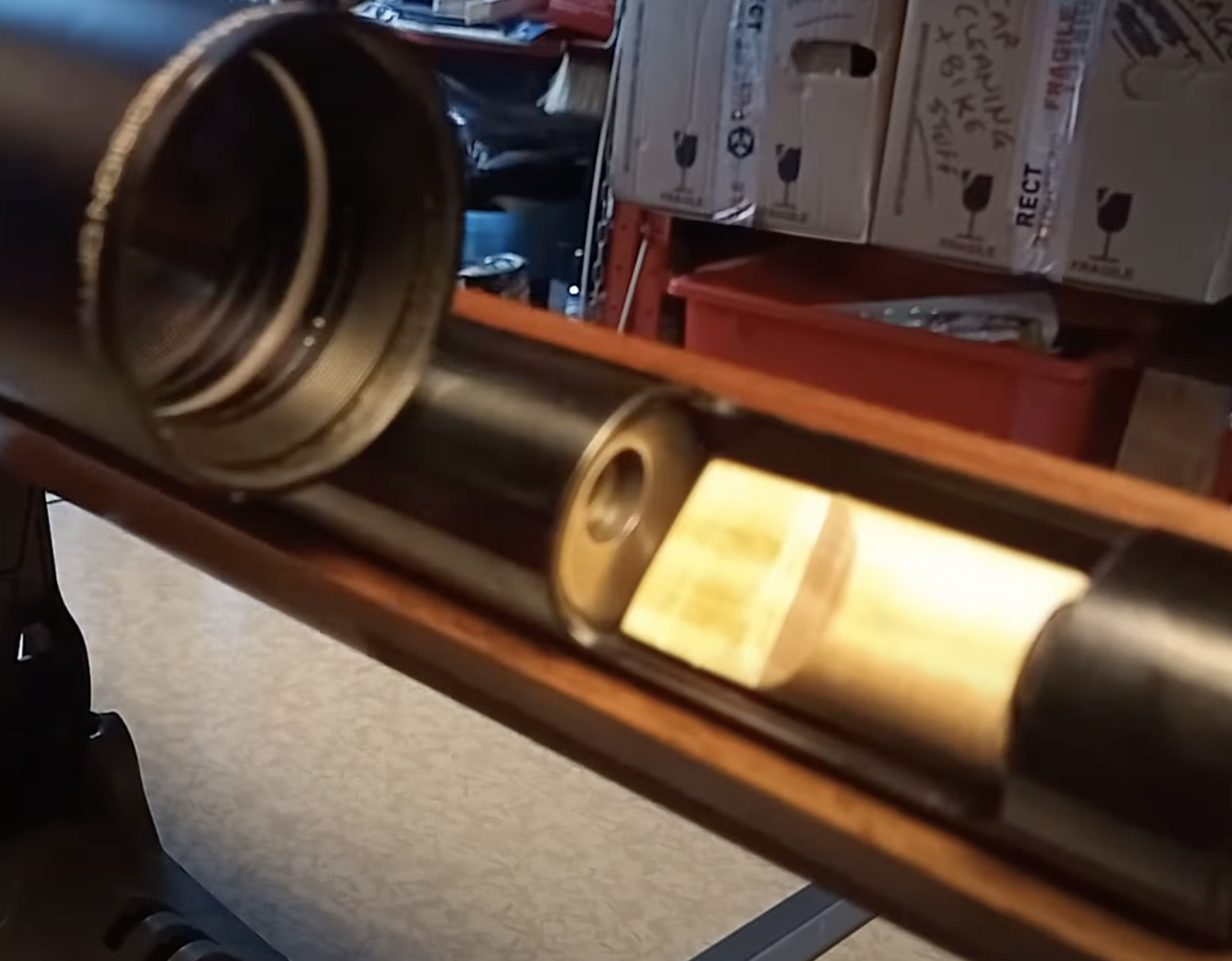

Since the HW97 does not have a "beartrap," is there a safe way to have the action open and cocked while cleaning the barrel? It seems at least questionable to me to rely on the trigger sear to hold all of the spring pressure while cleaning the barrel, without a backup like a beartrap. Any ideas? Block of wood? Not only for the safety of your thumb or fingers, but also to keep from damaging the rifle should the sear let go.

A shim block of some kind is likely the only way.

You have to open the action to use a pull through like the Patchworm. I trust the beartrap mechanism enough on my Walther LGU and Diana 54 to keep the action open while using the Patchworm. I am thinking about making a piece of Delrin that would allow the action to be open on my 97 while threading the patchworm into the chamber and barrel.

How about a piece of pvc pipe cut to fit in the open breach, Possibly a slot to reach into it to retrieve a patch.

As @EquivalentDelta noted, a finger protector shim cut from a piece of broomstick, by example, is a good bet :)
