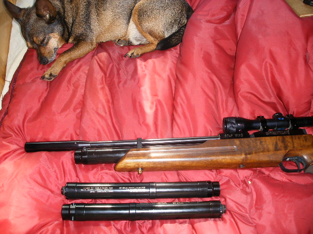

Hrer's a carbine in 22.I think its about 10 or 13 years old?Its a tacker' 28 t0 30 on a fill.
I just received mine yesterday from AoA. I was surprised that it came with the 175cc tube.
Mine arrived shooting around 25.5 fpe with 18.1gr FX & AA(JSB), and I tweaked it up to 27 fpe just to have it shooting over 800 fps. I am getting 28-30 shots per fill.
