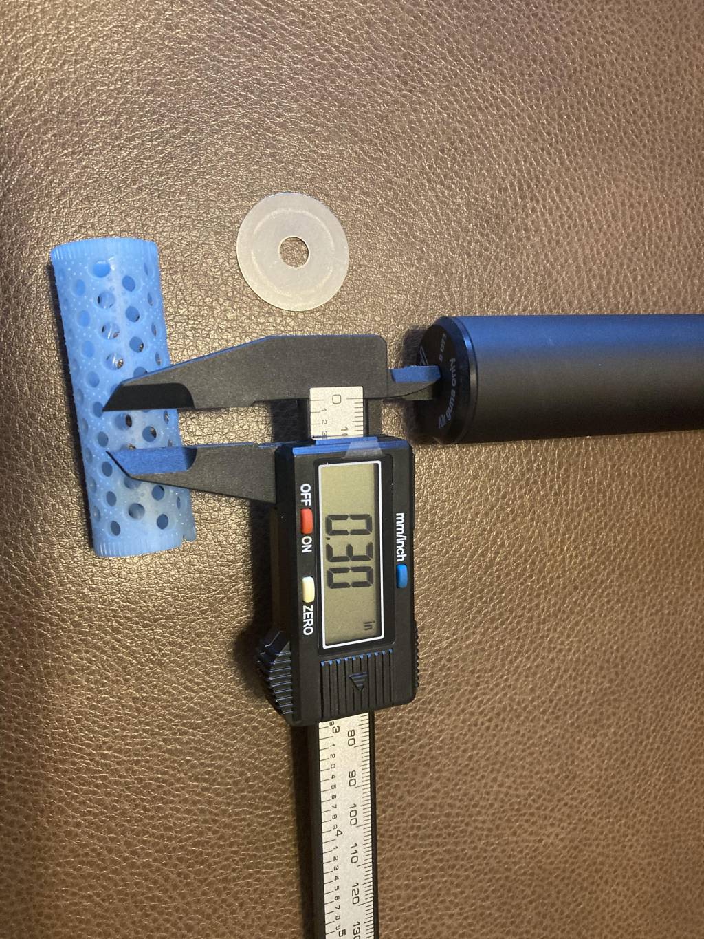

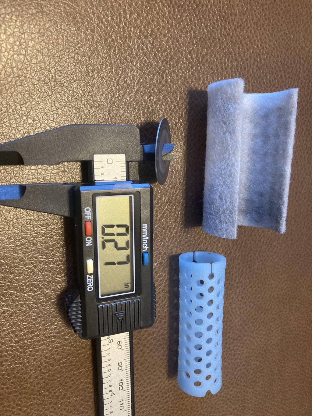

Hey all — my HW100 carbine bullpup showed up from AOA today and I would like to put a DonnyFL on it. I have a Ronin on my Concept Lite and it is mouse fart quiet. The HW100 moderator is more like a “slap-PUTT-ppft-PIIiing” (to use an onomatopoeia) sound and can be heard at a small distance. Anyone know of an adapter? The HW100 looks like plastic baffles with some scrubby pads inside — “hair curlers and washers” Caliber on the exit hole looks like .25 or .30.

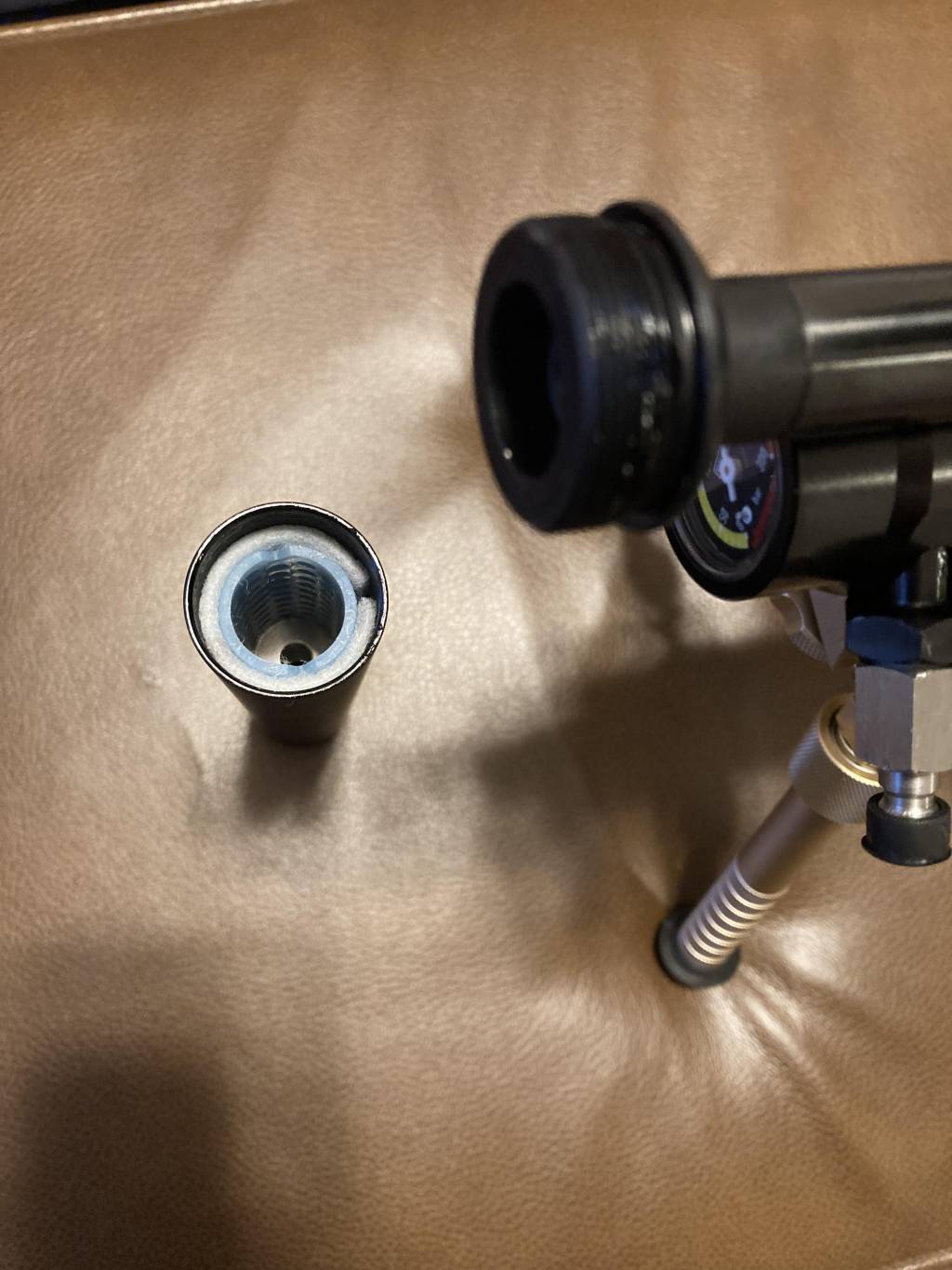

Thanks for your post Mike, everywhere I read, folks are talking about how great this suppressor is. Maybe it's just me but it seems much louder than what I am used to hearing. Oh well, I've removed the glue with acetone so I can at least disassemble the moderator for cleaning. I'm not 100% certain how to get the remaining part off the barrel unless perhaps I heat it. I guess I'll leave well enough alone and just enjoy the HW100 BPC without getting too far in the weeds around sound suppression. I'm a big fan of DonnyFL and was thinking perhaps a Koi would be nice on the HW100 BPC.

Yes, the silencer base is bonded to the barrel. I've had three of these rifles, and had to heat all of them with a torch to get the thing off. Regarding the performance of the Weihrauch moderator and the Donny, all I can say, my experience is different than mentioned above. I compared the HW with both the Donny Sumo and Tanto, and I found the Weihrauch to be the best, at least in my perception, but all were similar and very acceptable.

I tried heating it and removing it with a butane torch and was unable to get it to turn maybe more than a 1/16 of a twist. Could not tell if I were actually turning it at all or if it were the silicone grip slipping. This puppy is on very tight to the point that I suspect I would need to use a strap wrench to get it off. It seems to have some type of black/rubbery glue applied. It's a matte finish and doesn't look like RTV. Seeing as how I gave it 3 tries I think I'm going to quit while I am ahead -- especially based on the feedback here. I might be chasing a "problem" that doesn't even exist.
Just sent .22 14.3gr CPD down range and 14 of 14 at POA. Nice little rifle and quite accurate. I'm afraid if I apply any more force I'm going to be rotating the barrel inside the action itself or tearing stuff up. It's only 2 days old anyways. I put the "golden screwdriver" away for now :)
It'll come off, I promise. When the glue melts, it screws right off. But it takes a lot of heat, and you might discolor the bluing slightly on the metal end cap.

Yeah I figured I didn't put enough heat on it but at the same time I'm just going to leave it be I guess. It's not that I'm disappointed so much as I guess I'm used to the Concept Lite with the shroud and DonnyFL. Wonderful little rifle and I figured some hair curlers, a few washers, and some padding was a bit "meh" compared to the machined core and metal screen with padding seen in the DonnyFLs.
