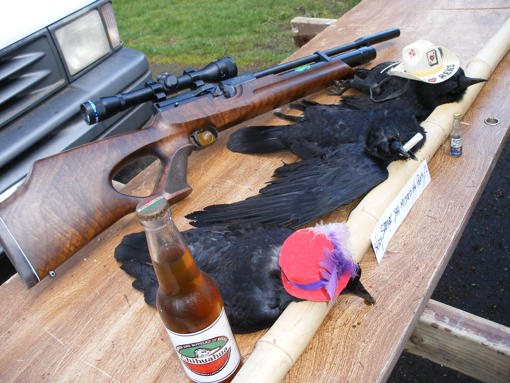

The HW100 is like the first VW tried and true, like the PO8 ya can't improve on them" dont forget 14 shot in the 22. Not many doing that now?Need i say more"
