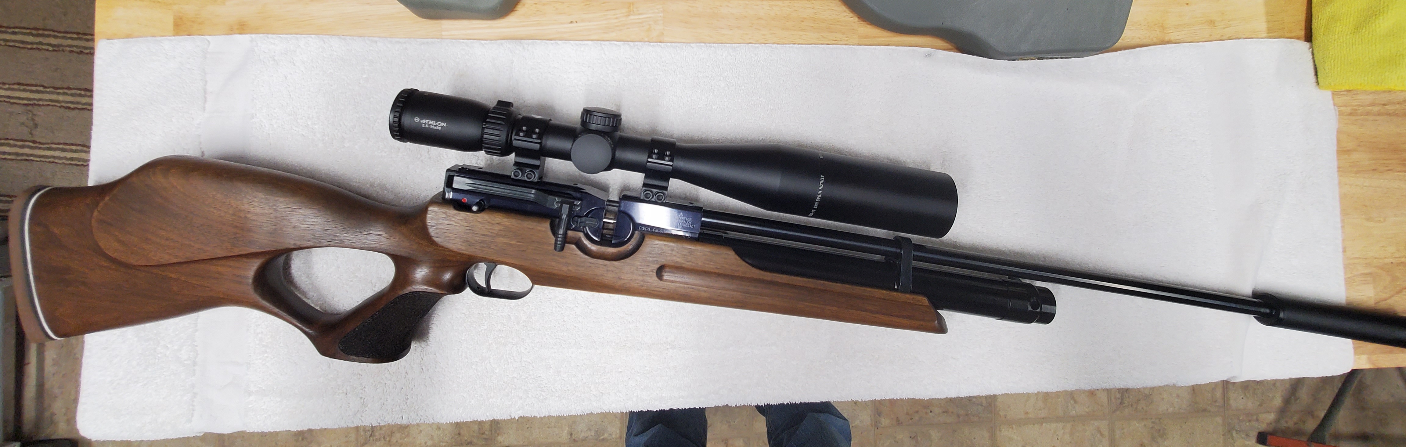

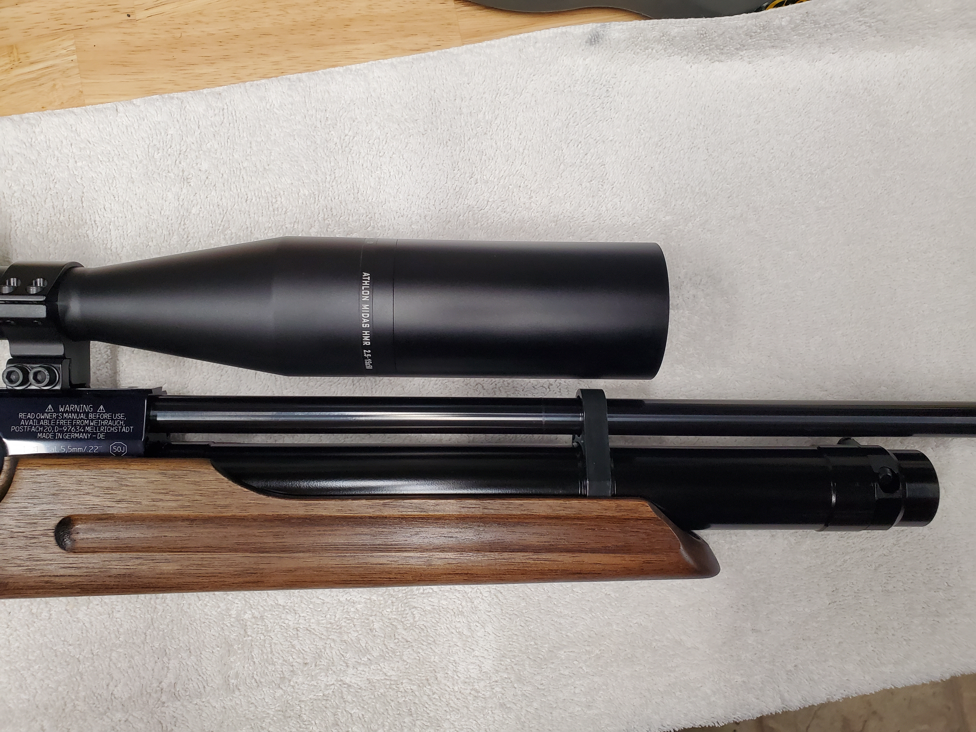

Finally got my rifle back from AOA yesterday. It passed visual inspection and the barrel band to air cylinder alignment is now correct.
Scope has been mounted and all that remains now is to test it out. Will report back when I've had a chance to zero the scope and chronograph it.

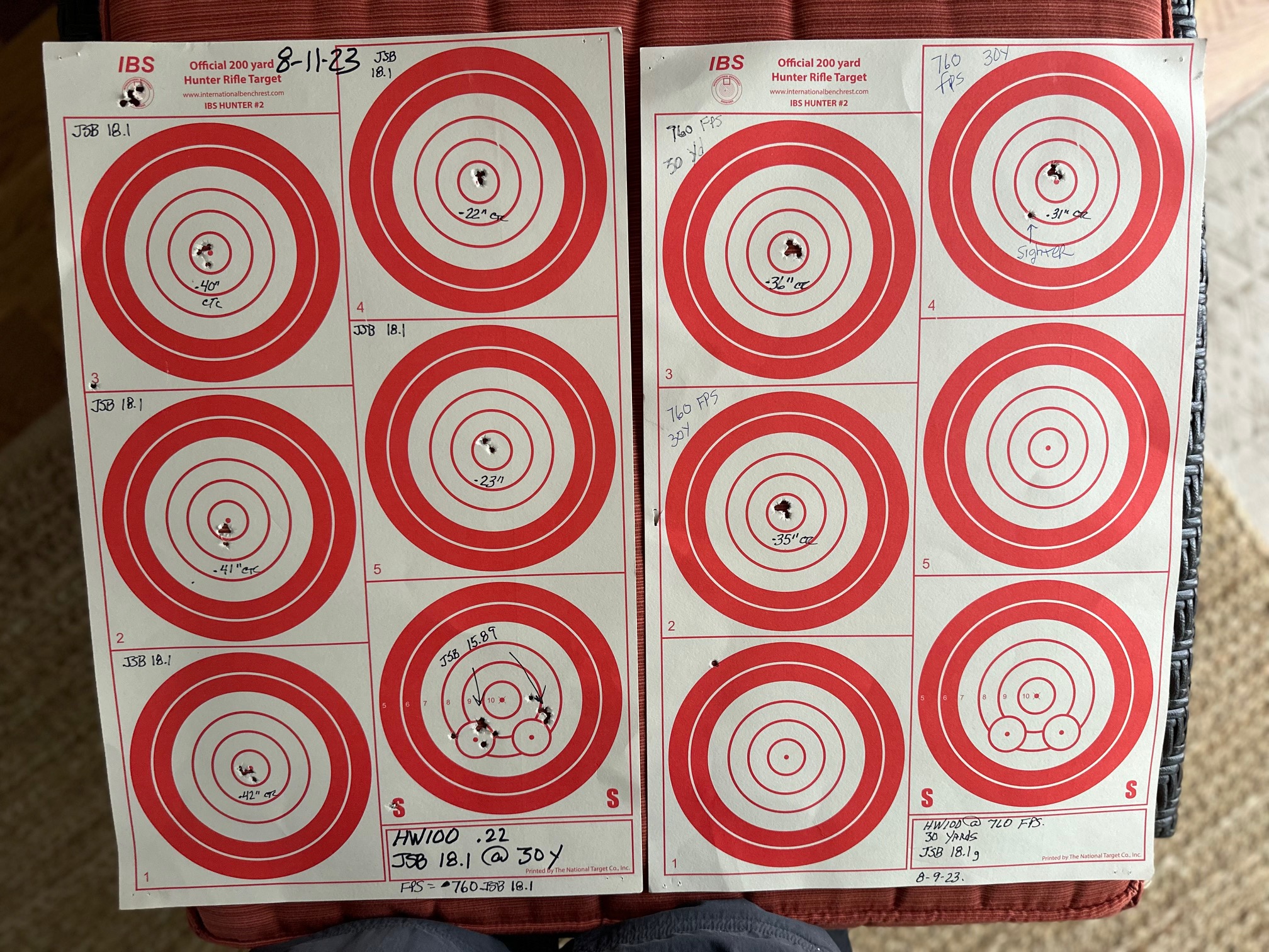

I shot some groups today at 30Y, at my outdoor range. Wind was 3-5 mph, had one near flag out just to check direction.
All of these were primarily 5-shot groups at 30 yards, with the JSB 18.1 pellets.
As mentioned previously, I think I saved some of my previous 30 yard groups when the rifle was @ 850 FPS. But, as I recall, there was not much difference at 30 yards. Said another way, the squirrels will be DRT with any of these groups out to 30-40 yards; contingent on careful shot placement. :)
