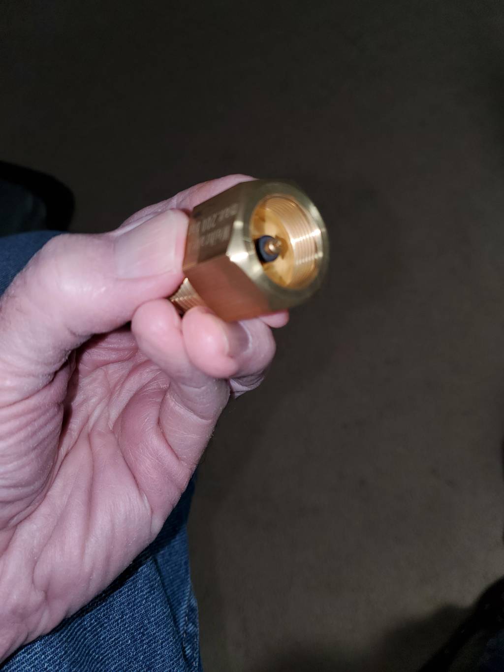

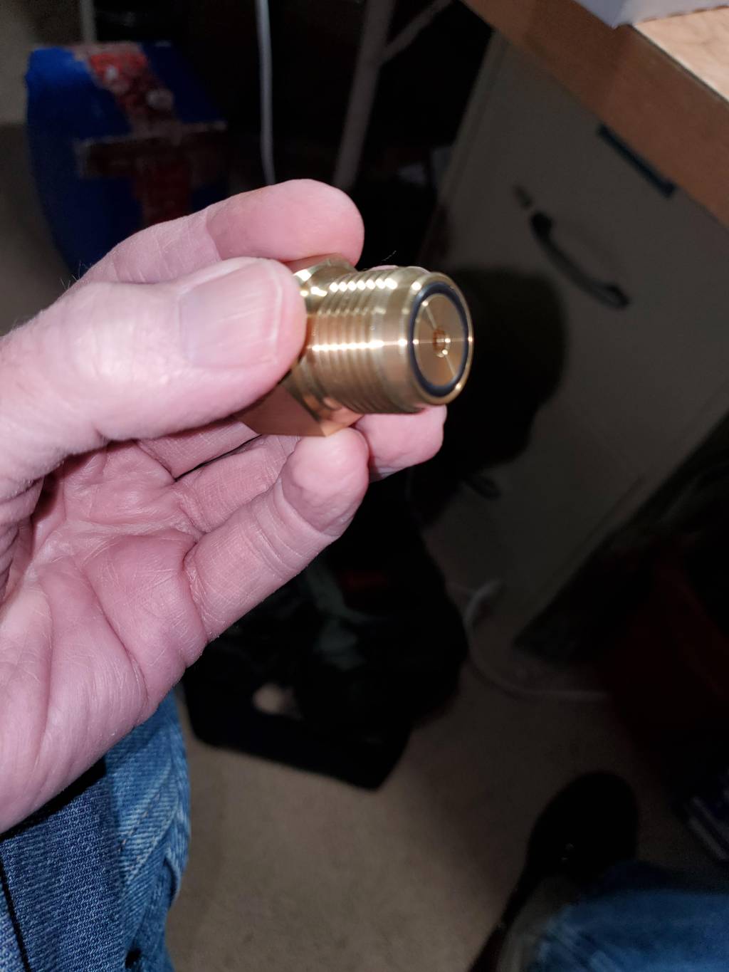

No, not tethering it. I have 2 HW100 rifles, and occasionally I will fill one cylinder while off the rifle. Obviously, I can do that by using the standard fill probe, just as I would when the cylinder is on the rifle. But the pictured fitting is designed to attach to the cylinder, and fill from the tank. But, that fitting does not fit my tank, the O ring position is wrong, and it doesn't screw in deep enough. I have a couple of adapters as others have shown, they will not work this fitting.
The reason these adapters are not working for me is due to the yoke design on my 4500 psi tank. It is deeper than "standard", so I need a longer insert, if one exists. But I'm not going to spend any more time on it. As I mentioned, I can always use the probe, even with the cylinder off the rifle, so it's no big deal. But thanks for all the responses.
