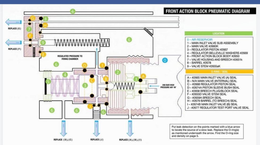

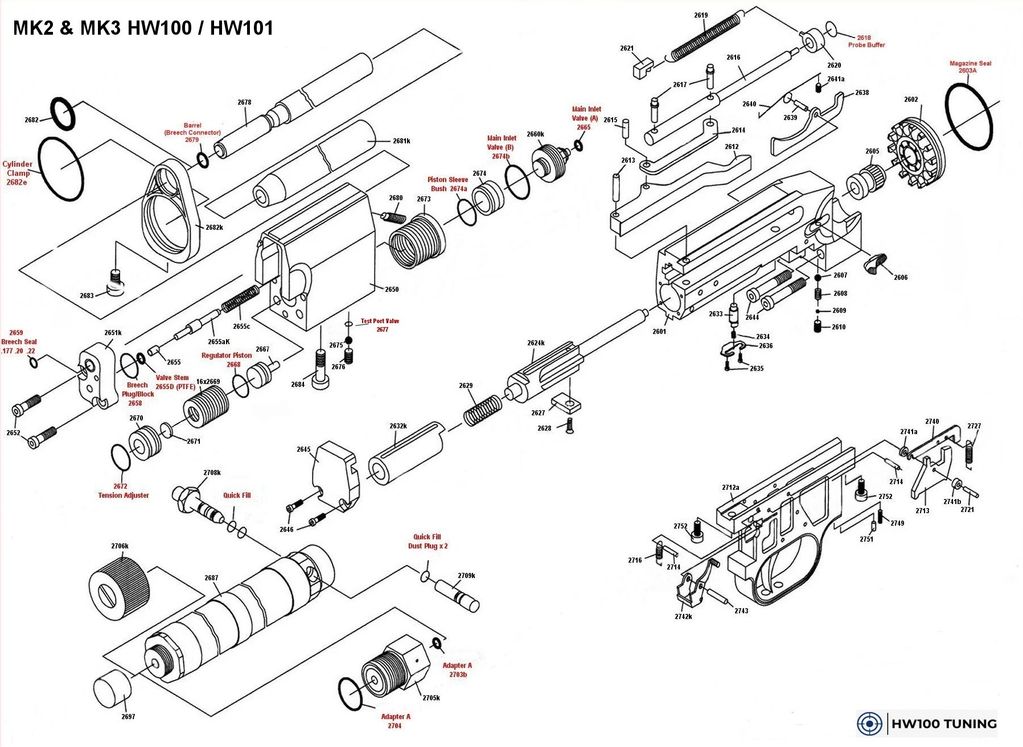

Tes 12x1 works best thereYes ... that O-ring at OEM spec is severely crushed and taken to a state of FUBAR !!!
Chased that for a couple rifles years back figuring out a slightly smaller O-ring behind the probe thimble housing made a huge gain in leaklessness![]()
