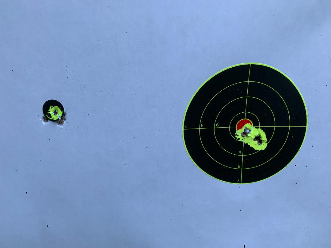

To clean the barrel, I use a drink straw as a guide as it fits through the moderator to the barrel. I use a line with loop at the end to pull a cleaning patch from breech to muzzle. The line is nylon with some stiffness so it works great. Note that I have the .22 cal modelReceived the gun a few hours ago , This Is not a review just first Impressions ....Pros - beautiful stock handles really well , awesome trigger straight out of the box , very quiet , accuracy @ 60 yards outstanding no wind using AEA 18G pellets @ 960 FPS , fit and finish top notch ... Cons - It docent look like I can unscrew the moderator my patch werk wasn't long enough to be able to clean the barrel that Is a looooong barrel , fill prob , 200 bar fill only gets me two mags 28 shots I'm wondering If I can get a longer air cylinder . So nothing major but worth mentioning . So all In all I'm well pleased with the overall performance just wish I could get more shots out of It .
Five shot groups at 60 yards .View attachment 489937View attachment 489938

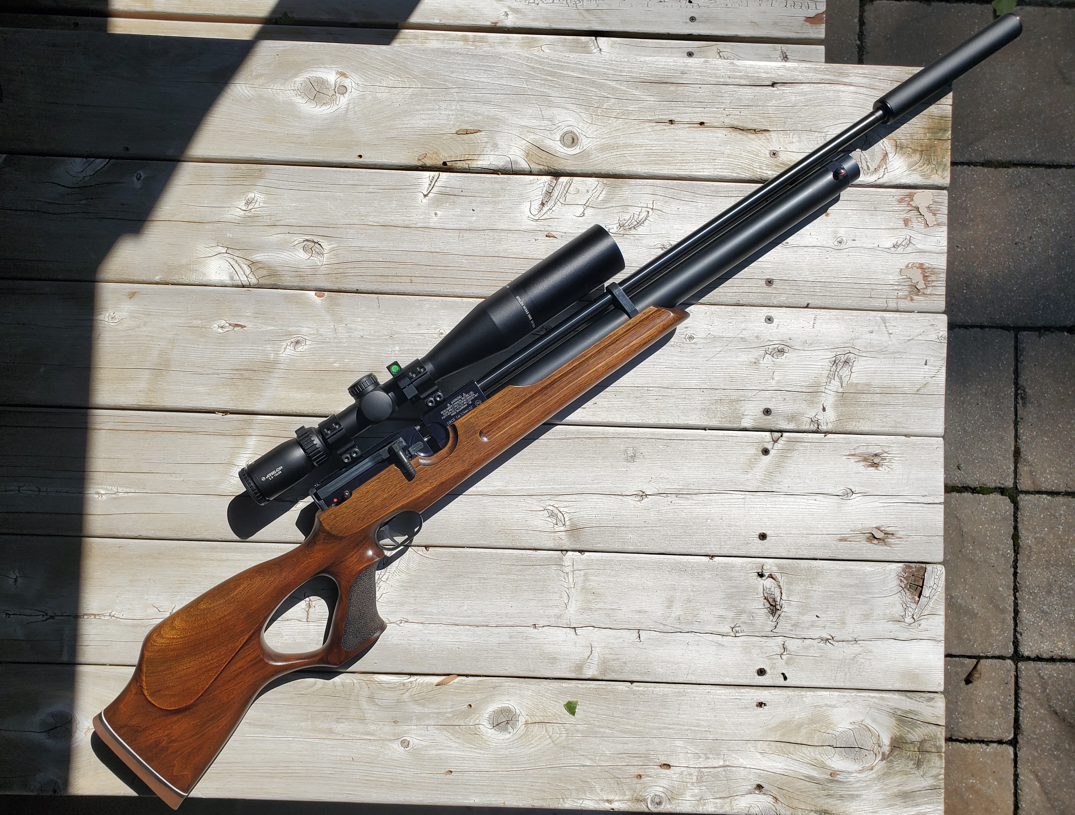

I have the Ratworks FAC XL cylinder on my HW100 T. Thanks to Filnez for pointing me in that direction. Went from like 25 shots to about 48 shots before falling out of regulation. Plus its about 1lb lighter than the stock cylinder.This is the longer one

Yeah that looks a lot better than the oem tube and more shots whats not to like .I have the Ratworks FAC XL cylinder on my HW100 T. Thanks to Filnez for pointing me in that direction. Went from like 25 shots to about 48 shots before falling out of regulation. Plus its about 1lb lighter than the stock cylinder.
That size tube definitely fits the gun better. Much better look with that length barrel.I have the Ratworks FAC XL cylinder on my HW100 T. Thanks to Filnez for pointing me in that direction. Went from like 25 shots to about 48 shots before falling out of regulation. Plus its about 1lb lighter than the stock cylinder.
