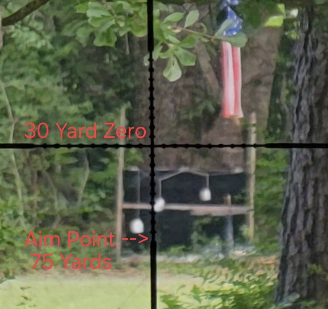

I have a .20 cal 30 that I've been shooting at 75-yards, but not at paper. I've shot shot shells hulls, CO2 carts, medicine bottles hanging on strings, and Air Venturi, Crazy Eights.
Its tough and fun when things click. My biggest challenge turned out to be cant error.
When we zero short, you at 25y, and I'm at 30y, then holdover with mil dots it's easier to understand cant error knowing the pellet is going up to that X and falling way down to your aim Point.

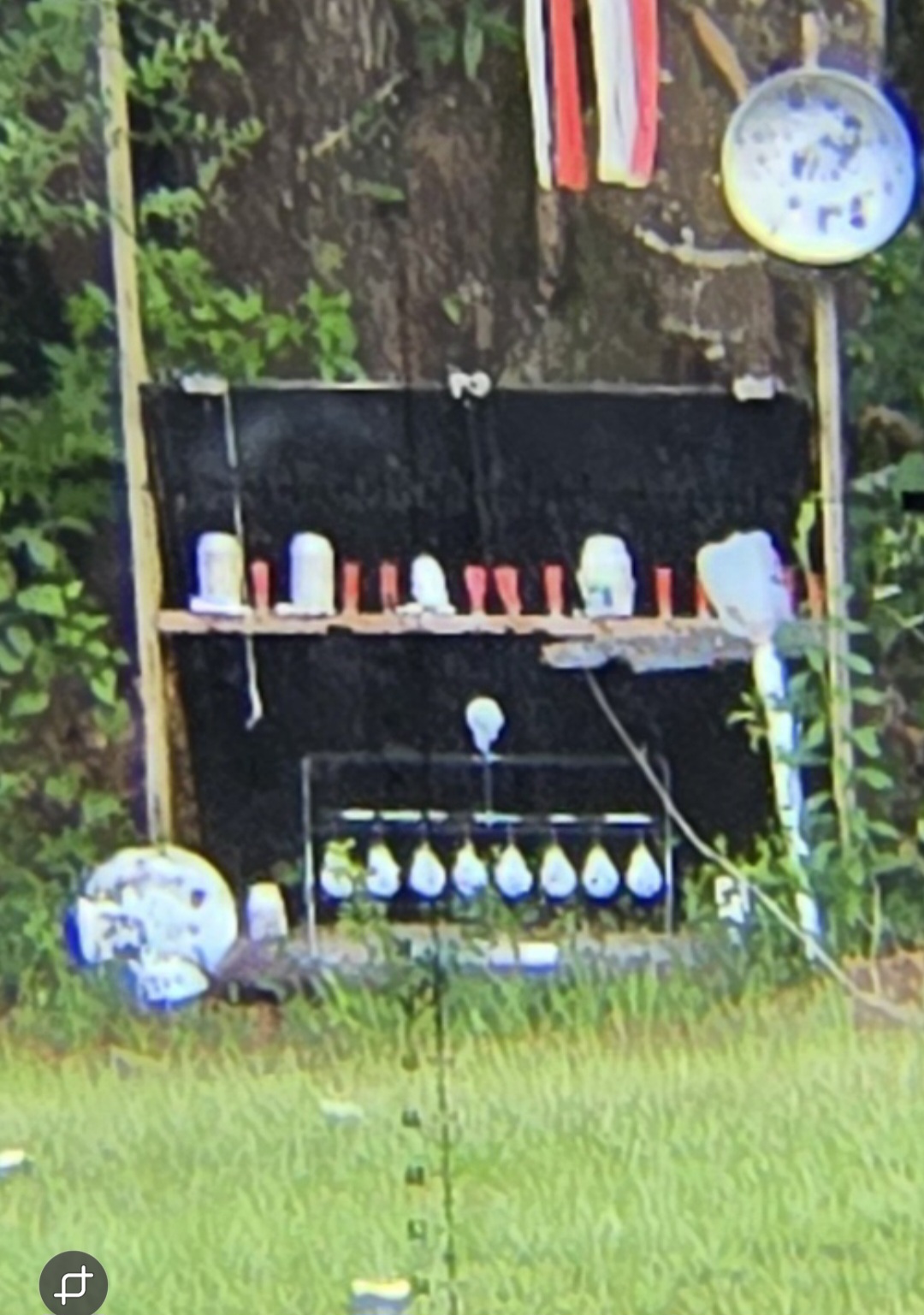

At 75y, the point of impact doesn't come onto the mil dots until I dial down to 4X, then I make small movements of the power to a little past 4X to get the impact on the point of the bottom post. It's probably a thirty inch fall down from the X to the POI at 75y.
Another more recent veiw of the 75-yard array through an Element scope.

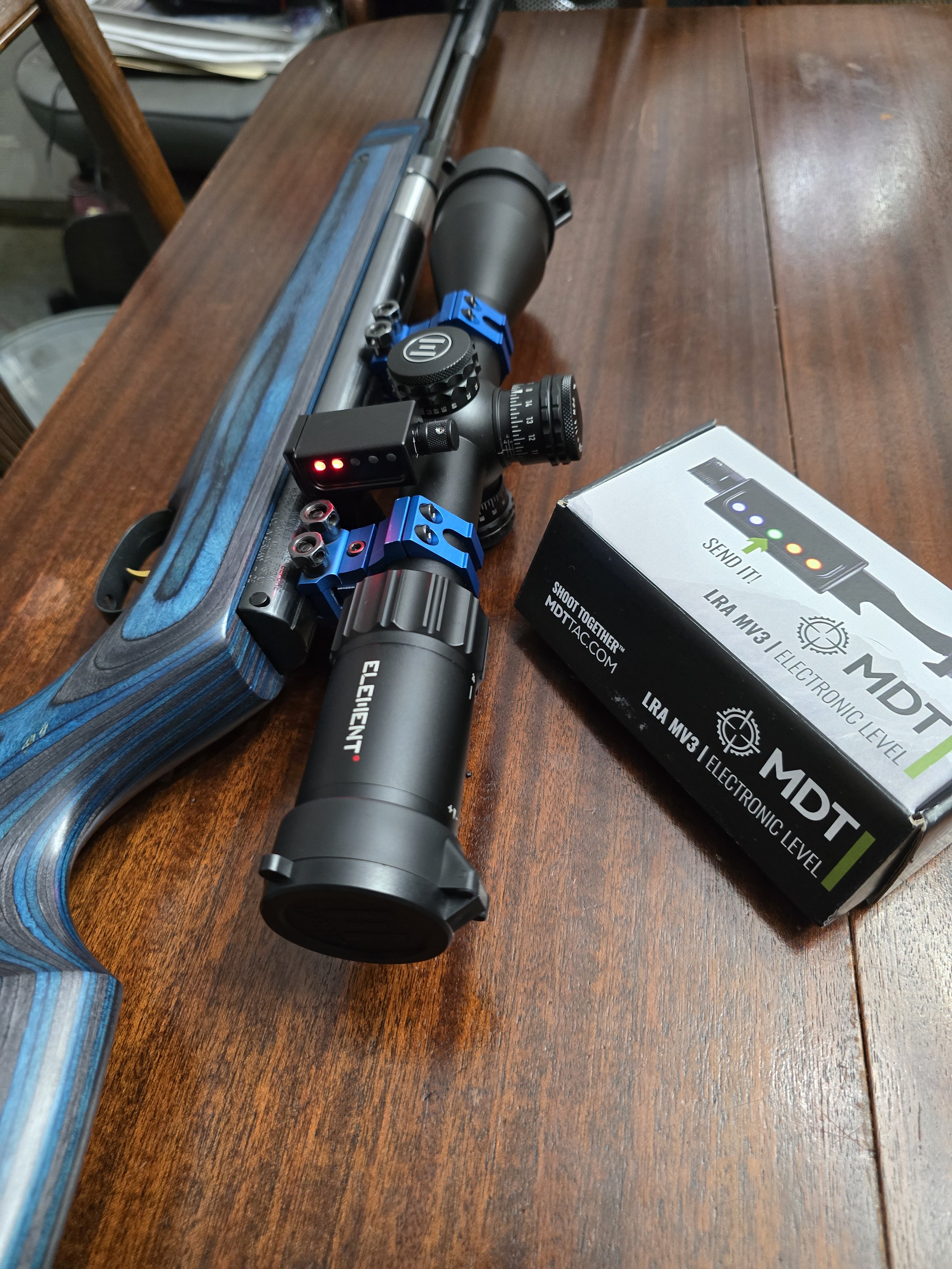

I eventually invested a little into the cant problem and bought this guy, an MTD Send It.
I have all my rifle scopes set to its leval allowing me to move the unit from gun to gun. It gives me a green light to send it, red if I'm canted right, and blue for left.
