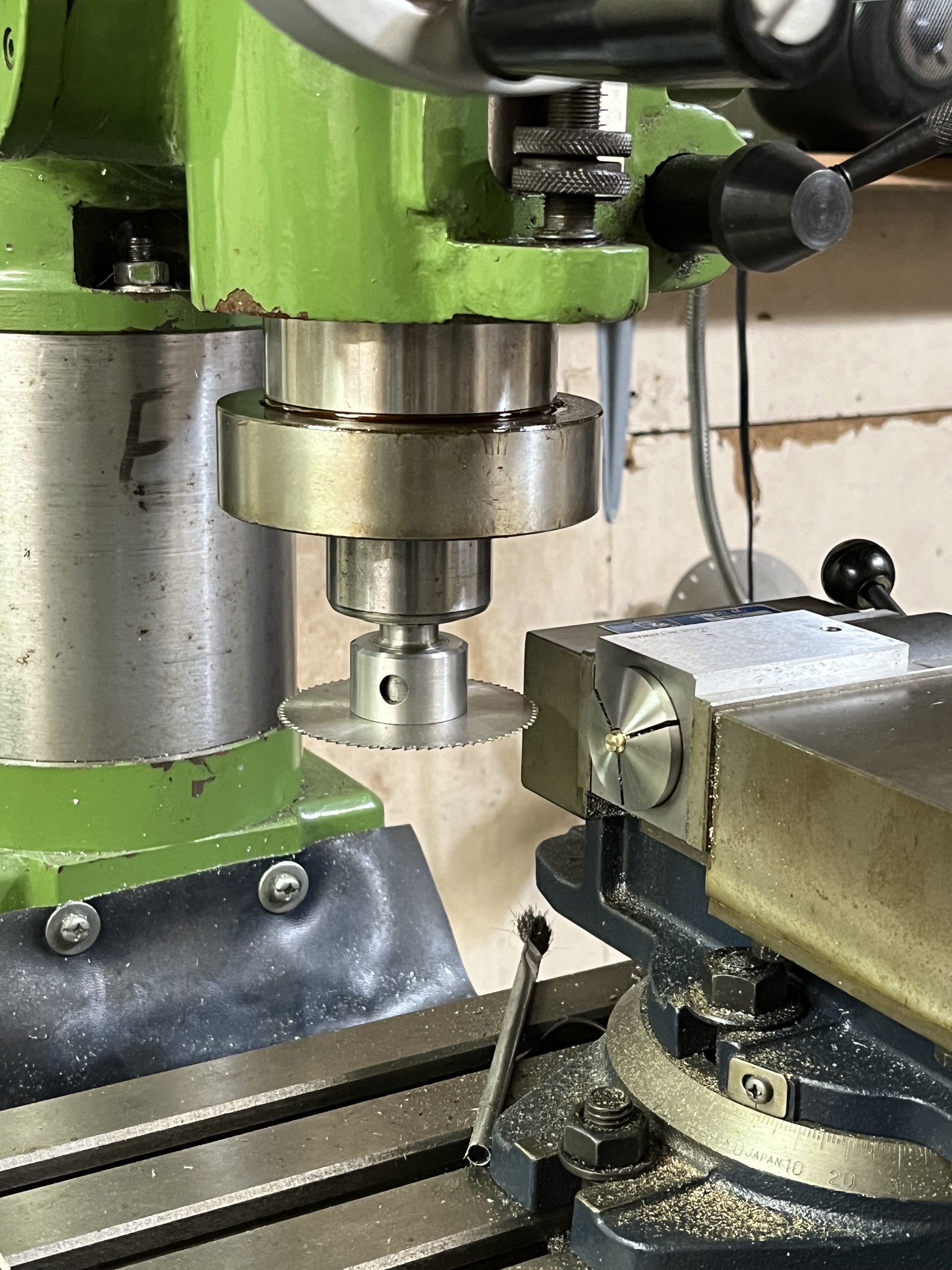

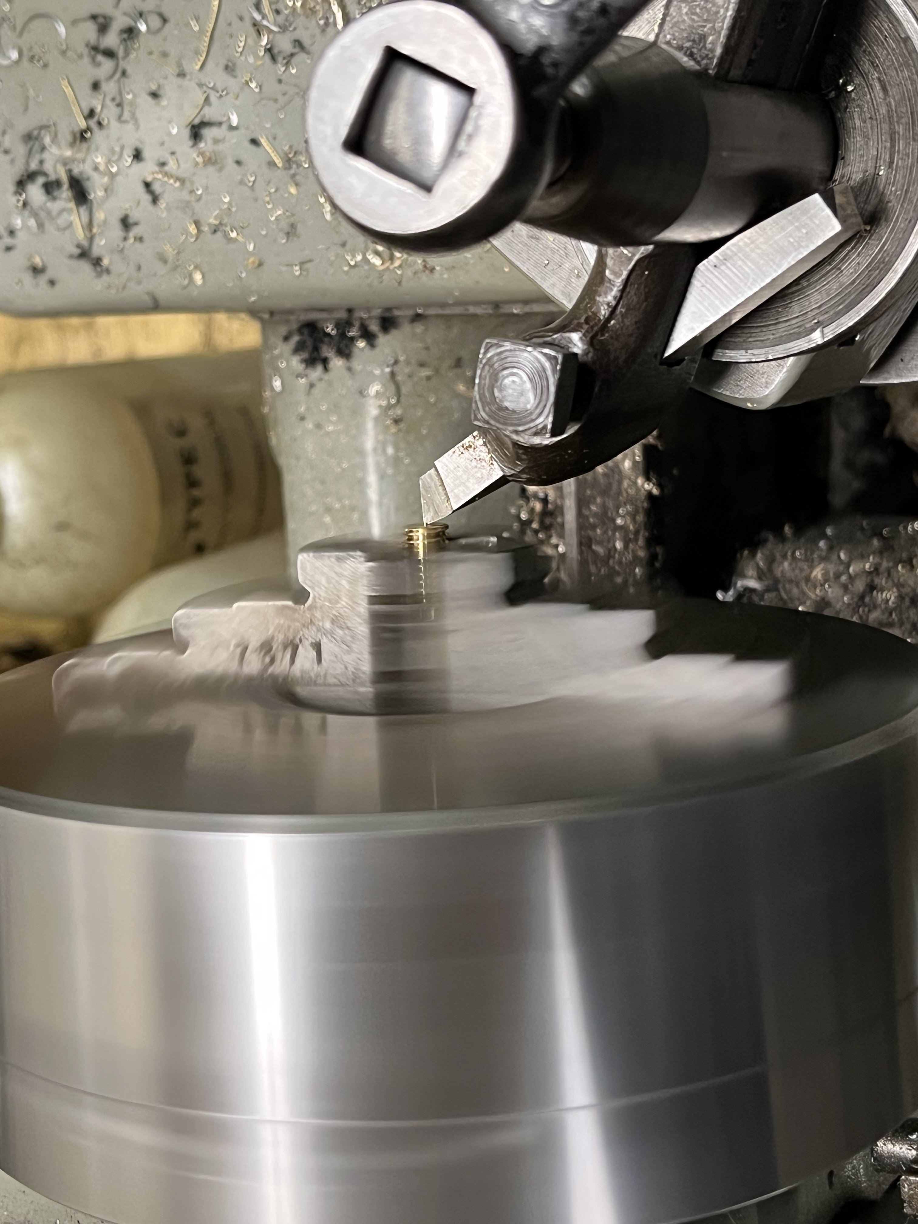

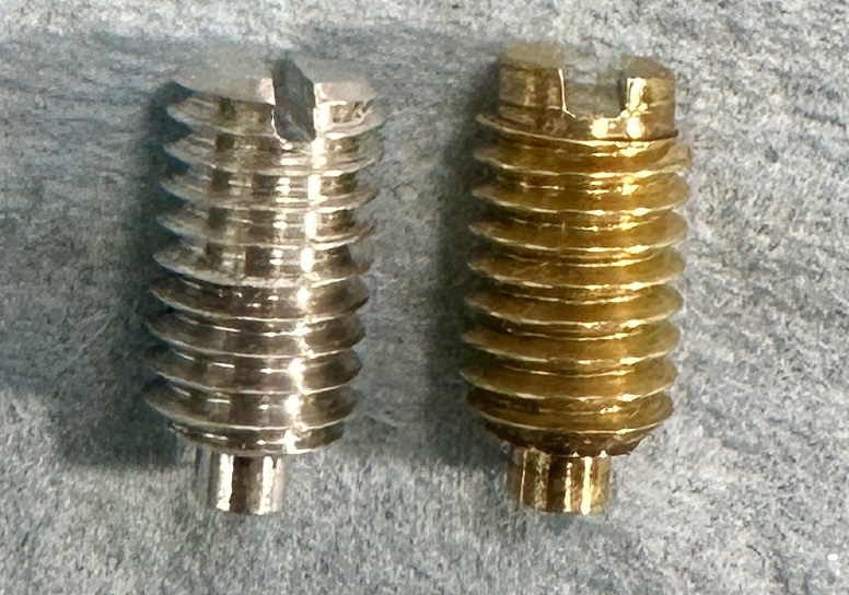

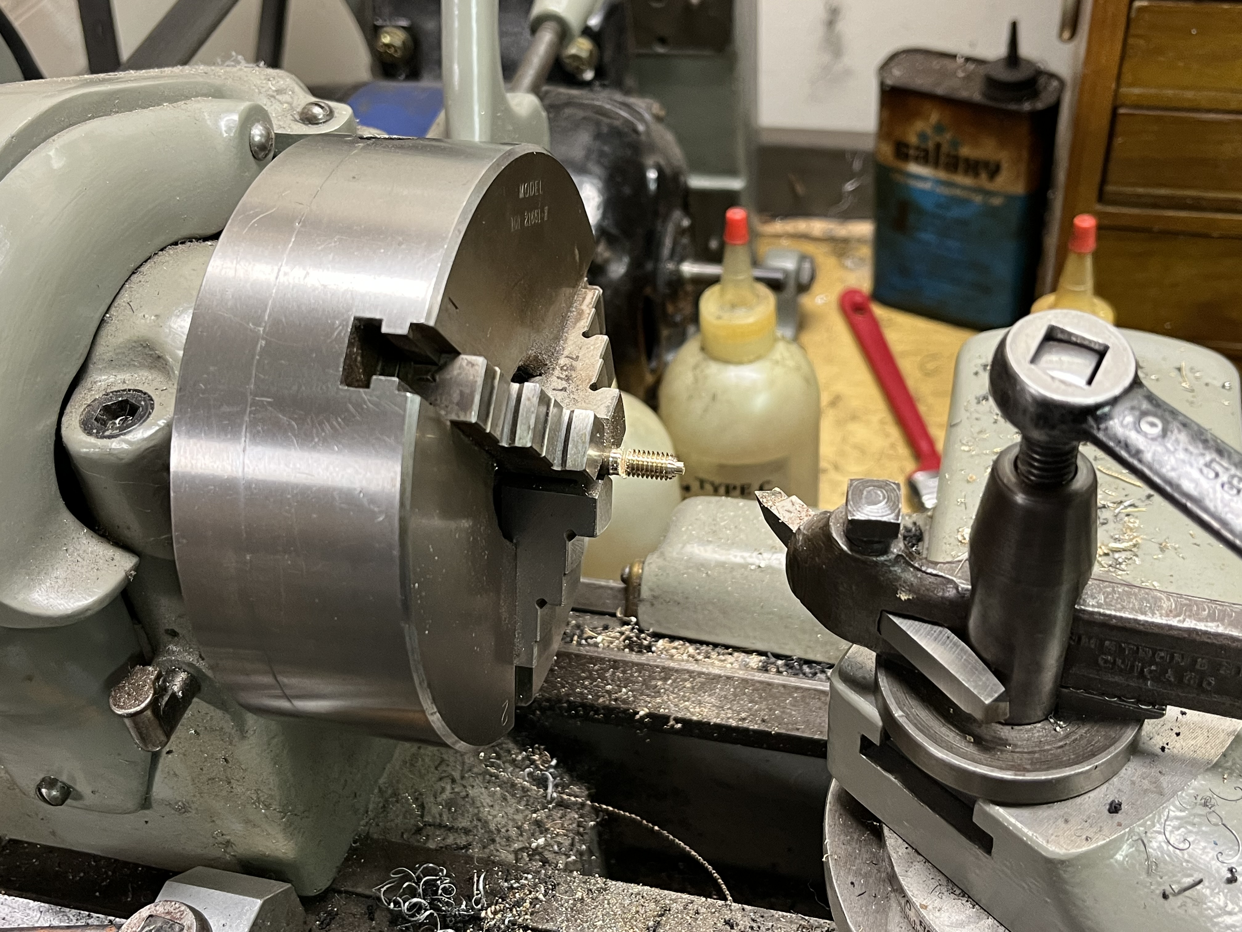

Make a new one?
This replaces a Rowan. They make their slots weird and I made a new one for a guy that buggered his up
I’m not a fan of brass bling. And it turns green.
Easy job. Bust some chips

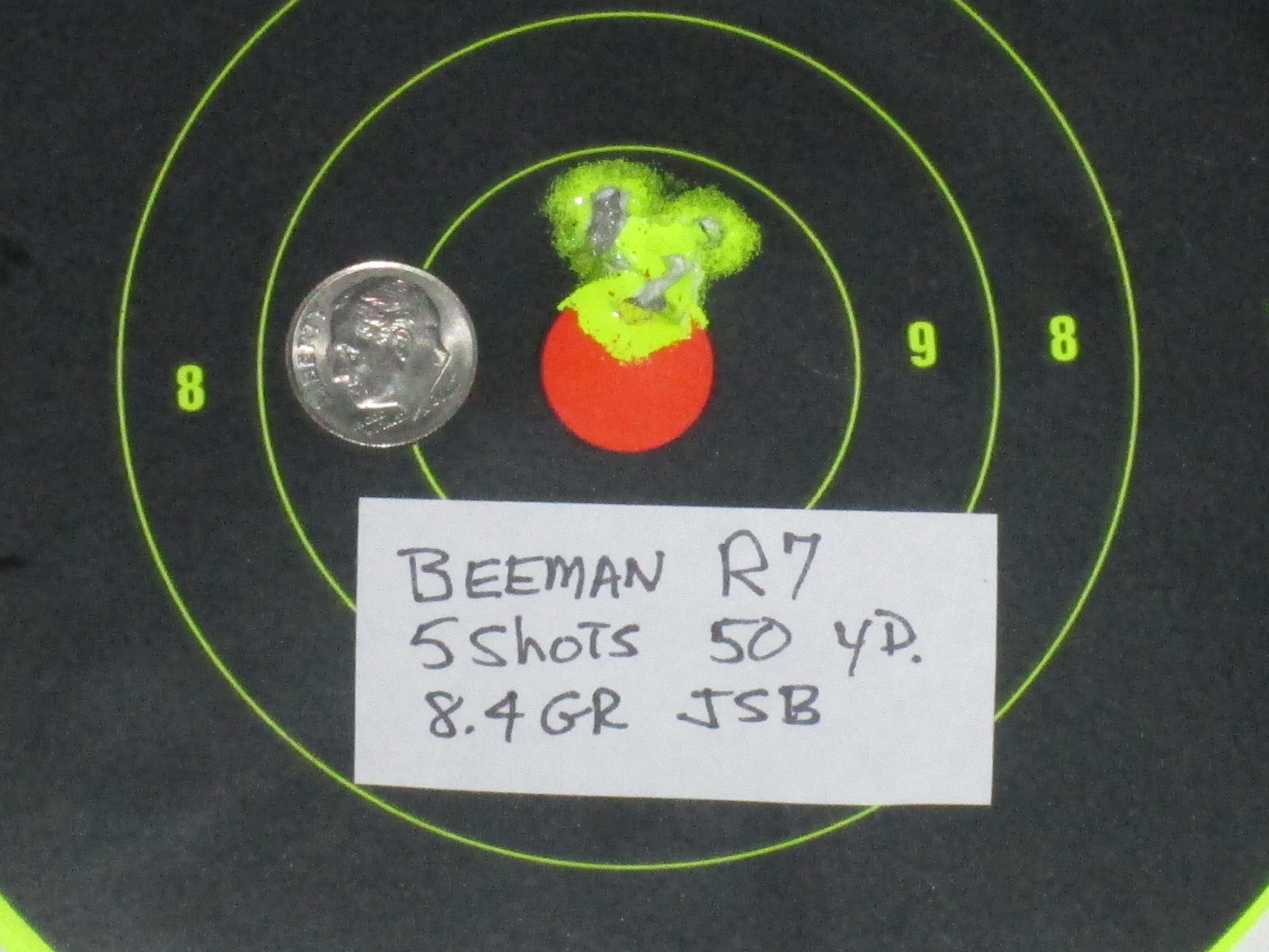

IMO a page of 50 yard 1" groups is very good for any springer. I'd be happy with that from any of mine. Sure I've had half inch groups here and there which is MOA but they might be on a page with a 2" group. IMO consistent 2 MOA is better than a rare 1 MOA.
I'm a proponent of posting full pages of groups because it shows realistic results and not a single possibly lucky group.

Make a new one?

I agree their Rowan screws suck. I'm putting a Rowan trigger in my 30 right now (trigger is completely apart). And their screw is sloppy loose, so I just cut down the factory screw and slotted it by hand with a hack saw. Their slot is really rough lookin, definitely wasn't done on a swiss lathe I don't think. I really need to get a mini mill.

I don't own a HW30 but I know one thing for sure I would not be shooting a less than 1" group at 50 yards! I don't know if I could do that with any lead thrower :unsure:. So IMHO that is some fine shooting 🎯 (y)
Really appreciate that! I have to say it’s an average of 5 bullseyes, 5 shots per. I‘m finding I’m slowly improving as I get more comfortable with shooting a Springer. And I’m really finding an improvement in 25 yard shooting after going long. I don’t get to plink much as I live in a city but our range is only about a 5 minute drive but the range is specifically 25, 50, 100 and 200 yards. Maybe when I get my 97k I’ll have a go at the 100/200 yard ranges. 😂
