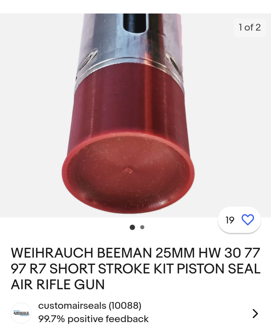

Tuning Hw30 Vortek PG4 + Short Stroke Piston seal
Anyone ever try out this combo?
Gonna try it just for the hell of it.
Just waiting on the piston seal now. Wondering whether it will even be compatible as the vortek spring is shorter than the OEM weihrauch spring.

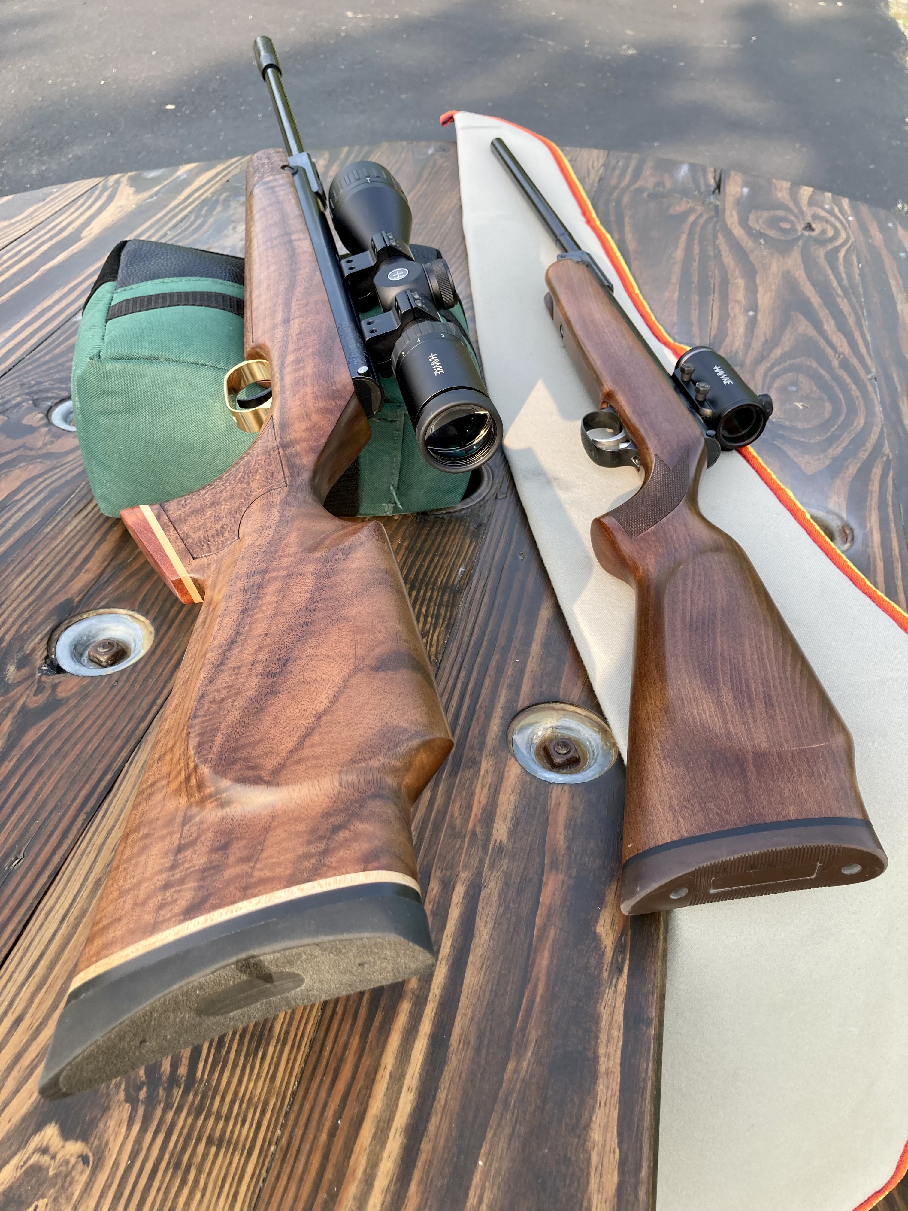

I'm shooting 8.4s right at 600fps with my R7.....totally stock. I've been considering a steel PG-4 HO kit and Vortek seal.
I'll be watching your results.
Edit: I went the short-stroke(extension) direction on my TX200 and was not impressed with the results. I think that unless you go with a lighter piston and good pro tune you are wasting time (and power) with a short-stroke extension.
