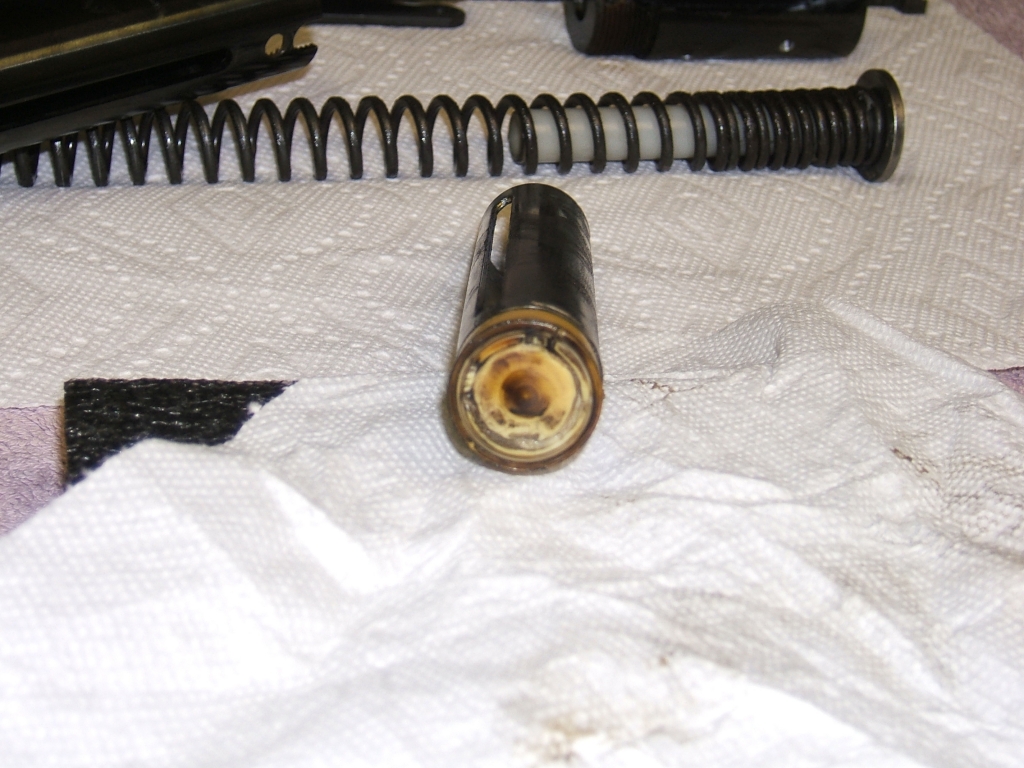

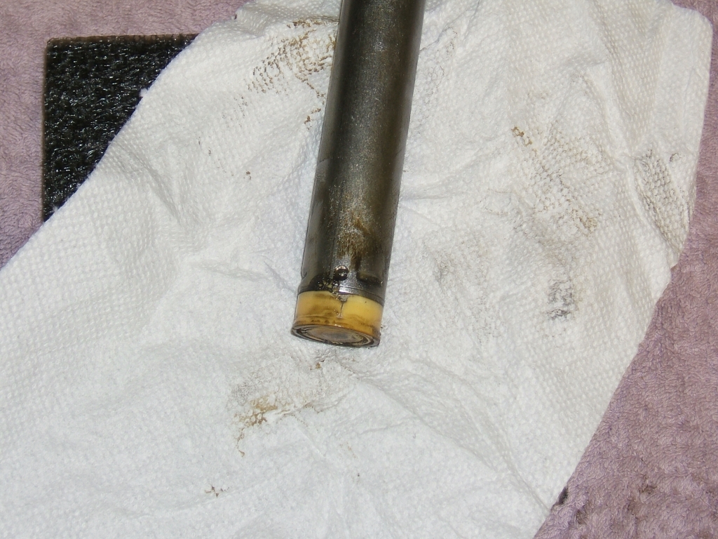

Gary, still dieseling once every five shots for a gun with a 1000 shots through it seems odd. Have you done any chamber living?
A blown piston seal will cause that. Take a look at mine!

I didn't notice mine dieseling, but by that time, I was so fed up with it I wouldn't have noticed it anyway. But considering the amount of grease on the face of my blown piston when I removed it from the compression chamber, it had to have been dieseling.
