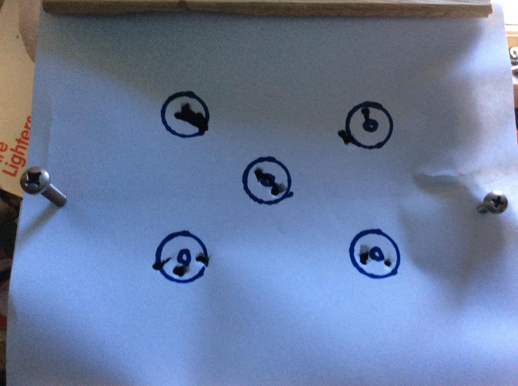

So this arvo I transferred the 2*7*30 from my Walther to the 30. I had to shim the front of the scope and the front side ring as it was shooting very high and to the right. The scope was mechanically centered before fitting. I know these are only 3 shot groups but there are 5 of them. Distance was 25 metres useing the Hunter Extremes. The one top right was my second last group. Two outside the ring so I don’t know what happened there.
At this point I’m on my 6th tin of pellets. I hope these JSB’s group better than the Extremes.
Gary

No shaving happening here Peter, the Extremes are a lightly less than a snug fit.
Thanks Christian and Wayne but I was looking to get tighter groups than these. I can achieve better groups at that distance with my 77 and LGV. Maybe I was having an off arvo, this happens a lot 😂 it was blowing at about 20 knots when I was shooting but I was protected somewhat.
