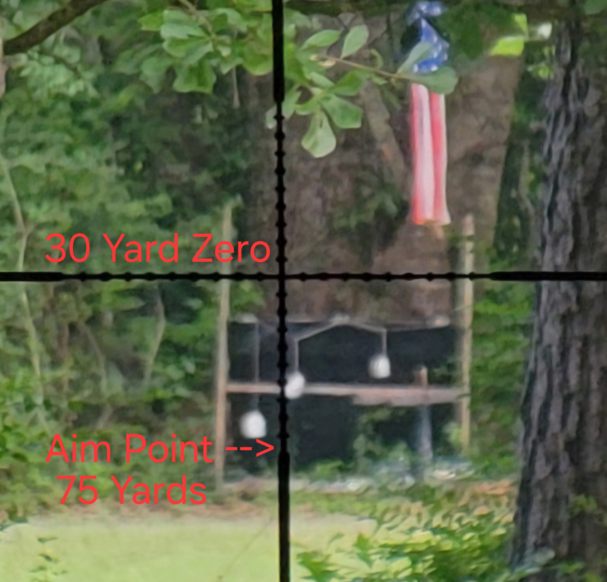

Mine is a .20 cal set for 30 yards. I shoot at 75 yards and use all of the mill dots down to where the post widens. I dialed the zoom to a little over 4X to make that happen. Lol
It's quite challenging, but I wouldn't do it if I couldn't hit with it.
Here's a look at it. Shooting JSB 13.73's
