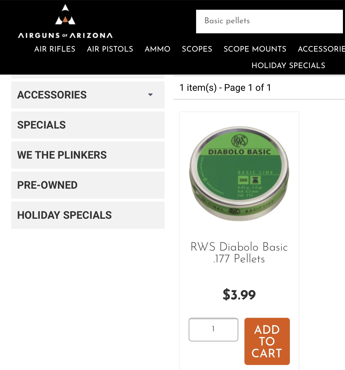

What distance was the league shooting Bear? A belated Merry Christmas to you btw.I shot in a league back in the 80’s and 90’s. Most common gun was the HW30. Most used pellets were RWS Basic. 7 grain, so on the light side of a lead pellet. Keeps the trajectory more flat. German made. Best part- Cheap. Save the money for a HW50 or 95.View attachment 316939
We shot a 10 meter league. Traveled to other houses for house competitions. Some longer FT shoots at other houses. The RWS Basic back then was called Geco. I bought them back then for $1 a tin of 500. Sold them to everyone for a about what they cost me with shipping. R10 and Meisterkuglen were about $5 a tin. They later renamed the Geco to Basic. The HW30 and most match rifles loves these. Happy Holidays to you and yours Ron. Good luck in your move.What distance was the league shooting Bear? A belated Merry Christmas to you btw.
