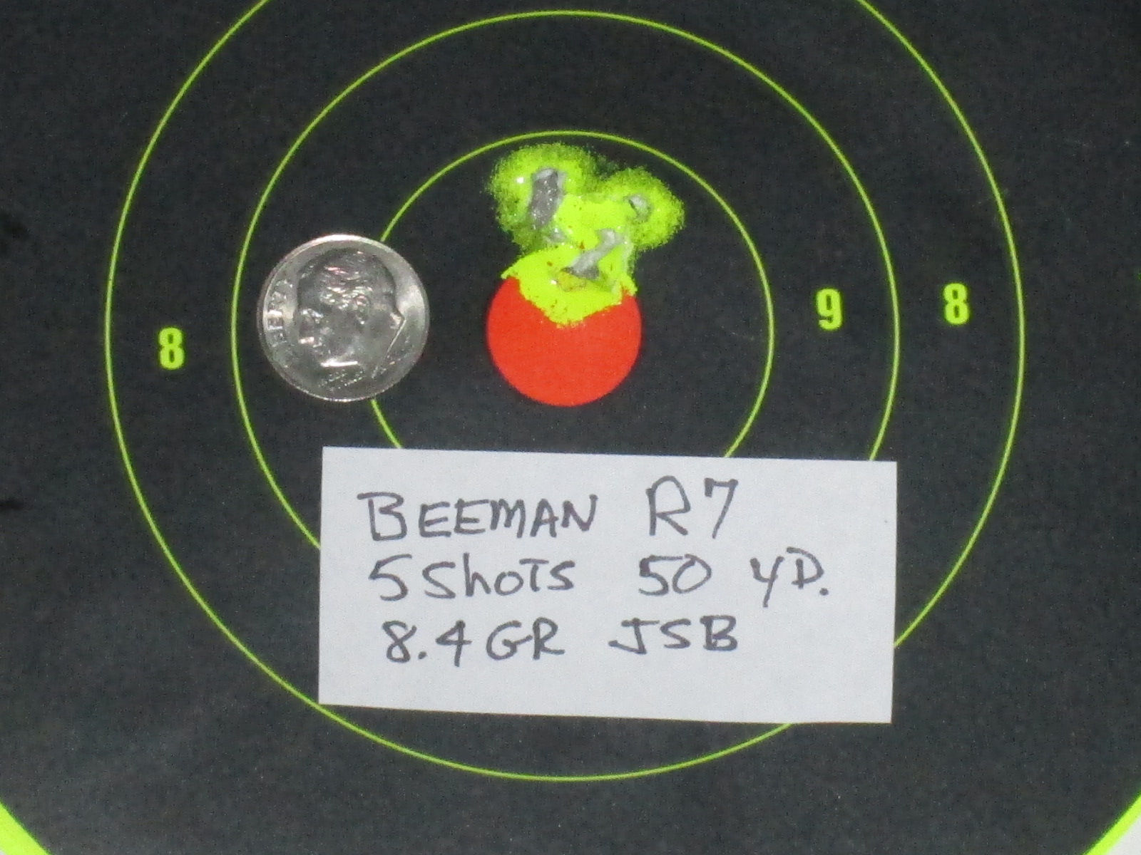

My entire purpose for my springers is precision shooting out to 50 meters. Incidentally, that is roughly the distance that pellets are still somewhat stable and manageable in the wind. My three Weihrauch springers fill this role superbly. My .177 HW97K is a precision tool at 14 fpe that is capable of hitting dimes at 50 meters...but it's heavy. My .177 HW50 S is also incredibly accurate at 11 fpe and it's quite a bit lighter than the HW97. I'm confident with it out to about 40 meters. My .177 HW30 is my baby. She's running at 7.5 fpe stock and is a guaranteed one hole group at 20 meters. Unless its windy she's the tool I pick for sub 30 meter work.
