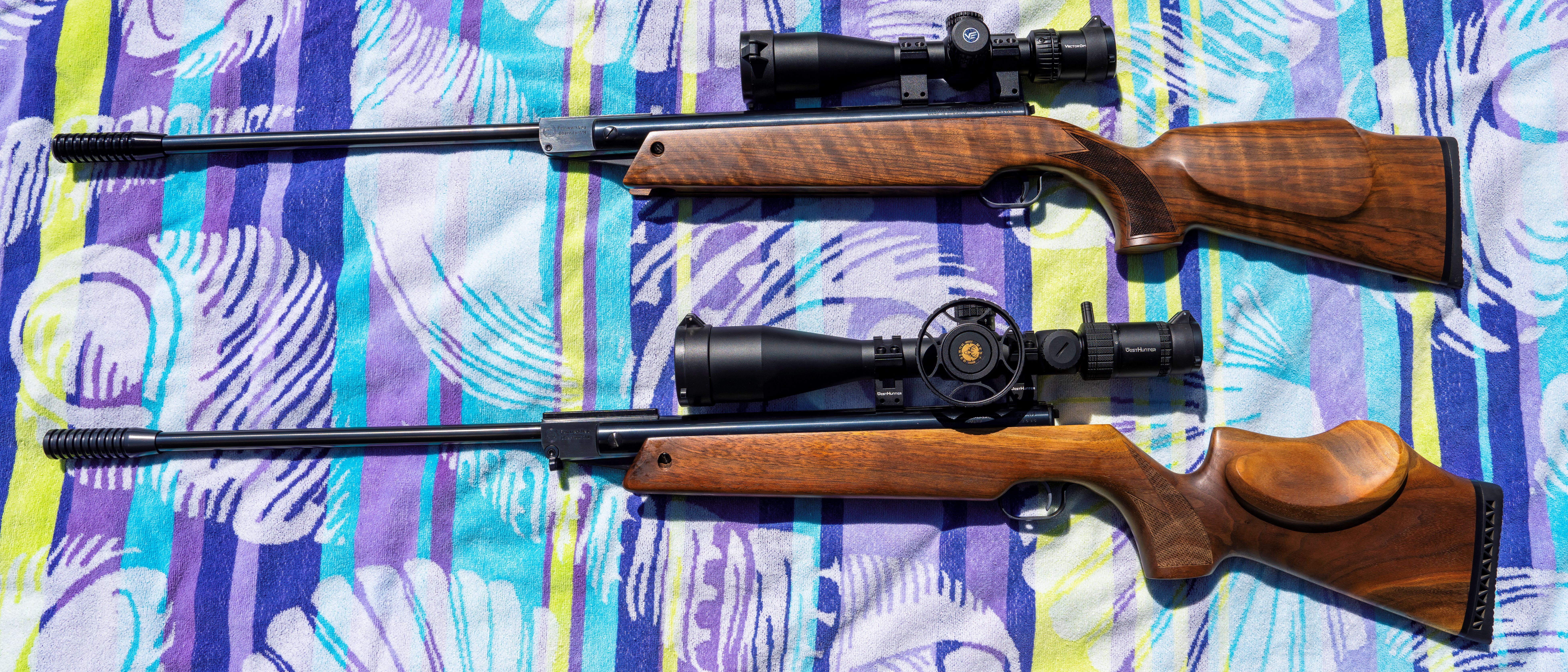

Nice pair of rifles ….and thanks for sharing them
MDriskill, ..... Boy the 1967 HW35E is making me drool.
Even though I own 3, noticed you can still get a new one from Krale for less than $450 shipped. I almost bought on yesterday; only about $50 more than in 2016. The Euro is down vs. the $$$.
I bought this 35E in January from Krale. A little over $400 to the door. Put a vintage diopter on it. Got it in 22 caliber. Hard to find a 22 caliber in the vintage ones. Would jump on a grooved model with the rounded pistol grip in any caliber. I really like the grooved model. They look more European to me. The new checkered version looks more American. I think both are very sharp with their Walnut stocks. IMHO, it is hard to beat the 35E for quality, value and style. They are truly one of the last of the Mohicans.
