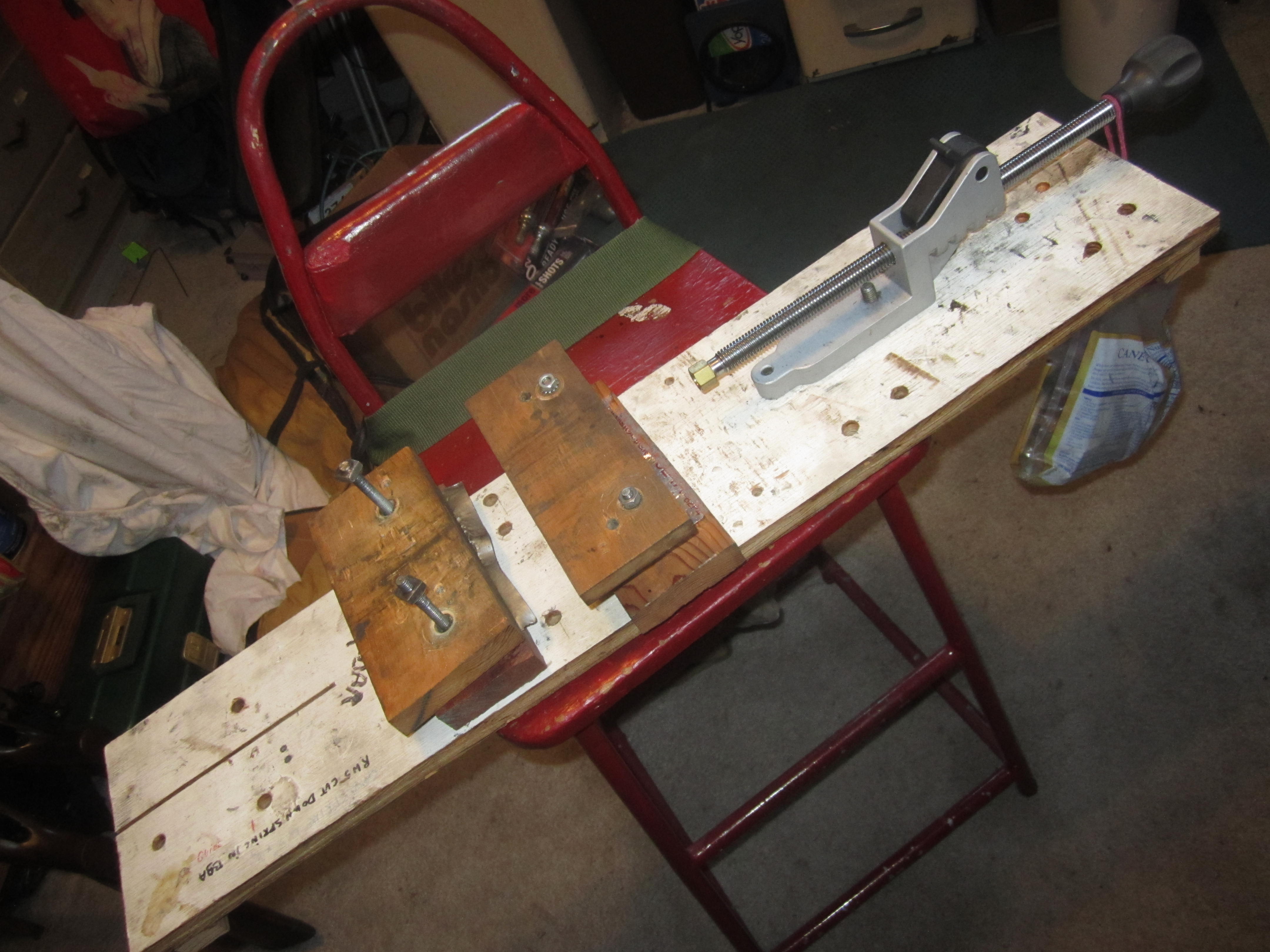

It depends on how close you are to getting the threads started on the end cap, as to whether it’s doable by hand. I had to build a spring compressor for my 97K when trying to install a hornet spring kit and it was sketchy at best, but I managed to get it in without killing myself. Since then I’ve switched to a shorter softer spring which is easily installed by hand and I spaced it up for a little more power, it shoots around 835fps which is right at 13ft lbs with a 8.44 pellet. So if you’re really close to getting the threads started, you could figure a way to hold the action so you can put your weight behind it to close that small gap and start the threads. Only you know what your limitations are so be careful.

On my break barrel I use this as my compressor. 14-20$ harbor freight or home Depot
